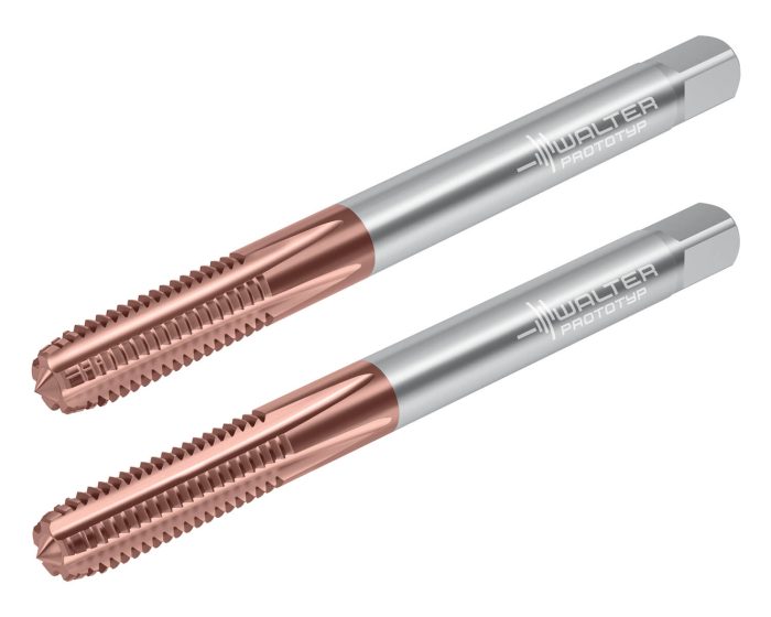

Greer, SC—Walter has introduced the TC388 and TC389 Supreme solid carbide taps, for solving key problems in threading hardened steel, in part because producing threads in hardened steel has traditionally been both costly and time consuming. This especially applies to blind hole machining in particular…because reversing the tap during this process can cause torque peaks when the root of the chip is sheared off, resulting in tool failures.
New Walter TC388 Supreme (50–58 RC) top and TC389 Supreme (55–65 RC) Supreme taps.
Walter solves this problem with the TC388 Supreme (50–58 RC) and TC389 Supreme (55–65 RC) with their new patent-pending cutting geometries that fully shear off the root of the chip when reversing, thus torque peaks are minimized. This prevents fractures, prolongs the tool life, and increases process reliability. Furthermore, the new taps are coated using Walters new HiPMS coating technology which creates a better surface finish, and higher thread form quality due to this innovative new coating process. Lubrication with oil, which was often necessary until now, is no longer required. Instead, standard water-based emulsions can be used, optimizing handling and saving additional machining costs. The TC388 and TC389 can be used for tapping both blind-hole and through-hole threads up to 2 × DN.
