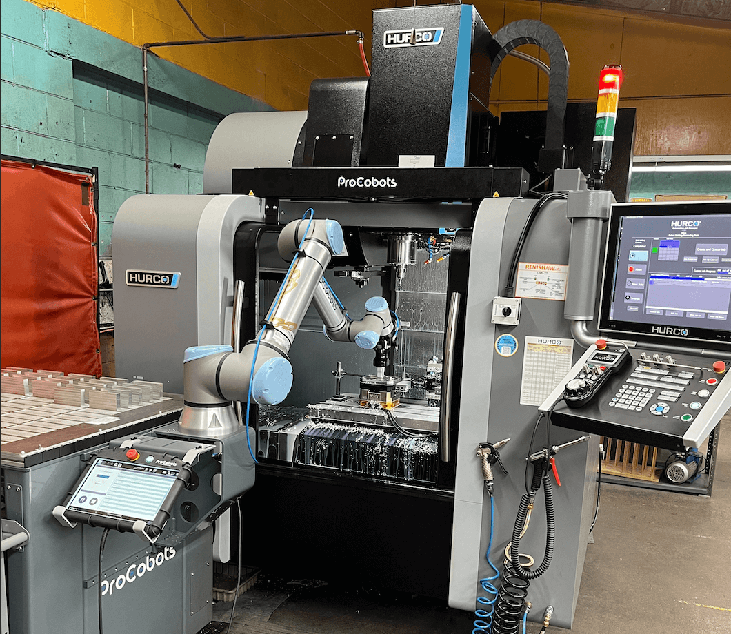

Vi-Cas’ ProCobots ProFeeder system retrieves a finished part from the Hurco machining center.
ProCobots automation is completely integrated with the Hurco control through Hurco’s Automation Job Manager software. This allows the user to manage the collaborative robot conversationally on the Hurco control, rather than having to learn robot programming. Simply put, if you can use a Hurco, you can use ProCobots automation. This key advantage gave Vi-Cas confidence they could quickly incorporate automation into their process and was a major factor in their decision to purchase the ProCobots ProFeeder system. The technology did not disappoint.

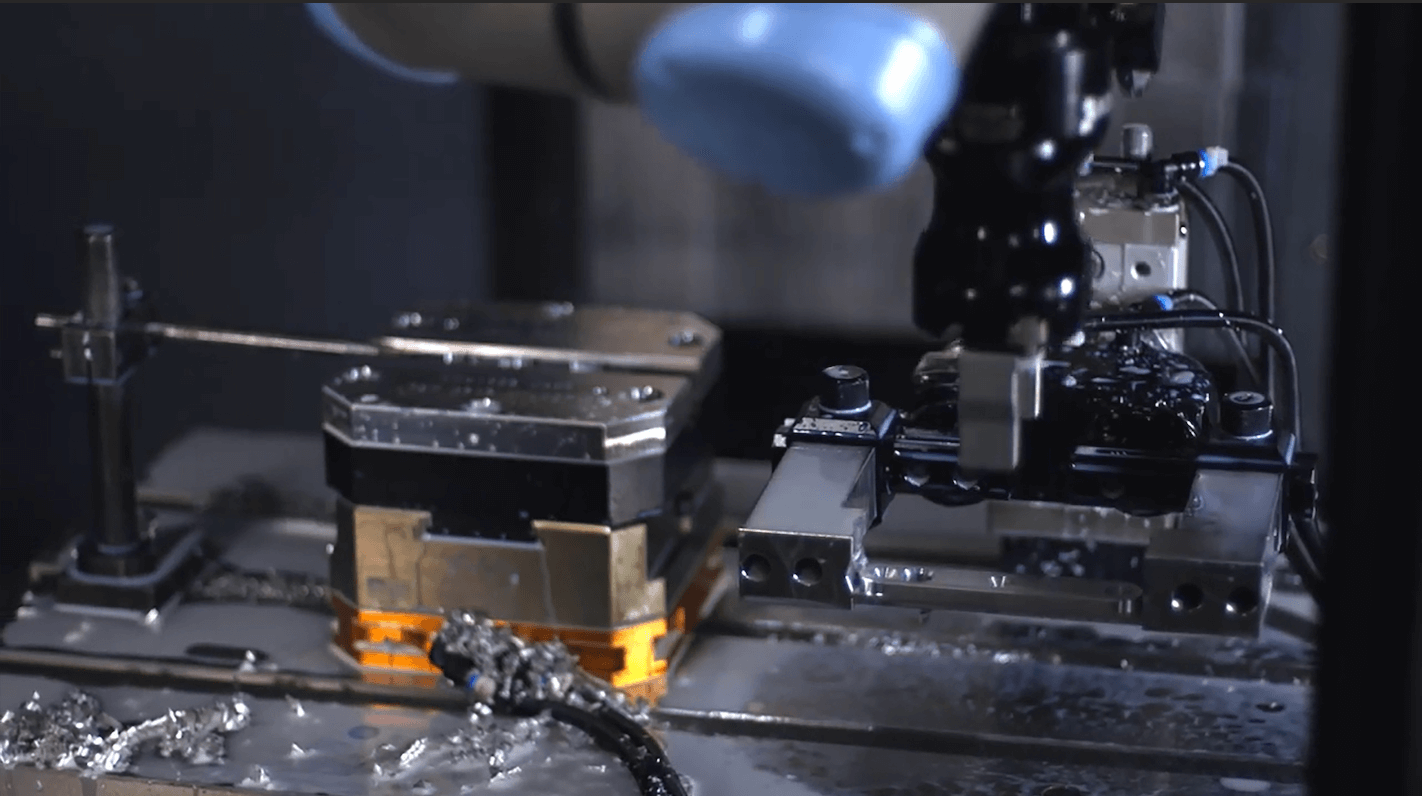

The ProCobots part flipper turns over a part so that its other side can be machined.
The part flipper is an optional accessory that allows for multiple-operation machining without machinist intervention. When it’s time for the next operation, the ProCobots’ automatic doors open, the robot picks up the part from the vice and places it in the flipper. The flipper then turns the part over, and the robot puts it back in the vice so the Hurco can cut the other side.

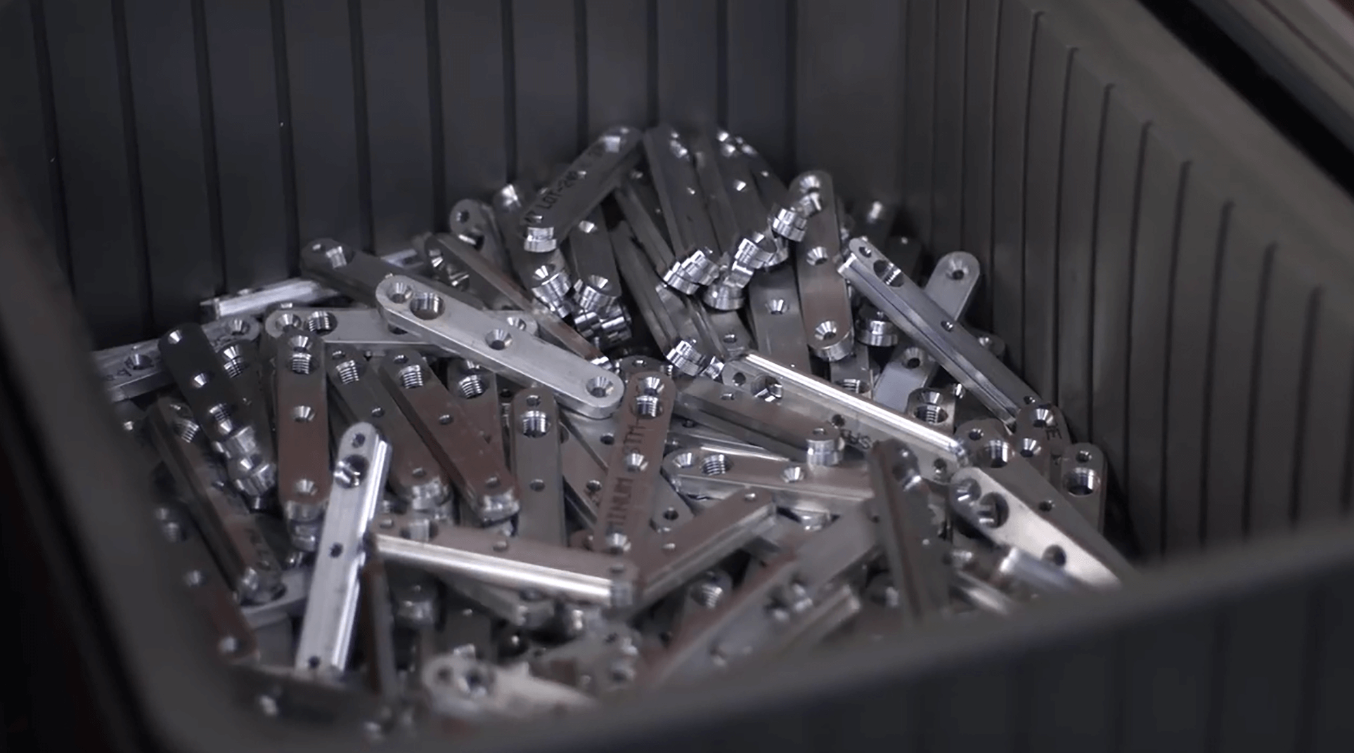

A batch of parts sit in a container following an automated job at Vi-Cas Mfg.
