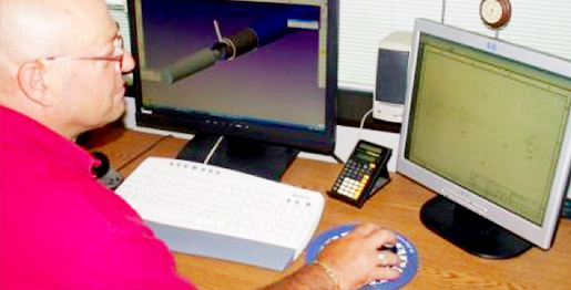

Mr. Schmidt says GibbsCAM MTM has all the Swiss functionality execute and verify all codes and machine modes easily and accurately. The software’s Sync Control is one feature he likes, because it automatically alerts the programmer when there is a conflict, such as attempting turning and milling motions simultaneously. “If I enter a machine mode that doesn’t belong, a dialog box pops up and tells me that sync codes for conflicting moves are not allowed. It’s a great safety feature.”
Mr. Schmidt added that, unlike the 5-axis mill programmers at Precise, he doesn’t use GibbsCAM machine simulation, because he has “not made the time to build the machine model for Machine Sim.” He does visual verification with Cut Part Rendering (Flash CPR), a standard feature he finds valuable. “What goes to the machine must be what I see on the screen,” he said. “I watch which tools are cutting where and when, and ensure there are no crashes. Everything goes through CPR. If there’s a gouge or collision, a red mark on the screen, it’s going to be on the part, so I rely on CPR a lot.”
He also uses the Analyze Cut Part feature, which compares finished machining against the part model, showing discrepancies, such as unmachined features or machined material that should not have been removed.
GibbsCAM Operations Summary also improves productivity for Precise, computing and displaying actual cycle times. “It does not account for non-cutting motion,” says Mr. Schmidt, “But it doesn’t matter, because with the Citizen, there’s no indexing. We just move from tool to tool, and it’s pretty fast,” he explained. “The Operations Summary is really accurate. I use it after Cut Part Rendering to ensure that my cycle times are within budget, and we use it for estimating jobs.”
