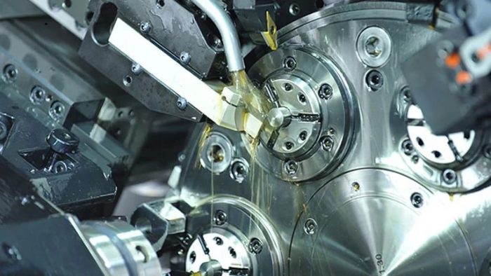

An Index MS lathe simultaneously machines on six independent part spindles (three visible here). The spindles rotate in a drum so each station attacks the part in turn, producing complex forms in seconds. (Provided by Index Corp.)

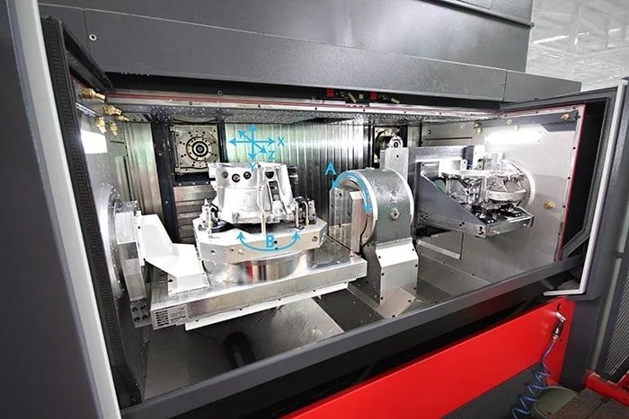

After all, the simple addition of a sub-spindle provides the ability to machine all six sides of the part without handling it. (The sub-spindle grabs the part before cut-off and holds it for subsequent machining.) And if the parts require cross-drilling or other non-turning complexities, the argument for the newer multi-function lathes becomes compelling.
As Judt put it: “My twin-spindle machines costs a lot less than two or three or four single-spindle machines and a vertical machining center.” It is not an unfair comparison because the LICO twin-spindle to which he refers doesn’t just have a sub-spindle that holds the part to machine the “other end.” It also features three or four independently programmable cross-slides mounted around the main spindle and a turret with live tools for side drilling and milling.

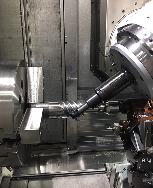

“You can have five independently engaged tools while the part is being held in the main spindle and then cut it off and move it to the sub-spindle and then engage one tool at a time,” explained Judt. That makes fast work out of complex parts.
Okuma’s MULTUS has a true milling spindle on an articulating B-axis for full five-axis machining. A turret station can be used as a tailstock, as shown here. (Provided by Okuma America Corp.)

Index offers a unique alternative for high-volume parts: MS series turning machines with six or eight (depending on model) independent Z-axis part spindles in a rotating drum, plus one or two counter-spindles, which in this context they call “synchron spindles.” A torque motor rotates the spindle drum from position to position in 0.4 seconds (every 60° on a six-spindle and every 45° on an eight-spindle), where it’s locked precisely into place by a Hirth coupling. Two independent X-axis cross slides serve each spindle, each with either fixed or live tooling.
In general, a shop would perform the same operation in each spindle position and move the spindle to the next tool set for another operation, and so on, until the front side is complete. Then, the synchron spindle would grab the part, a tool in that spindle position would cut it off, and the machine would then do the end work.
In most configurations the synchron spindles can swivel, providing the ability to apply up to six tools to the back side of the part. There’s also an option to add a pivoting Y-axis to the X-axis/Z-axis cross-slides. The control can interpolate this motion along with the spindle’s rotation (C-axis) and the linear motion of X to produce a linear Y move to machine flats and other features.

Engel explained that balancing the amount of work for each spindle position is a key consideration for maximizing throughput. “If one spindle position takes 30 seconds and all the other spindle positions take three seconds, the cycle time for that part is 30 seconds. The goal is to have the same cycle time for each spindle position. That’s only theoretically achievable, but we often get within a few percent.”
In fact, average total cycle times for complex parts in this setup range from just 3.5 to 40 seconds. For relatively simple parts, the machines with two synchron spindles can double the output as follows: Do the first operation on parts 1 and 2 in spindle positions 1 and 2, then the second operation in spindle positions 3 and 4, and so on. Conversely, if the part is too complex to be completed on one machine, it is common to bar feed the first machine and then robot load the partially finished parts coming off that machine into the second machine. Although changeover time on any of these configurations is quite short, given their cost the business case depends on the need for high production rates.

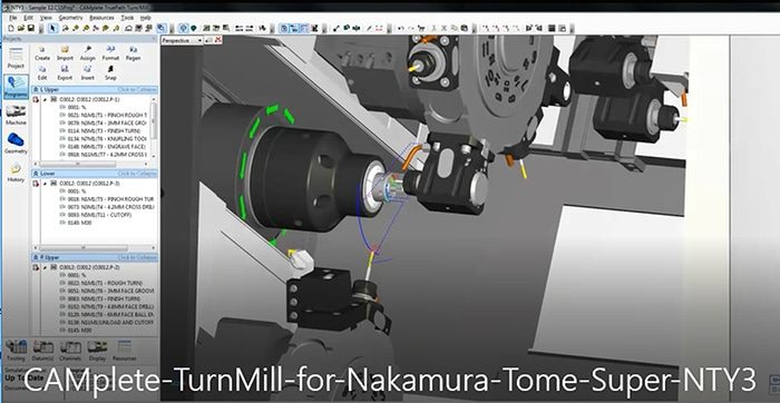

CAD/CAM can also be helpful in picking the right machine configuration, said Sergio Tondato, product manager for the Nakamura-Tome line from Methods Machine Tools Inc., Sudbury, Mass. “We routinely simulate running a part on different machines and compare cycle times. For example, what is the part output on a twin spindle, single turret? A twin turret? A three turret? And so forth. The required part volume and considerations like whether or not it’s a family of similar parts helps select the best machine.”
However, Tondato said the post-processor in most CAM packages isn’t that accurate with regard to cycle times, so Methods partners with CAMplete in this area. Besides accurate cycle time verification, CAMplete software also performs collision checks and makes it easy to change tool configurations. Methods is so keen on the benefits that it includes CAMplete TurnMill with all its Nakamura-Tome multi-turret lathes, an arrangement exclusive to Methods. CAMplete just launched TurnMill V9 that comes with 3D view enhancements, simulation improvements, and revamped post processing support.

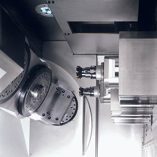

The resistance to multi-spindle machining centers stems at least in part from concerns about setup and the fact that having more spindles will naturally apply more force against the worktable and fixtures than traditional machining. The latter is addressed by clever machine construction and Campbell said the supposed setup difficulty is “more of a perceived issue than a real issue. And even if it takes a little time to do, by the time the machines are running they are out-producing what would be made on a single-spindle.”
In most cases, these multi-spindle mills are using all the spindles to perform the same operation on multiple parts simultaneously. Likewise, Paulet explained, “the spindles are usually mounted on the same carriage, with one independent axis, which is usually Z. But how to process two very precise parts with such a machine if it is not possible to enter fine compensation on both sides?”
For PCI the answer was making each spindle independent in X, Y, and Z. This enabled fine compensation and high accuracy on each spindle, plus the ability of each spindle to simultaneously machine different areas on the same part. Examples of applying twin-spindles to the same part include machining the right and left side of large chassis parts, like knuckles, and machining a large battery tray, which Paulet said resulted in a nearly 40 percent reduction in cycle time compared to a single-spindle solution.
It’s even possible to machine completely different parts simultaneously with PCI’s “two machines in one” concept. Paulet said customers are starting to move toward this innovative solution and PCI has already sold a line of twin-spindle machines where a gearbox housing is made on one spindle while the other spindle machines the clutch housing.

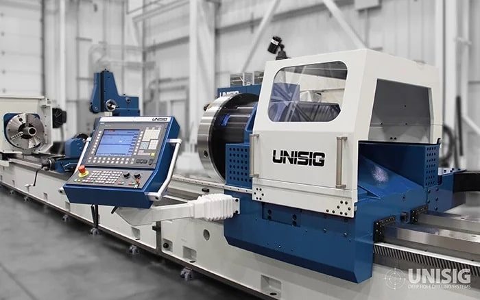

No matter how capable a lathe or machining center, drilling deep holes can be extremely challenging, so challenging that UNISIG, Menomonee Falls, Wis., has a solid business building machines specifically for this application. CEO Anthony Fettig said most of his company’s business is in machines that drill holes with a length-to-diameter ratio between 20:1 and 200:1, but they can be the right fit for smaller ratios too if tolerances for bore diameter, straightness, and surface finish are tight.
Another factor, as Fettig put it, is “tolerance for frustration. When gundrilling on a machining center, it is common to break drills, or cut oversized holes, or they drift quite badly, and you don’t really know why. So process reliability and the required quality of the bore drive some people to deephole drilling. Our machines are dedicated to the deephole drilling process and will generally make a much higher quality hole. And they will do it every single time, thousands of times in a row. The machine will step in if something starts to go wrong with the process.”
UNISIG accomplishes this with a combination of specialized machine configurations, specialized tooling, and, of course, applications know-how. A key technique for larger diameter bores (20-200 mm) uses BTA tooling. (BTA is an acronym for the Boring and Trepanning Association.) With BTA tooling, the machine blasts high-pressure coolant around the outside of the tool and the chips flow through the tool center and back through the drill tube and machine spindle. The approach is five to seven times faster than gundrilling, but requires higher power.
