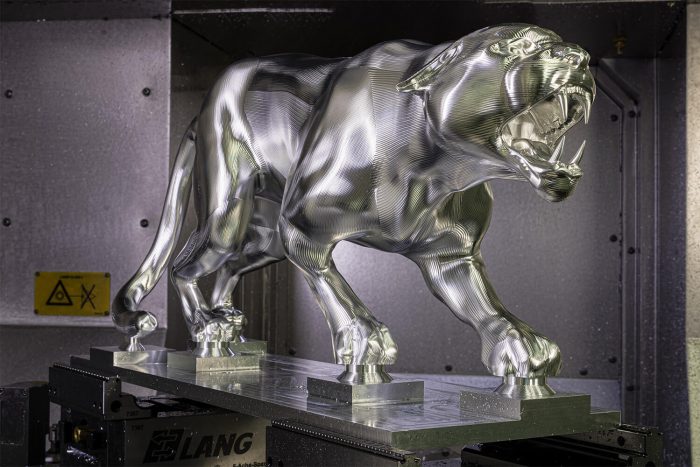

It took the HAIMER and OPEN MIND team approximately three intensive weeks to complete the first free-standing panther. Once the machining parameters were in place and optimized, the approximately 20″ (500 mm) long panther was machined in just under 13 hours. In addition to being proudly showcased by the Augsburger Panther hockey team, the panther model will be on display in HAIMER and OPEN MIND trade show booths at future events.

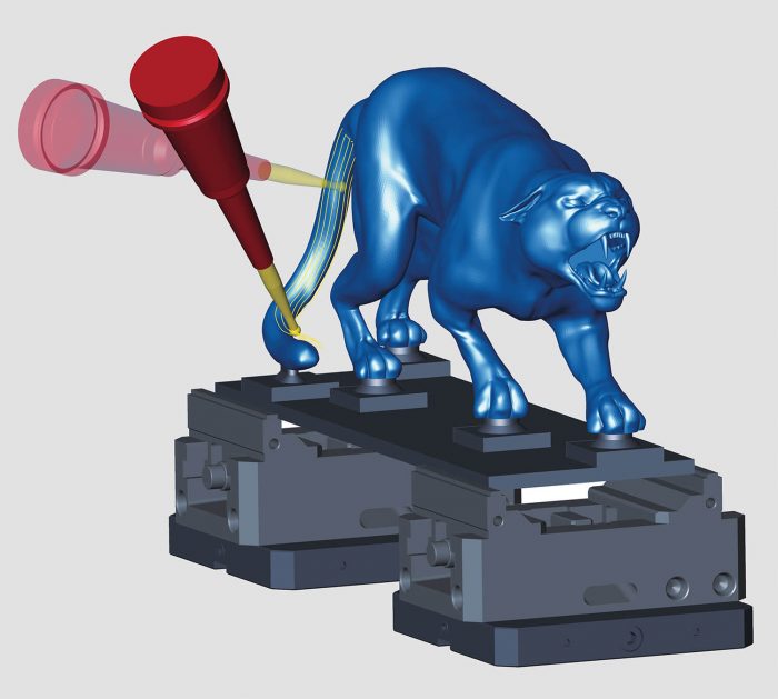

Jakob Nordmann, Application Engineer at OPEN MIND worked with HAIMER Applications Engineer Daniel Swoboda to develop the ideal programming and machining infrastructure. Due to the extremely detailed mouth and incisors, and the long and thin shape of the filigree tail section, two set-ups were required on a linear 5-axis DMG MORI HSC70 machining center. A four-flute cutter with a corner radius from the Duo-Lock™ HAIMER MILL Alu series was selected for the roughing, and tor the finishing process, the full radius version of the solid carbide end mill from the HAIMER MILL Alu series was used because of its micro-geometrical properties, which are designed for smoothness and top surface quality.
“For especially detailed areas, such as the mouth and tail section or with the creases of the joints, we generated additional surfaces that can be combined with the STL network in hyperMILL®, said Nordmann. For this, hyperCAD®-S, the ‘CAD for CAM’ system specially designed by OPEN MIND to help meet all the needs of programmers, was used.
Equally imperative for milling the panther was the hyperMILL® VIRTUAL Machining Center, a process-safe NC simulation solution where virtual machine movements fully mimic real movements and ensure reliable collision detection. The VIRTUAL Machining Center pre-emptively recognized that the component could not be processed in a basic orientation due to X-axis limited and automatically generated a solution for a workable position.
