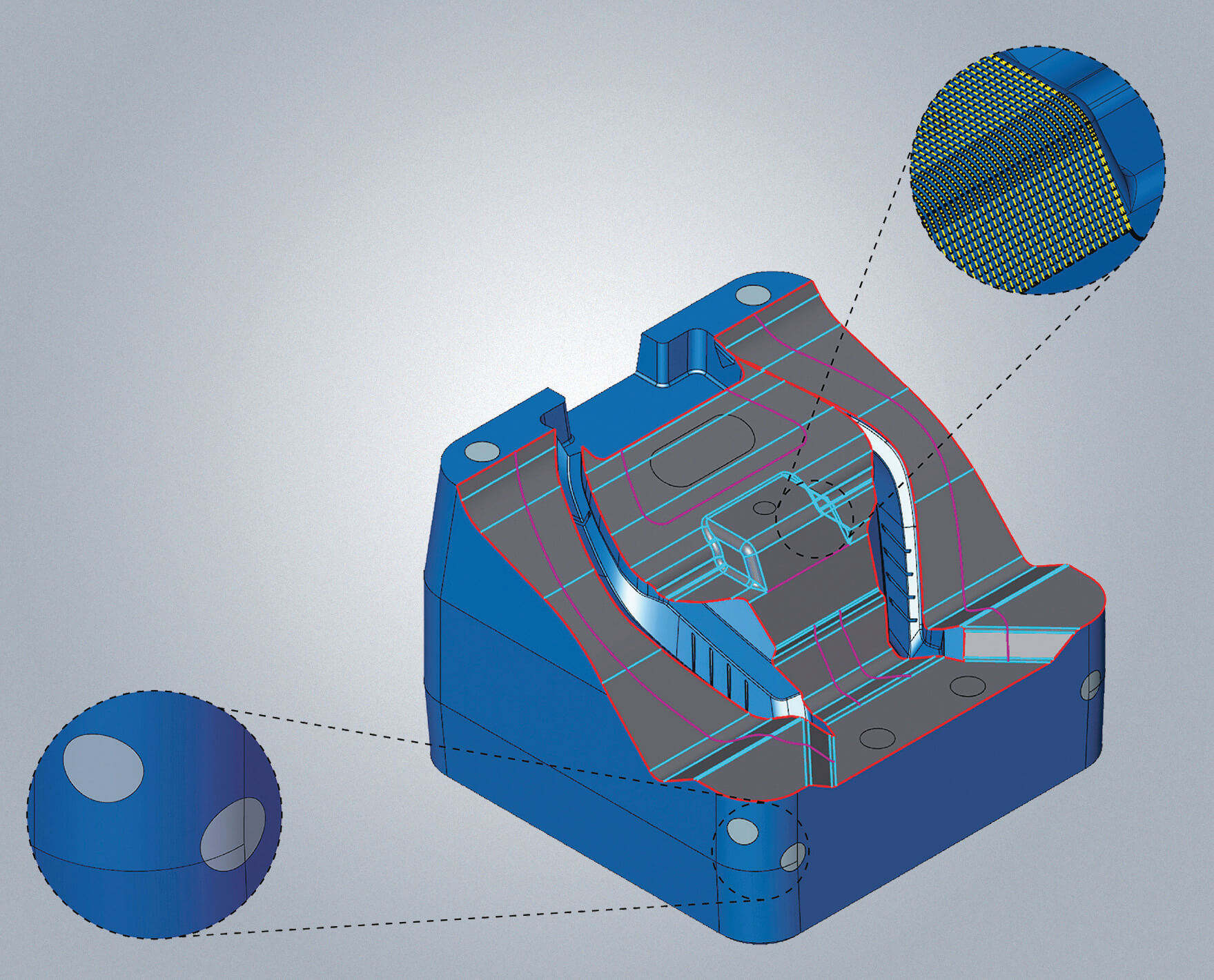

In 3-axis and 5-axis machining (image), new algorithms for rest material detection ensure that all rest material areas are automatically accounted for in full.

A new algorithm for 3-axis and 5-axis Rest Machining ensures automatic, complete detection of all rest material areas, in addition to optimized toolpath calculations for faster, reliable machining. Toolpaths are now optimally divided to ensure more efficient machining, and the detection of intersection areas where paths meet has been optimized for collision avoidance.

hyperMILL® “CAM Plan” calculates the optimum point distribution based on part topology data. hyperMILL® “CAM Plan” automatically creates cover surfaces for holes.
A new, novel generation of programming assistance and analysis, “CAM Plan” is introduced in hyperMILL® 2024, simplifying various programming tasks and identifying possible sources of error. Predefined workflow steps safely guide users through the preparation and programming process, while the geometries and features required are automatically created. Also, potential errors are flagged for removal such as double surfaces or gaps between model patches.
Once the data is organized, the CAM workflow can be processed with more intelligence and higher efficiency. The first benefit from hyperMILL® CAM Plan is that component topology is analyzed to produce a precise toolpath that has command locations aligned with key geometric features and with optimized point distribution for milling. The result is improved surface finishes, easier processing by NC controllers, and reduced machining times.

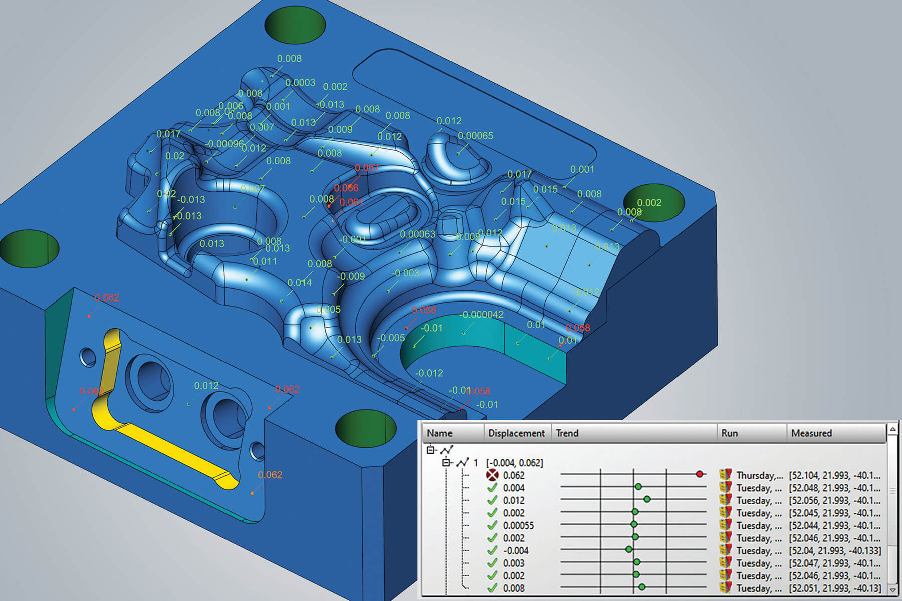

Measuring points read back for improved quality and process control. The 3D model of the component shows at a glance which measuring points are outside the tolerance.

The reading back of measuring points when using hyperMILL® VIRTUAL Machining is a new feature that allows graphical representation of measured points on the part model, rather than comparing a list of measurement results. Users can also quickly identify measuring points that are out of tolerance on a 3D part model and compare trends over sequential measurements. As a result, it is much easier to analyze and compensate for inaccuracies and tool wear after milling.
