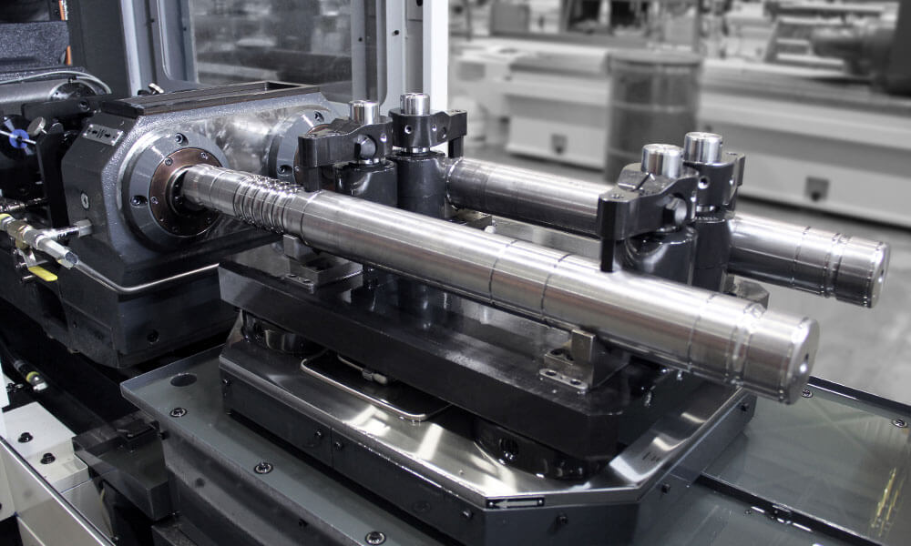

One of Weisser’s customers manufactures polygonal cams in less than a minute in one setup and four turning passes, including face machining and chamfering operations. At 1,500 rpm, the out-of-round turning unit generates a feed rate of 0.1 mm per rotation and a cutting depth of 0.8 to 2 mm. The parts are finished with an accuracy of 10 microns.
Another customer that has gone a step further than many international competitors has already integrated a polygon coupling into a newly developed gearbox, using Weisser’s HOT technology. “The customer replaced the spline shaft with a polygon shaft in the seventh gear, which reduced the shaft length from 20 to 12 mm since the polygon has a greater capacity for torque than any other shaft attachment, so a shorter shaft connection can be used and valuable space saved,” Mr. Jörg explains. All in all, 6 mm of space savings helped optimize the transmission ratio of the first gear, which encountered fatigue problems with the original design.

Weisser HOT Turning on a Vertor C
Weisser’s Hyperspeed Oval Turning (HOT) “out-of-round” machining unit enables hard and soft machining of reciprocating pistons for combustion engines made of aluminum and steel, hardened camshafts, polygonal profiles or shapes, and automotive fuel pumps, among other applications.
Polygon shafts are designed to eliminate common failure problems associated with splines Polygon shafts are designed to eliminate common failure problems associated with splines
Polygon shafts are designed to eliminate common failure problems associated with splines and keyed shaft attachments. The polygon has a greater capacity for torque than any other shaft attachment. The force transmission and load ratings are optimized and a shorter shaft connection can often be used to save space.
