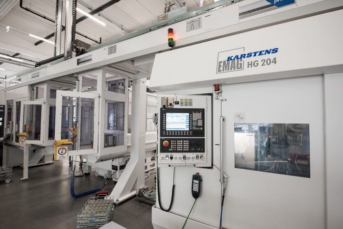

Pankl’s technology partner in the “turning” application area is EMAG, with a total of 15 turning machines and one grinding machine from EMAG being installed in the new plant. These include three complete production lines, each with three VL 100 machines for the soft machining of gears, two connected VL 200 machines for the hard machining of gears, two VTC 100-4 units for the soft machining of shafts, and an additional production line for the hard machining of shafts that includes the VTC 100-4 turning center and the HG 204 horizontal grinding machine. Last but not least, there are two more VL 100 pick-up turning centers that are used as standalone machines, for tasks such as the manufacturing of prototypes. With such a high volume of orders, the question naturally arises, how did the company decide on EMAG as its primary partner for turning? “I should start by explaining that although we’d been developing and producing complex mechanical systems for high-technology industries such as auto racing and aerospace for many years, we hadn’t previously had any mass production of transmissions,” said Stefan Zinner, technical director of transmission manufacturing at Pankl. “So we were looking for a partner who could assist us right from the start, advise us about the turning processes required, and finally provide us with complete systems. In that sense, EMAG is an obvious machine supplier who has a very good reputation especially in the area of turning.”

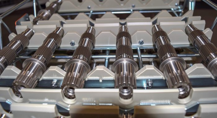

To understand the requirements that are important in choosing a machinery manufacturer, it helps to look at the lines installed for the soft machining of the drive input and output shafts, which handles eleven different models of each. Pankl opted here for a process that is both demanding and perfectly synchronized, with a stacking cell, two EMAG machines, a pick-and-place unit, and a gantry robot. The slugs and blanks are transported by gantry loader to the O-belt of the first VTC 100-4. This vertical turning center has two workpiece grippers that can each pick up a part and put down a finished one, in parallel to the machining operation. This reduces non-productive time when turning the first side. Additionally, a four-axis turning operation is used to minimize machining time. Once that operation is completed, a pick-and-place unit picks up the parts and turns them over for equally rapid turning of the second side in the second VTC 100-4. The gantry robot then conveys the part to a laser marking system. The writing and data matrix applied to the part ensure that every shaft is traceable. The production process then continues with gear teeth cutting, case hardening, truing, and hard machining—with the latter again involving EMAG technology. The machines used here are another VTC 100-4 for hard turning of recesses and shoulders, and the HG 204 horizontal grinding machine for plunge grinding along the entire shaft. Michael Mogg, team leader for machine turning at Pankl, summed up the situation: “The lot sizes in our shaft production vary considerably between 800 and 5,000 units. So it’s important to us that all processes, including re-tooling, go smoothly and quickly. We make sure of that with these flexible production systems.”
The lot sizes in Pankl’s shaft production vary between 800 and 5000 units.

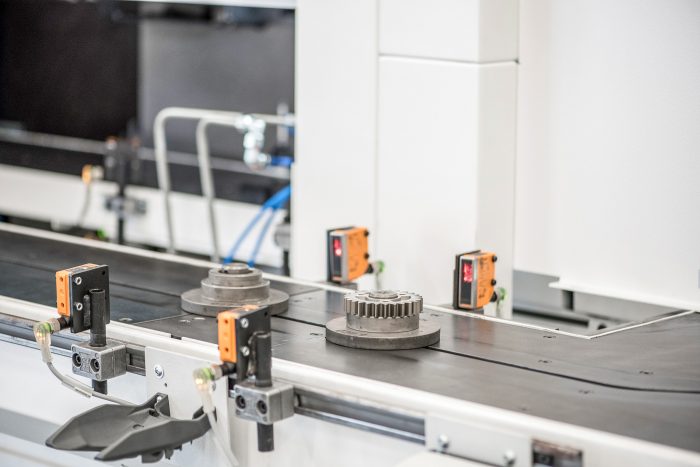

A similarly perfect solution was achieved in the production system for the soft machining of a total of 110 different idler and sliding gears for various motorcycle transmissions. The three production lines, each with three EMAG pick-up machines of the VL 100, rapidly carry out rough-machining of the first side (OP10), rough-machining and finish-machining of the second side (OP20), and finish-machining of the first side (OP30). Once again, a gantry loader provides the link between the machines. An interesting additional feature here is an image processing system, which guarantees that the part has the correct radial alignment before being clamped. The workpiece carriers used were developed specifically by Pankl. They ensure rapid and flexible loading of the machines with a wide range of parts—lot sizes between 800 and 2,500 units are typical for the company’s gear production.
The custom-fit workpiece carriers for the gearwheels were developed specifically by Pankl.
