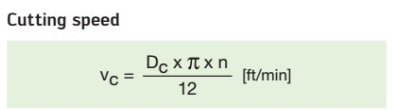

Because the tool must go deep into the cut all the way to the center of the workpiece, parting off operations present some unique challenges. First and foremost, is the problem with zero cutting speed.
Vc= cutting speed in surface feet/minute (SFM)
Dc= workpiece diameter in inches
n= revolutions/minute (RPM)
As the parting off insert radially goes towards the center, the Dc of the workpiece reduces, and the required RPM linearly increases to maintain the same cutting speed (SFM). Regardless of the capabilities of the spindle, at some point the spindle RPM cannot keep up with the requirement to maintain a constant cutting speed in SFM. As the insert goes closer to the center of the workpiece, the machine RPM maxes out and cutting speed starts reducing. At the center of the workpiece, the cutting speed is zero SFM. Cutting metal at zero -or nearly zero- cutting speed means that the insert must push the material without shearing it. This requires the insert grade to be very tough; that is why typically PVD (physical vapor deposition) grades are better suited for cutoff applications. CVD (chemical vapor deposition) grades are also available for cutoff and they usually tend to have very tough substrate for the inserts.

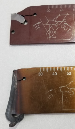

The second challenge for parting off operations is chip evacuation. If the chips are not evacuated efficiently, the chips get re-cut and eventually the operation stalls, with chips plugging the groove. Usually this leads to insert failure as well as severe damage to the cutting tool. Many times, the tool gets ‘friction welded’ to the workpiece.
Example of a misapplied tool, severely damaged after catastrophic insert failure

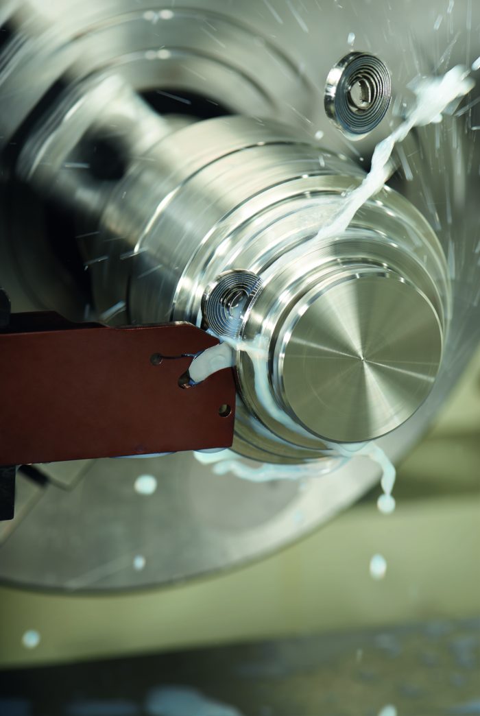

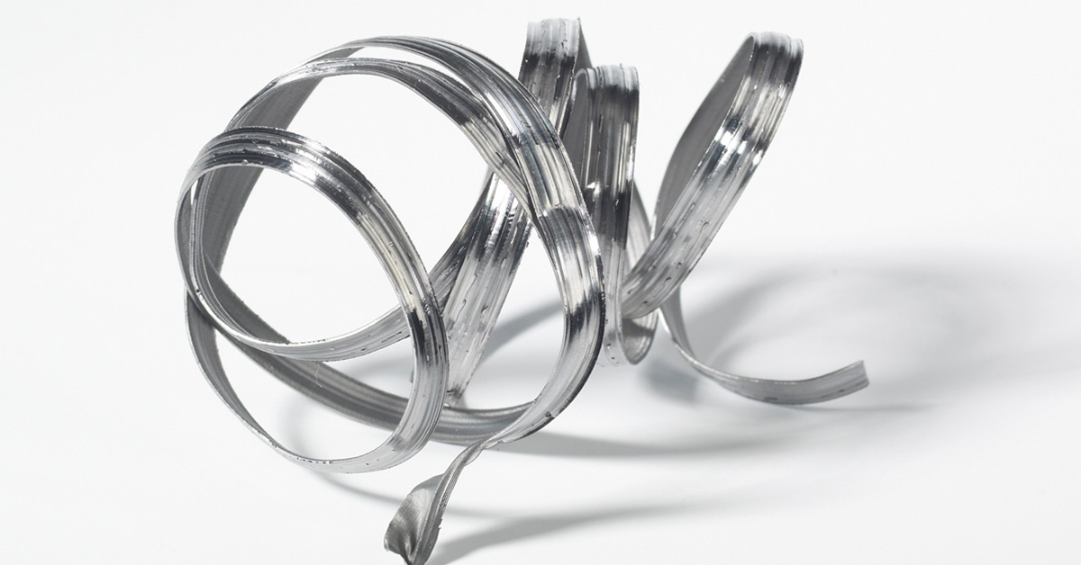

The third challenge with parting off operation is efficient chip curling. If the chips are not folded lengthwise into nice ‘clock springs’, they are hard to evacuate; leading to a groove plugged with chips, insert failure and a stalled spindle.
Best chips in parting off operations are the ‘clock springs’ that come out clean without damaging the finished surface.

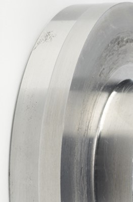

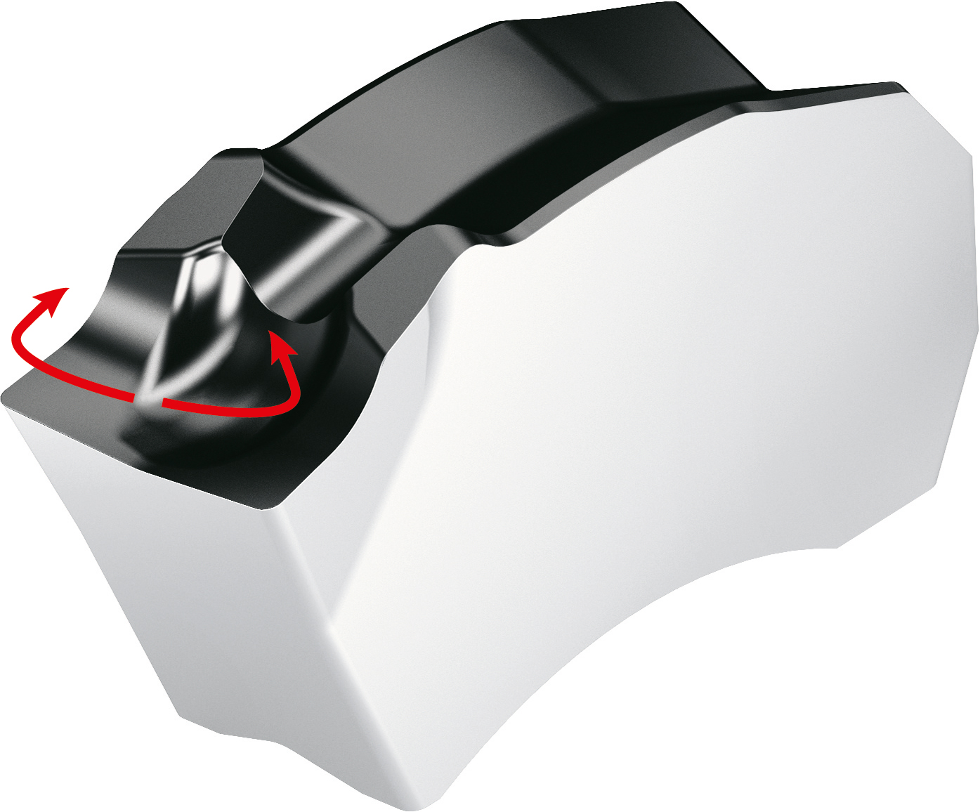

A good cut off insert also needs to be able to efficiently contract or ‘fold’ the chips sideways. If the chips engage on the side of the finished wall, they leave witness marks on the finished surface leading to scrapped parts. Here is an example of good cutoff geometry that shows ideal chip contraction.
