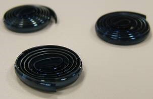

When an inclined cutting edge is used for the parting off operation, the lead angle or inclination angle is detrimental to chip formation. The chip always rolls of at 90O to the cutting edge. So, if the cutting edge is inclined, the chip is formed in a helical shape rather than a nicely wound clock spring shape which is formed by a neutral cutting edge that we discussed in part three of this five post series.
Pictures below show the examples of chips formed by neutral edge as well as an inclined edge.

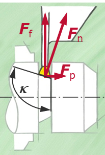

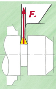

Another application to consider when using inclined cutting edge is the tendency of the tool to ‘walk’ or run off-center with the feed force. With a neutral insert, the feed forces Ff are in the direction of the feed.
With an incline cutting edge, there is an additional component of force Fp involved that tends to induce vibrations in the parting off operation as well as pushes the cutting edge away from the 90O shoulder. This leads to creation of a ‘dished face’. Thus, feed should be reduced by approximately 30% (or more) to reduce the vibrations.

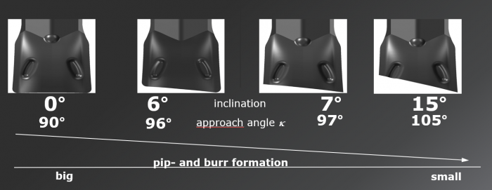

It is important to note that the benefits and adverse effects both increase as the inclination angle increases. So, a neutral cutting edge will have the largest burr, but the least tendency to ‘walk’, because the additional component of force (Fp) is missing. As the inclination angle increases, the burr formation reduces, but the tendency to ‘walk’ increases steadily. So, additional care should be exercised when using inserts with aggressive inclination angles. Below are the typical inclination angles seen in the market and corresponding effect on burr or pip formation.

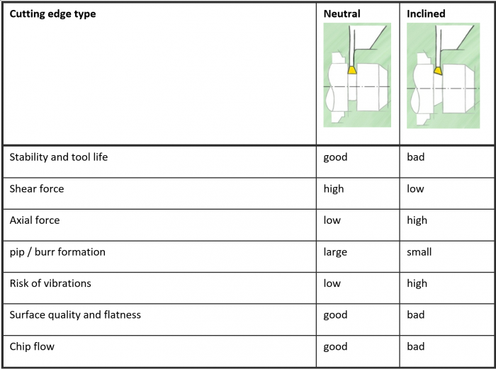

From all of the above discussion, it is clear the inclined or handed inserts should be used only to trouble shoot in certain applications. Below is the summary of applications considerations between neutral and inclined cutting edges.
