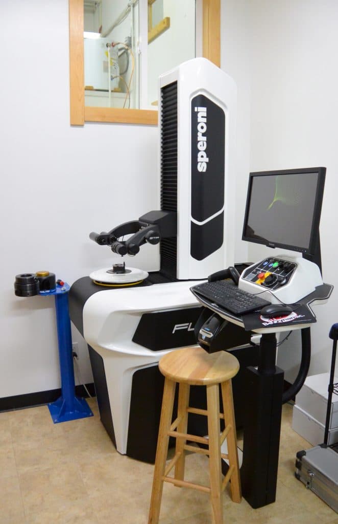

The Petersons and their team decided on a Speroni FUTURA STP 66 from BIG Kaiser Precision Tooling Inc., Hoffman Estates, Illinois. “Everybody at BIG Kaiser knew what they were doing,” said Steve Carper, lead machinist at Peterson Machining. “Since this was a new technology for us, we really wanted to be able to have that support to get started.”

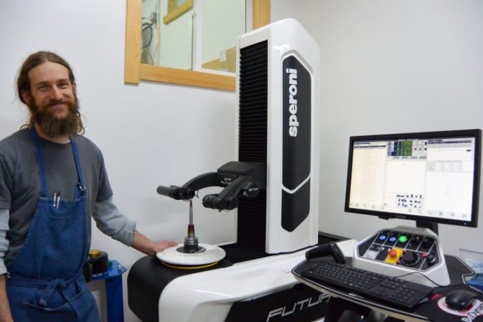

Carper added that he noticed discrepancies of a couple of tenths from one day to the next with some in-machine lasers, and that concern—and extra time adjusting at the spindle—has been eliminated since the addition of the presetter.
Steve Carper, lead machinist at Peterson Machining. He said that before the installation of the presetter he noticed discrepancies of a couple of tenths from one day to the next with some in-machine lasers. That concern has been eliminated withthe addition of the FUTURA.

The FUTURA is built with Heidenhain scales, Schneeberger guideways, and a rotating spindle that offers 1 μm concentricity and TIR at 300 mm of less than 5 μm. Setups have become so accurate and reliable that Carper has been able to set tools and use them throughout the shop, in different machines and operations. This is especially useful in a lot of the aluminum work that Peterson Machining does, since it imposes less wear on the cutters.

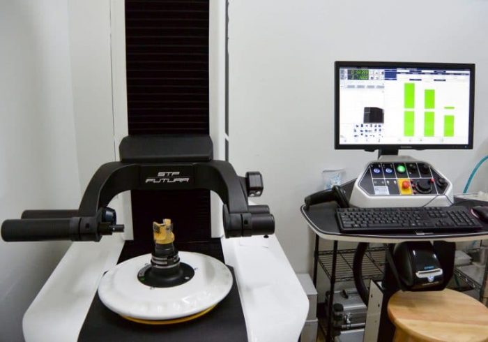

The FUTURA’s two-camera, high-frequency, sub-pixel, 45X standard optical magnification capability has been a major help in presetting the micro tools used by Peterson Machining.
