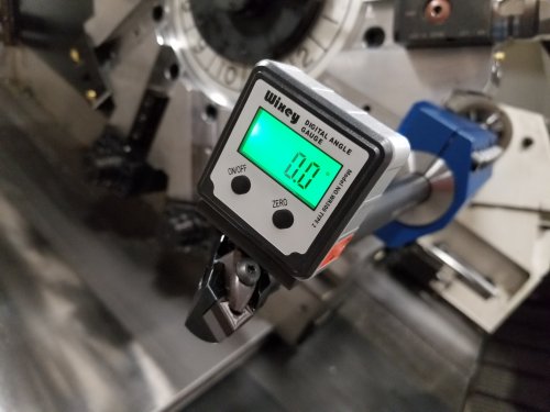

Setting the head exactly on centerline is as easy as bringing the angle finder display to zero and locking the bar in place.

Anyone who’s ever struggled to get a boring bar exactly on center will appreciate the fact that setup is extremely easy. “There’s a reference flat on the top of the head that accommodates a visual angle finder,” Eichelberger pointed out. “You just rotate the bar until the indicator reads zero, then clamp it in place.”
