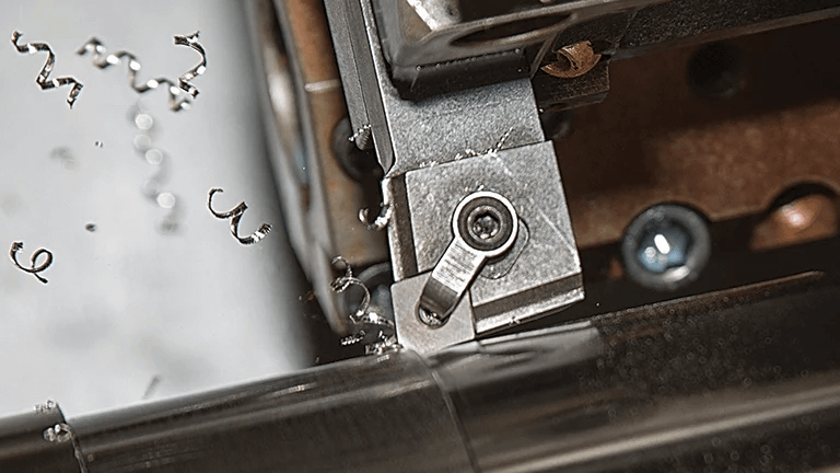

Greenleaf’s XSYTIN-1 whisker reinforced ceramic inserts can handle both nickel-based alloys and stainless steel in the same cut.

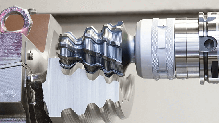

Emuge Corp., West Boylston, Mass., has come up with a creative solution for cutting turbine blade root forms and the corresponding slots in the disc. They call the new tool Pagode because it looks like a pagoda. As Milling Application Specialist Evan Duncanson explained, unlike the fir-tree cutters typically used for this application, the Pagode “does not have one big gash all the way into the core of the end mill. With the latter approach, the tool’s gash must be as deep as the smallest diameter, which also means a massive amount of material must be removed at the largest diameter. This weakens the tool significantly. In the Pagode the gash follows the tool profile such that there is only a few millimeters of relief from the cutting edge.”
This leaves much more material at the core and allows Emuge to add more flutes, and hence more cutting edges, for a given tool diameter. “A typical fir-tree cutter has only three flutes,” Duncanson explained. “We can build a Pagode of the same diameter with six or eight flutes. And the more flutes you have, the faster you can go.”
Emuge’s new Pagode cutting tool brings more cutting edges to bear on a turbine blade root form than a traditional fir-tree cutter, yielding cycle time reductions of 2 to 10x, according to the company.
Duncanson added that the additional flutes and larger core also enabled Emuge designers to use a larger helix angle than a typical fir-tree cutter. “That ensures there are always two cutting edges engaged in the part,” he said. This results in more consistent forces on the tool, which is better for tool life, surface finish, and the spindle. Plus the larger core diameter makes for “a much stronger tool overall that can take more of a beating. In testing at Emuge Germany and out in the field, we have seen anywhere from two to 10 times the life of a standard Emuge fir-tree cutter, and a cycle time reduction of two to 10 times versus a standard Emuge fir-tree cutter.” This also helps ensure the tool can last through the entire finishing cut on a large part.
Emuge can provide the tools in both carbide and HSS, and with multiple radial coolant holes in each flute, if desired. In fact, given the thicker core, Emuge is able to direct the coolant onto the cutting edge, whereas “in a standard fir-tree cutter, the flute is deeper and the coolant essentially just comes out straight,” said Duncanson. What’s more, Emuge is able to regrind each tool up to four times, and does so on the same machine that manufactured it. Thus it can guarantee 10 µm form accuracy on both new tools and regrinds.
Duncanson said the Pagode concept is also flexible enough to allow for the combination of several tools in one. “I’m currently working with a customer to create a tool that combines a bell profile at the end with a taper to a profile for cutting a straight wall, another profile for pressure surfaces, and corner radii on the outside. This would ordinarily be three or four different tools. The tool-change time on the huge machines used to cut these turbine parts can be 15 to 20 minutes, so combining tools is a significant improvement.” The Pagode has a higher initial cost than a fir-tree cutter, but Duncanson pointed out that the tool’s much higher throughput and the ability to regrind it multiple times, not to mention the possibility of combining operations, make it a much more cost-effective solution.
Greenleaf scored a victory in finishing multiple bearing surfaces on a gas turbine shafts, replacing a precision-ground braised carbide tool. “It was a tight tolerance part,” recounted Bronson, “and a nightmare to set up. They would run anywhere from seven to 13 or 14 of these tools, each of which were about $1,000 a piece, just to finish those bearing areas. And then they would hand polish them to get them to the required 0.4 µm Ra. We created an indexable carbide insert that not only greatly reduced their setup time, it also achieved an Ra of 0.34 µm—a near mirror finish. They flat out told us it was impossible, but we did it.”

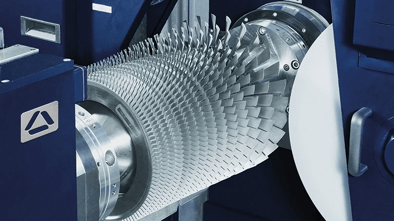

The predominant solution for achieving a fine finish on turbine components is, of course, grinding. And for compressor rotors, Danobat USA, Houston, offers some unique solutions. As Danel Epelde, business development director at Danobat’s Spanish headquarters, explained, the blades in many of the smaller (50-mW range) power-generation turbines are loose. But for efficient operation, it’s critical to control the clearance between the moving rotor and the stationary casing.
So Danobat developed a machine that spins the assembled rotor at up to 7,000 rpm and measures the blade tips in their working position while they are being ground. Since there was no commercially available inspection system that could do this with the required precision, Danobat created its own high-speed camera system. The new system compares the images to the desired tip radius and adjusts the grinding process accordingly. Danobat also supplies vertical grinding machines for the compressor casing, so it is responsible for creating a perfect match when the camera system and grinding machine are used together.
This Danobat machine spins the assembled rotor and measures the blade tips in their working position while grinding to ensure a perfect match with the compressor casing.

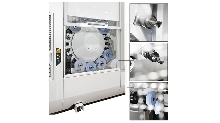

Grinding the root form of the blades that go into these rotors takes a machine like the Blohm Profimat MT high-hp, heavy-duty, creep feed grinder, said Wiss. This machine uses continuous dressing of a wide conventional abrasive form wheel, but with little or no additional automation.
Conversely, for vanes United Grinding would recommend one of its Mägerle MFP 150, MFP 50, or MFP 51 platforms. “All three include automatic tool changing and overhead dressing,” said Wiss. “The overhead dressing allows us to do continuous dress creep feed, which combines a rapid metal removal rate with the ability to hold a tight tolerance. For some parts, like a radial slot, we’d use a plated CBN wheel. The toolchanger also gives us the ability to use a metal bond CBN, along with drilling and milling, in the same machine tool. We use the 80/20 rule.” In other words, this kind of multi-tasking grinder makes sense if 80 percent of the work calls for grinding while 20 percent calls for other machining. And everyone loves processing as many features as possible in one clamping.
Wiss also pointed out that the wheel/tool flanges include RFID chips, so the machine automatically checks to make sure the right tool goes to the spindle, even if the operator puts it in the wrong slot in the changer. Plus the operator has access to the changer during the machining process, so worn tools can be replaced at any time without interrupting production.
The Mägerle MFP grinder features automatic tool changing. RFID chips ensure the right tool goes into the spindle.

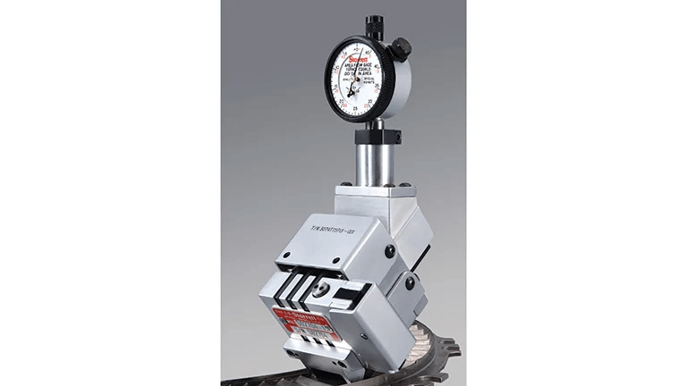

The large size of land-based turbine components, and the many differences in design and manufacturing methods from OEM to OEM, call for customized gaging. Enter the team at the Special Gage Division for The L.S. Starrett Co. , Athol, Mass. Manager Andrew Morin said Starrett engineers, designs and manufactures gages for measuring all the machined diameters; various height gages; slot gages; and even area flow gages to measure the minimum area openings of turbine engine nozzles. That last example uses eight or more contacts that reach into the throat of the nozzle openings. Hydraulic cylinders take the measurements and transfer the data to a dial indicator, where they are displayed with 0.001 in2 (0.645 mm2) resolution. This allows the operator to locate and match the segment openings around the engine circumference to provide a balanced air flow.
Starrett’s flow gages measure the area openings of turbine engine nozzles and display the results with 0.001 in2 (0.645 mm2) resolution.
For diameter gages that measure up to 90″ (228.6 cm), Starrett uses a lightweight honeycomb structure or carbon fiber and isolation handles so the operator’s body heat doesn’t influence the gage. “You can be checking a 5′ [1.52-m] diameter with a gage that weighs a couple of pounds,” said Morin. “They’re accurate down to tenths and they have a dial indicator so every operator can be sure they’re reading exactly the same. A lot of major customers have them because if you were to use a regular micrometer that large, it’s a two-person or a three-person job just to get the gage in place. With our honeycomb, it’s a one-person job and they can do it all day long.”
Starrett also make gages that reach into assemblies that are difficult or impossible to access bodily. “I’ve got a gage on my sample rack that’s 7′ [2.13 m] long and has to be lowered by a hoist into the part to be checked,” said Morin. “We also make things like double-turret gages that collapse to a small diameter, go through that small diameter, and then double their size to get the reading the operator needs without ever having to move or flip the part. We handle all sorts of awkward situations.”
