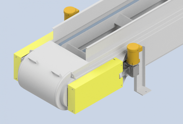

To prevent these maintenance concerns, the PRAB Auto-Take Up automatically monitors tension using load cells on chain conveyors, including steel belt conveyors, drag conveyors, the PRAB ScrapVeyor™, and more. The system is wired to a PLC control panel, which monitors tension and automatically tightens the belt to eliminate manual adjustments and downtime. It can be added to new conveyors or retrofitted onto existing models. If retrofitted onto an existing conveyor, the system can be operated using that conveyor’s original control panel. Automatic adjustments can be scheduled to be completed during low production times or shift changes.
