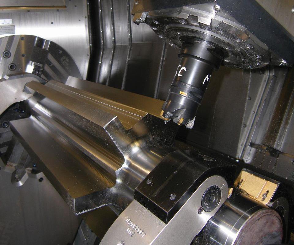

Custom workholding and form tools enable Whipple Superchargers to precisely mill supercharger rotors in one setup on the B-axis turn-mill.

Whipple’s rotor-machining process using form tools is similar to that of its supplier’s, but with modifications to increase rigidity. The machine Whipple purchased in October 2016 is a Mazak Integrex e-420H-S II turn-mill with B-axis milling head. Cylindrical 6061 aluminum rotor blanks are first center-drilled longitudinally on another machine to enable a steel shaft to be pressed into them. As an operator loads a blank into the Integrex, the machine’s main spindle and then subspindle clamp on the shaft’s protruding journals. Next, the machine’s B axis is drastically tilted to orient a custom form tool that matches the desired flute profile when at that angle (see this story’s opening photo). Finally, the spinning form tool is moved along the Z axis as the rotor is slowly rotated to create each flute in multiple passes. “At this point, what we have here is a high-end, two-axis lathe,” Mr. Bright quips.
Initially, Whipple used extended-length, pull-back-style ER collets to clamp on the shaft journals. The extended length was required to position the blanks away from the subspindle to provide sufficient clearance for the B-axis spindle to tilt as far over the subspindle’s chuck as necessary. However, the pull-back functionality of those collets made loading rotor blanks time-consuming and challenging. Collet tightening (resulting in pullback) put excessive load on the main spindle, meaning the W-axis subspindle had to be trammed-in to help dial-out the load. Otherwise, chatter or poor surface finishes could result. As a result, operators such as Chris Jensen would continually clamp and reclamp until most of the load was eliminated. This typically took 10 minutes. Plus, Whipple was constantly replacing collets due to the wear they experienced being tightened and loosened so many times.

At the advice of Kellen Bush, Mazak’s application engineer who worked with Whipple on this project, the company contacted Hainbuch to devise an alternative workholding approach. Hainbuch Sales Manager Tom Chambers explains that the company’s custom workholding solution not only provides the extended reach required to enable the machine’s B axis to tilt to the requisite angle without interference, but it also offers higher rigidity while simplifying changeovers. This is possible largely because dead-length collets are used instead of pull-back types. Mr. Chambers says dead-length collets “clamp in space,” meaning the rotor blanks will not move when the collets are clamped. As a result, no additional load that would have to be dialed-out is applied to the main spindle. Changeovers now take only 2 minutes.

The Kyocera Unimerco form tools Whipple uses to machine its rotors (as does Whipple’s European supplier) actually are not commonly used for cutting metal. Anders Varga, sales manager for Kyocera Unimerco, says this type of tool is typically used for cutting wood, composites and other fibrous materials. This is primarily due to the amount of pressure that would be exerted on the tool as a result of the high contact area between a metal workpiece and long insert cutting edges. That these tools can be used in this rotor-machining application speaks to the rigidity of the machine with Capto spindle interface and its custom workholding.
Using form tools that match the rotors’ helical flute profile (profiles Mr. Bright has refined) eliminates polishing that might be required if multiple end mills were used to carve the flutes. The rotors are machined so their lobes are as big as possible, but slightly undersized to allow for a subsequent proprietary coating. Whipple typically keeps two roughing tools and three finishing tools on hand for both male and female rotors. The tools use uncoated, micro-grain carbide inserts. The inserts for the roughing tools are attached to the tool bodies via screws; finishing tools are brazed to them.
