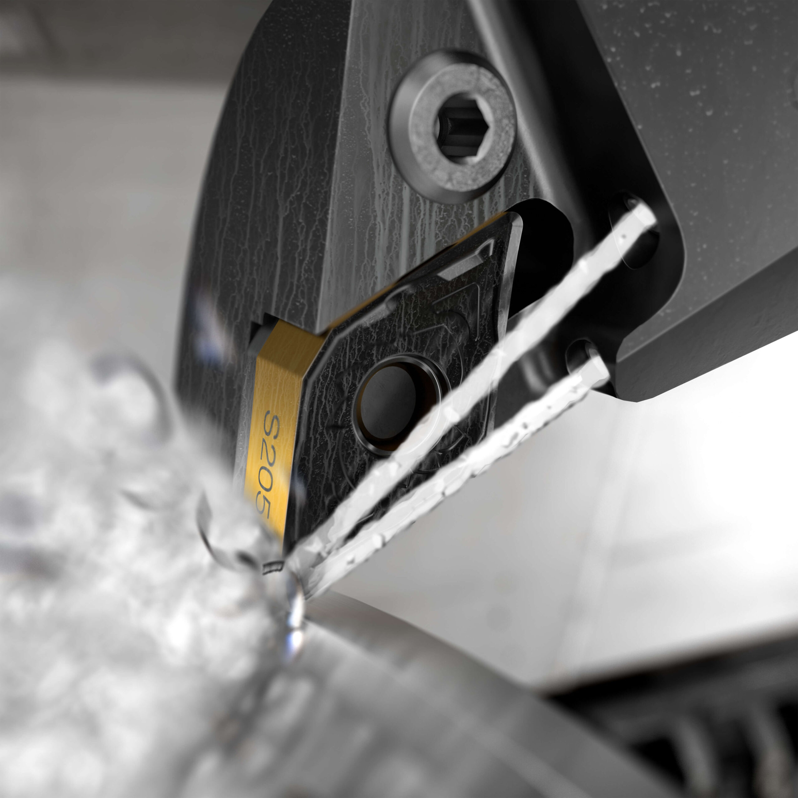

Turning tools with precision coolant are equipped to give accurate coolant jets with laminar parallel flow. The jets create a hydraulic wedge between insert and chip, affecting the chip form and flow and reducing temperatures in the machining zone. Employing nozzles mounted close to the cutting edge that produce accurate, high velocity jets forces the chip off the insert face and cools and breaks the chips into smaller lengths, helping to evacuate them.
Benefits of precision cooling in finishing operations have been established even at pressures down to 10 bars in material including steel, stainless steel, aluminum, titanium and HRSAs. Apart from higher security brought about by better chip control, precision coolant can provide a considerable improvement in tool life and a potential for higher cutting speed. By applying precision coolant, 50 percent tool life increases can often be the result.

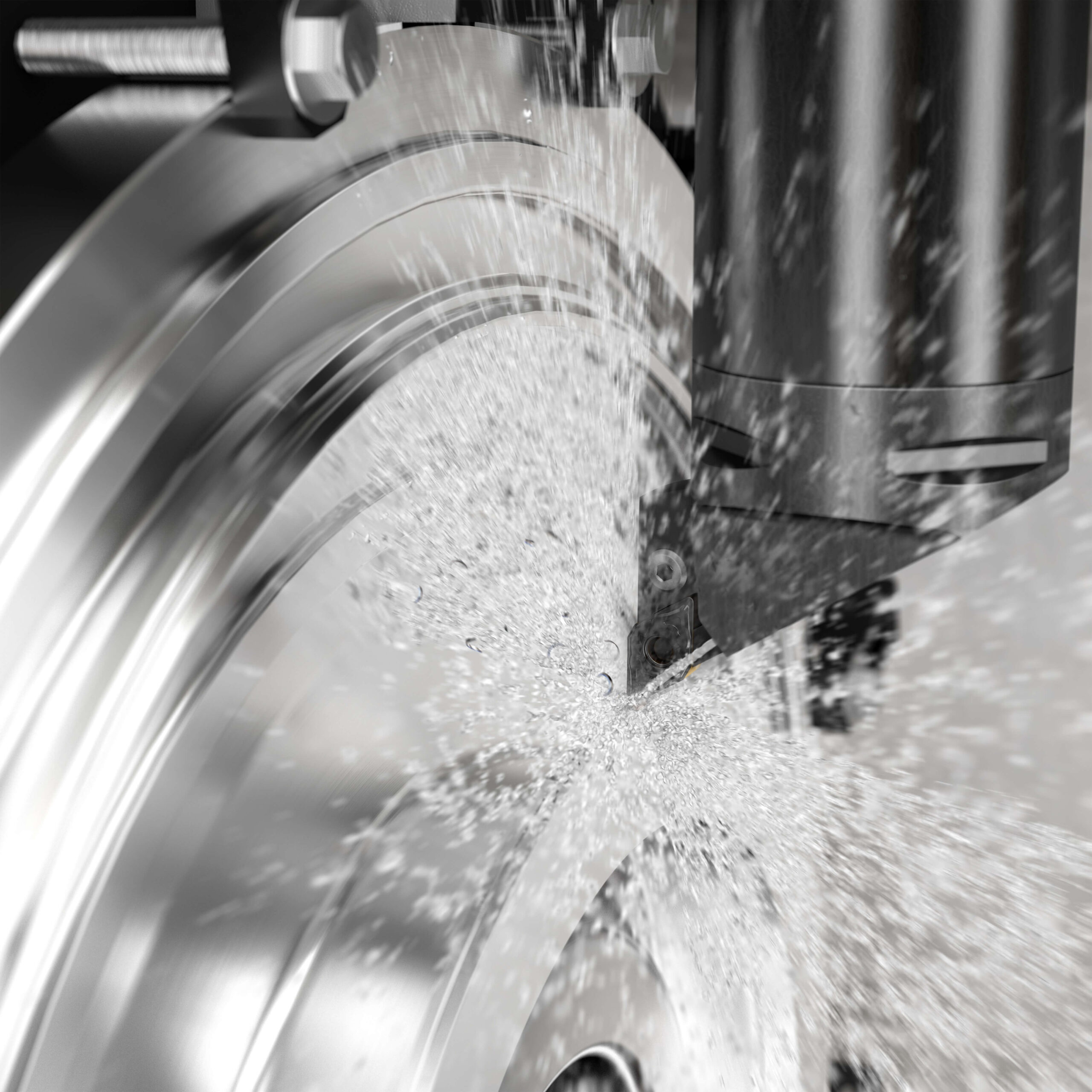

Turning of an HRSA turbine disc. Precision coolant can play a vital role in ISO S machining.
The effect of precision coolant can, therefore, provide the potential to raise performance by way of higher cutting speeds without the usual rise in temperature and loss in tool life. There is a clear cooling effect and not the higher cutting forces through higher feeds. For ISO S classified materials, a 20 percent increase in cutting speed can be achieved while maintaining the same cutting length.
