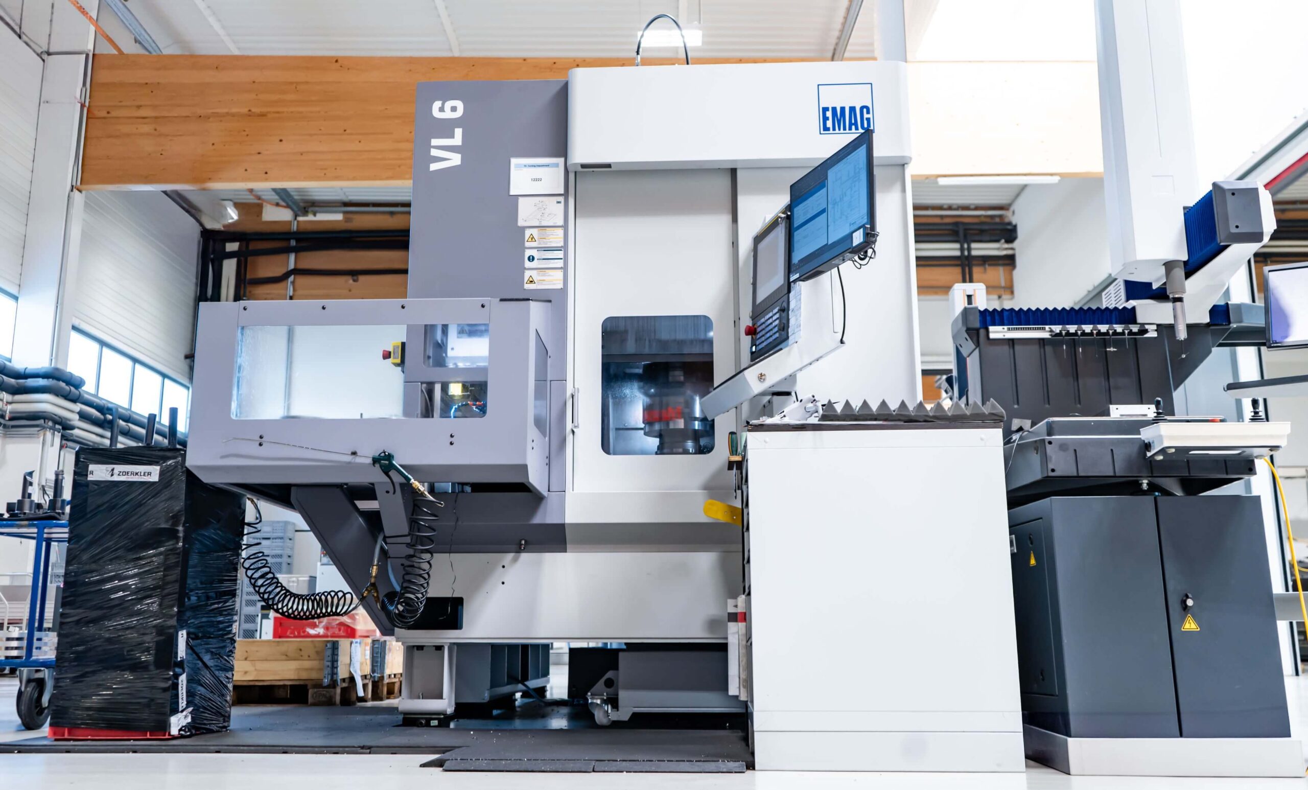

The decision in favor of the EMAG VL 6 was based on the need for automated machining of heavier components with the highest precision and reliability. Bernhard Wagner, Managing Director of the company, explains: “The VL 6 enables us to produce complex components with excellent dimensional accuracy, even with frequent changes of workpieces for our small series. This is crucial for our production flexibility and for meeting the high quality requirements of our customers in the aviation and automotive industries.”

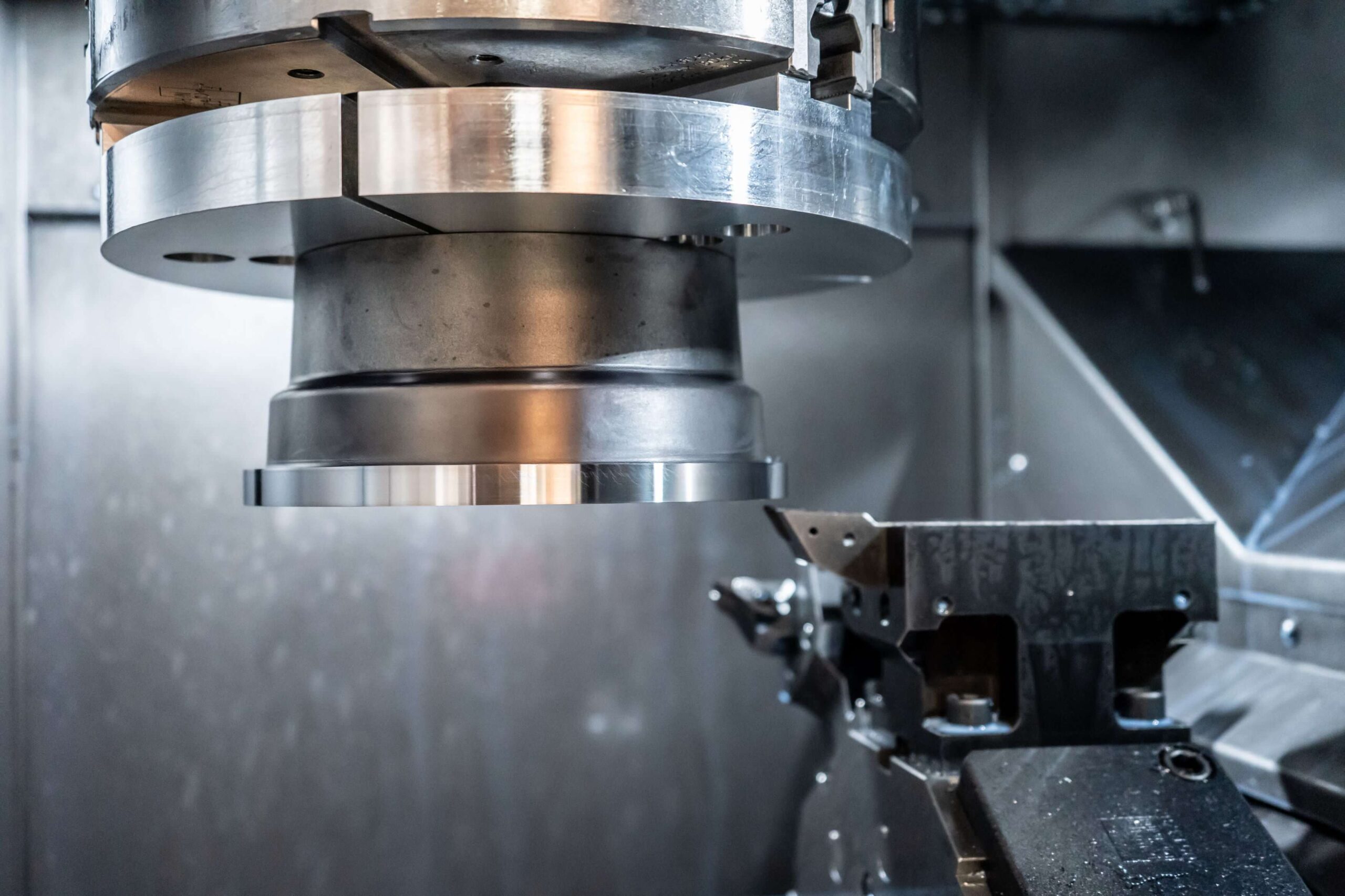

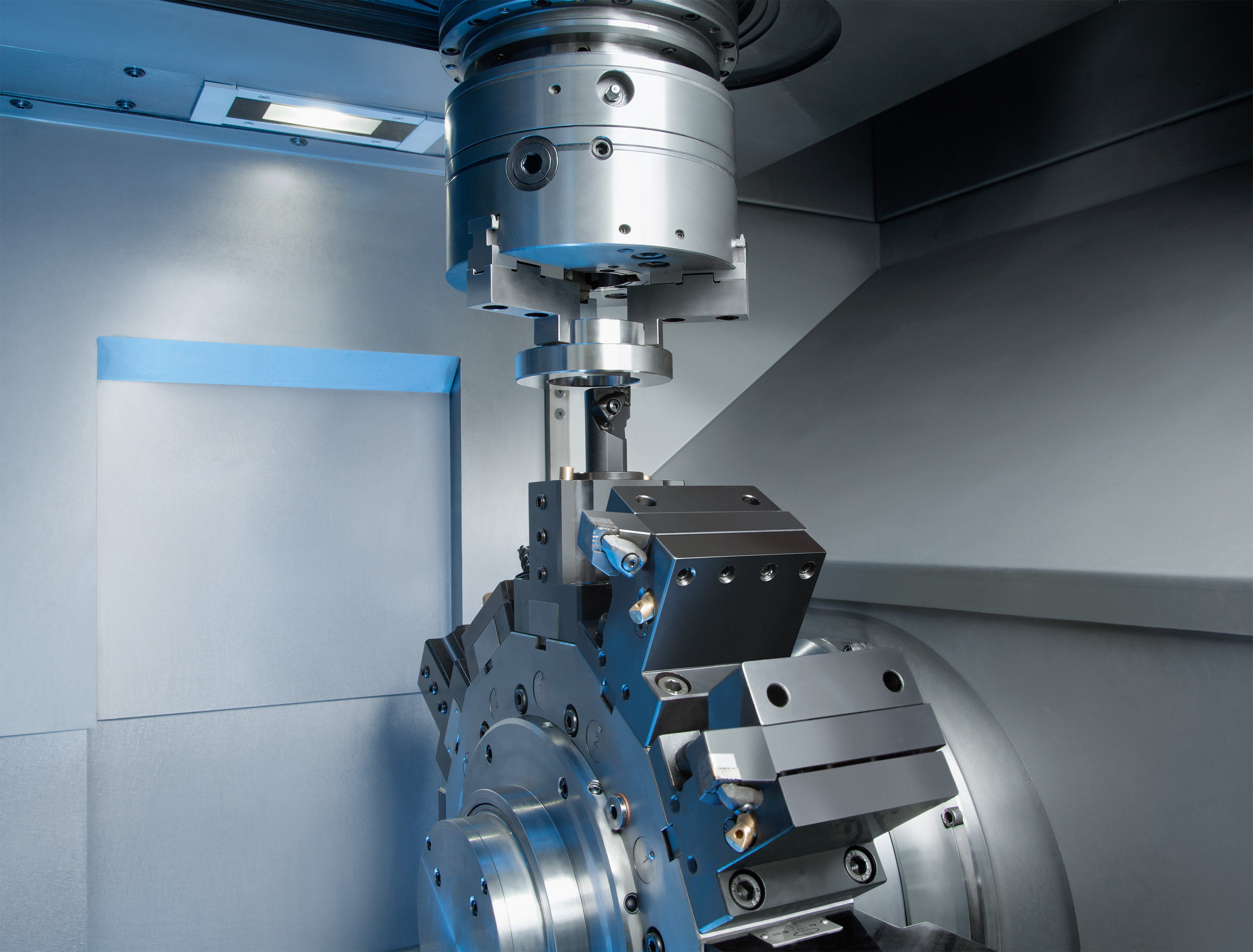

The machine’s integrated hard turning and milling functions are particularly noteworthy. This multifunctionality enables Zoerkler to perform demanding machining steps in a single setup, which contributes significantly to increasing precision and shortening cycle times.

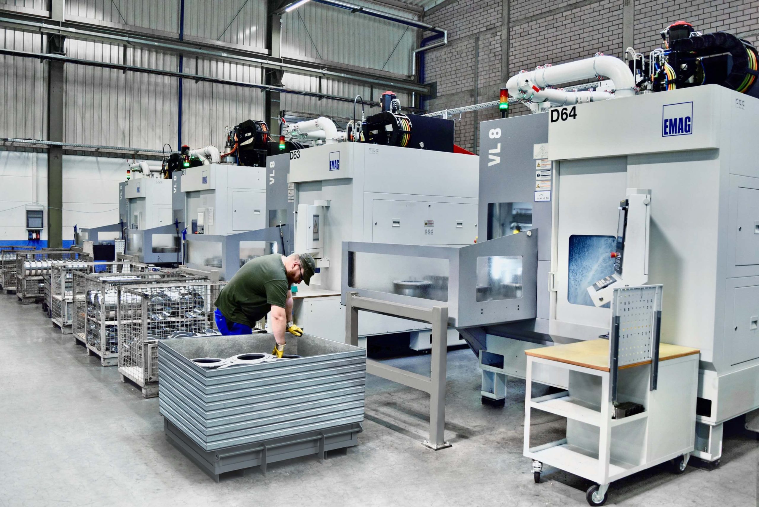

Modern production hall with the VL 6 vertical pick-up turning machine from EMAG at Zoerkler.
Another advantage of the VL 6 is its highly developed automation system. “We can often run the machine autonomously in the second and third shifts, which significantly increases our productivity,” explains Wagner. The combination of reliable automation and constant precision enables efficient production around the clock without compromising on quality.

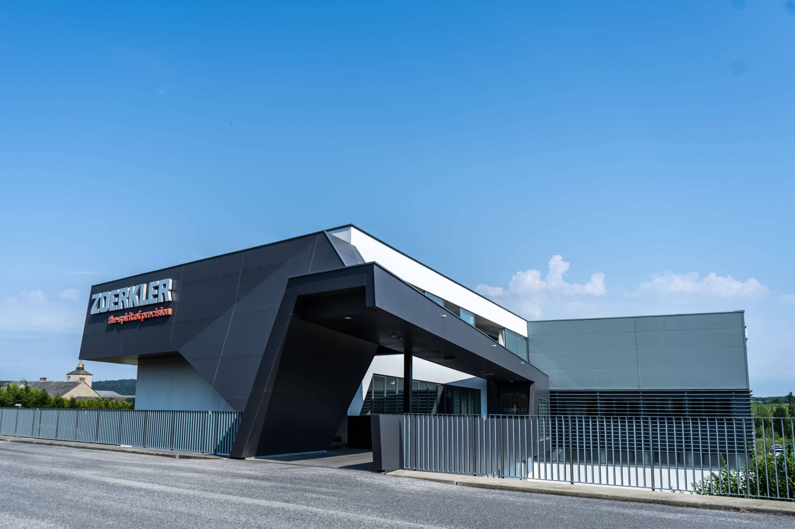

The high quality standards are also reflected in the design of the Zoerkler production hall in Jois, Austria.

High-precision machining of a gearbox housing on an EMAG VL 6.

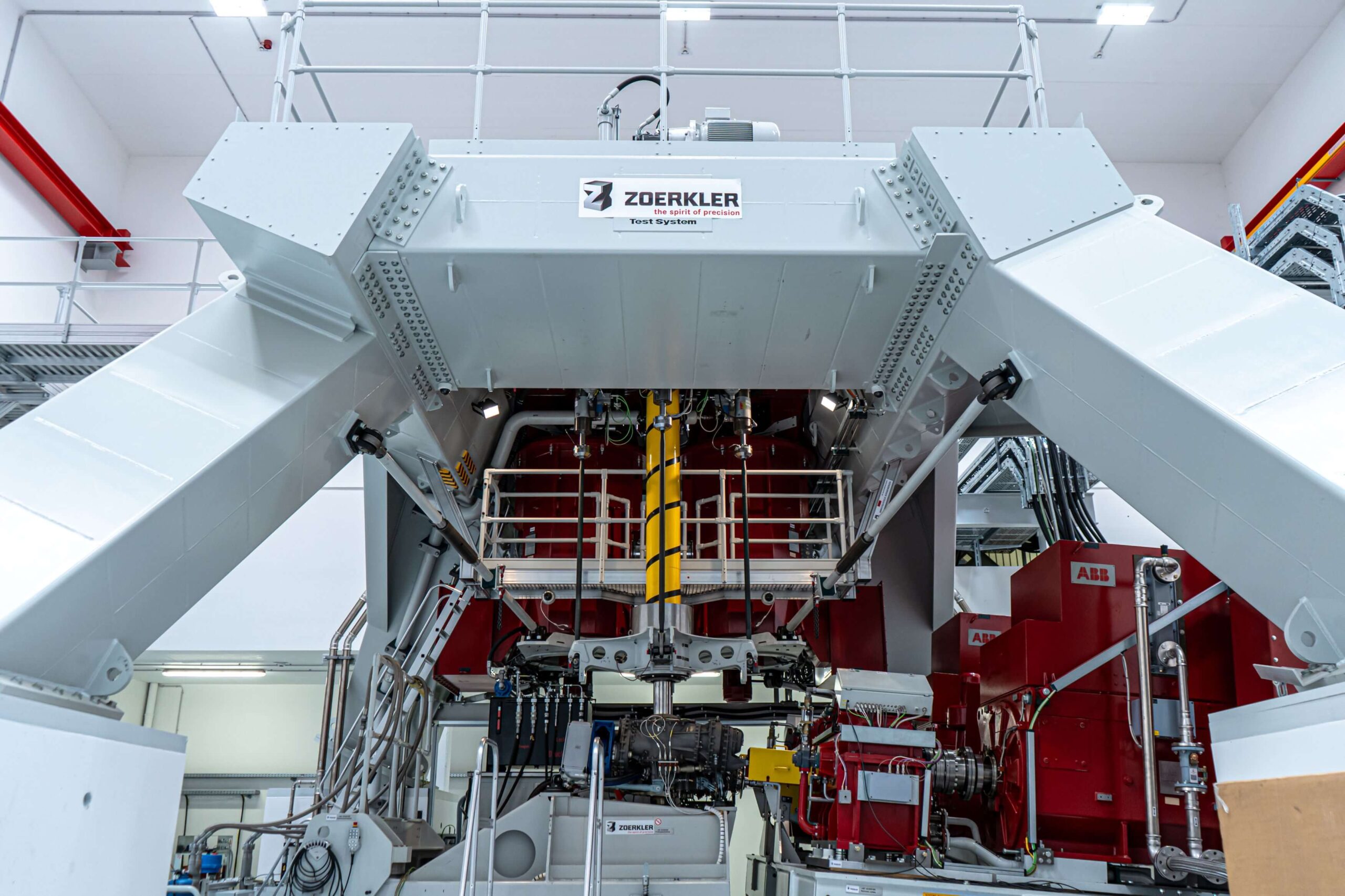

One fascinating aspect of your company that we haven’t talked about in detail is your test stands. Can you tell us more about them?
With pleasure. Our test stands are indeed an essential part of our range of services and an important factor in our success. We have a wide range of ultra-modern test facilities that enable us to test our products under realistic and often extreme conditions.
One highlight is our high-performance helicopter gearbox test stand. It can handle outputs of up to 2 x 4 megawatts, motor speeds of up to 26,000 revolutions per minute and torques of up to 180,000 newton meters. This enables us to carry out even the most demanding certification tests for helicopter gearboxes.
The impressive helicopter gearbox test stand from Zoerkler.
