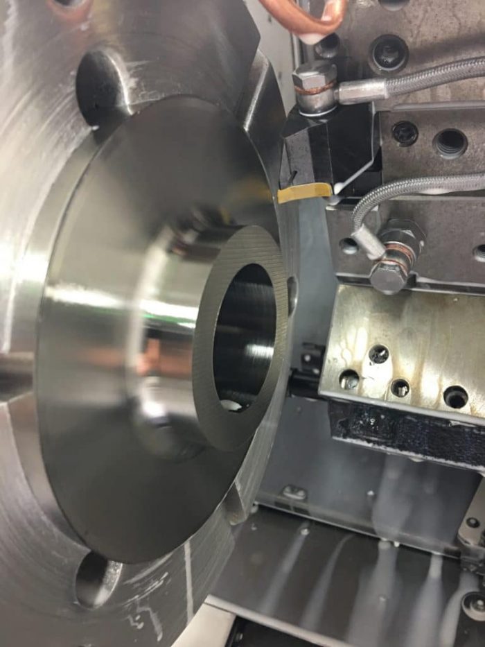

Sandvik Coromant’s Prime Turning reduced cycle time on this Inconel 625 part at Precision Shapes by 80 percent, and more than doubled tool life. (All images provided by Sandvik Coromant)

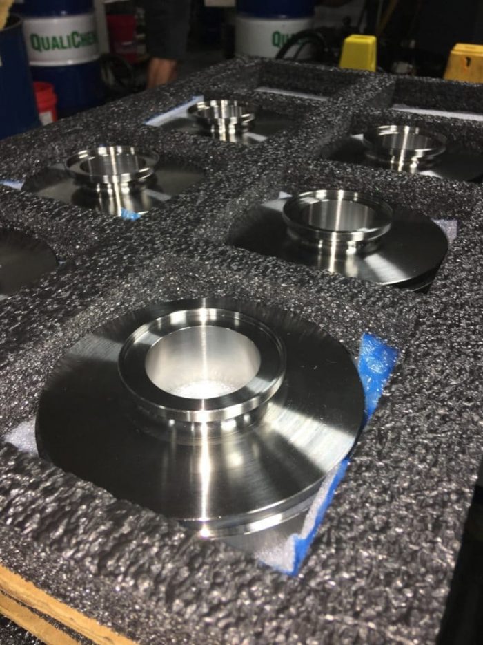

A batch of completed Inconel 625 rings at Precision Shapes, ready for shipment.
This wasn’t the case with a recent job, however. The 5½” diameter by 2″ (139.7 by 50.8 mm) long Inconel 625 rings started out looking like “monstrous hockey pucks,” requiring roughly ¾” (19.05 mm) of material to be removed from each side down to a diameter of 2½” (63.5 mm) with a 1¾” (44.45 mm) hole punched through the center. Tool life was so poor that roughing, semi-roughing, semi-finishing, and finishing tools were needed to complete each face and the outer profile, for a cycle time of nearly four hours per part. Worse, the CNMG rougher had to be indexed four times per cycle, adding considerable expense to a part that was slated to run for the next year—1,100 pieces in all.

When O’Neill arrived, the roughing operation alone was taking just shy of three hours to complete. He and Sandvik Coromant Machining Specialist Dave Edwards reprogrammed the job “the PrimeTurning way,” rolling into the cut, pushing the tool hard on the straightaways, slowing around the corners, all the while taking full advantage of Prime’s chip-thinning geometry to remove as much of the difficult material as they could in the shortest time possible. They also kicked up the cutting speed, going from 80 to 170 sfm, and more than tripled the feed rate to 0.020 ipr.
The results were impressive. Said O’Neill, “I was hoping for a 50 percent cycle time reduction—we got 80 percent, and more than doubled tool life at the same time, saving them an additional $250,000 per year above and beyond the productivity improvements. We were all pretty awestruck.”
