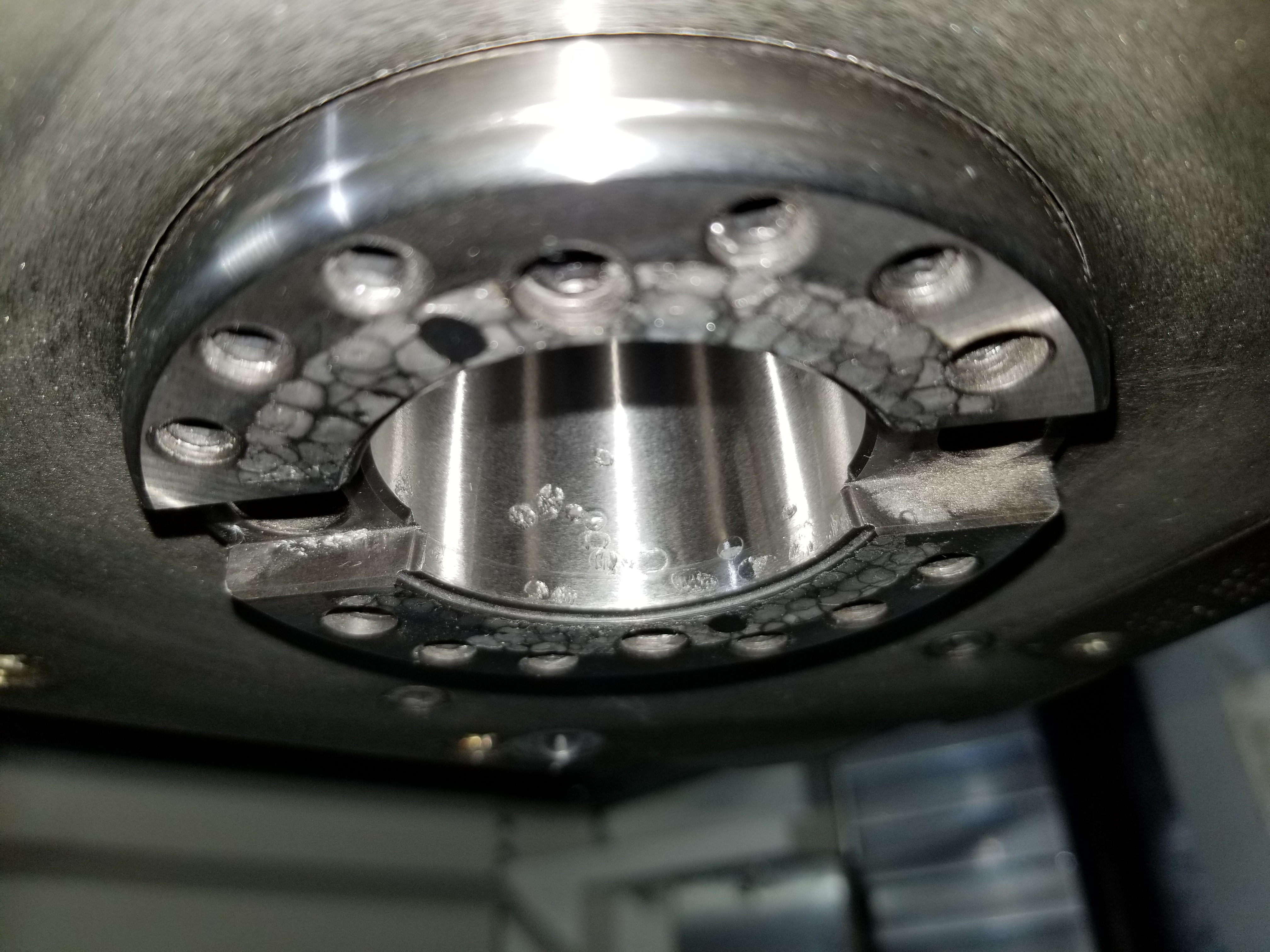

Arc welding on taper and taper face due to improper fitting tool. Customer was not using a BIG Daishowa tool holder.

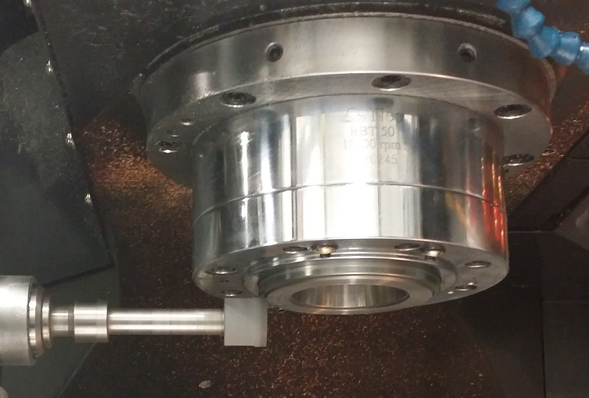

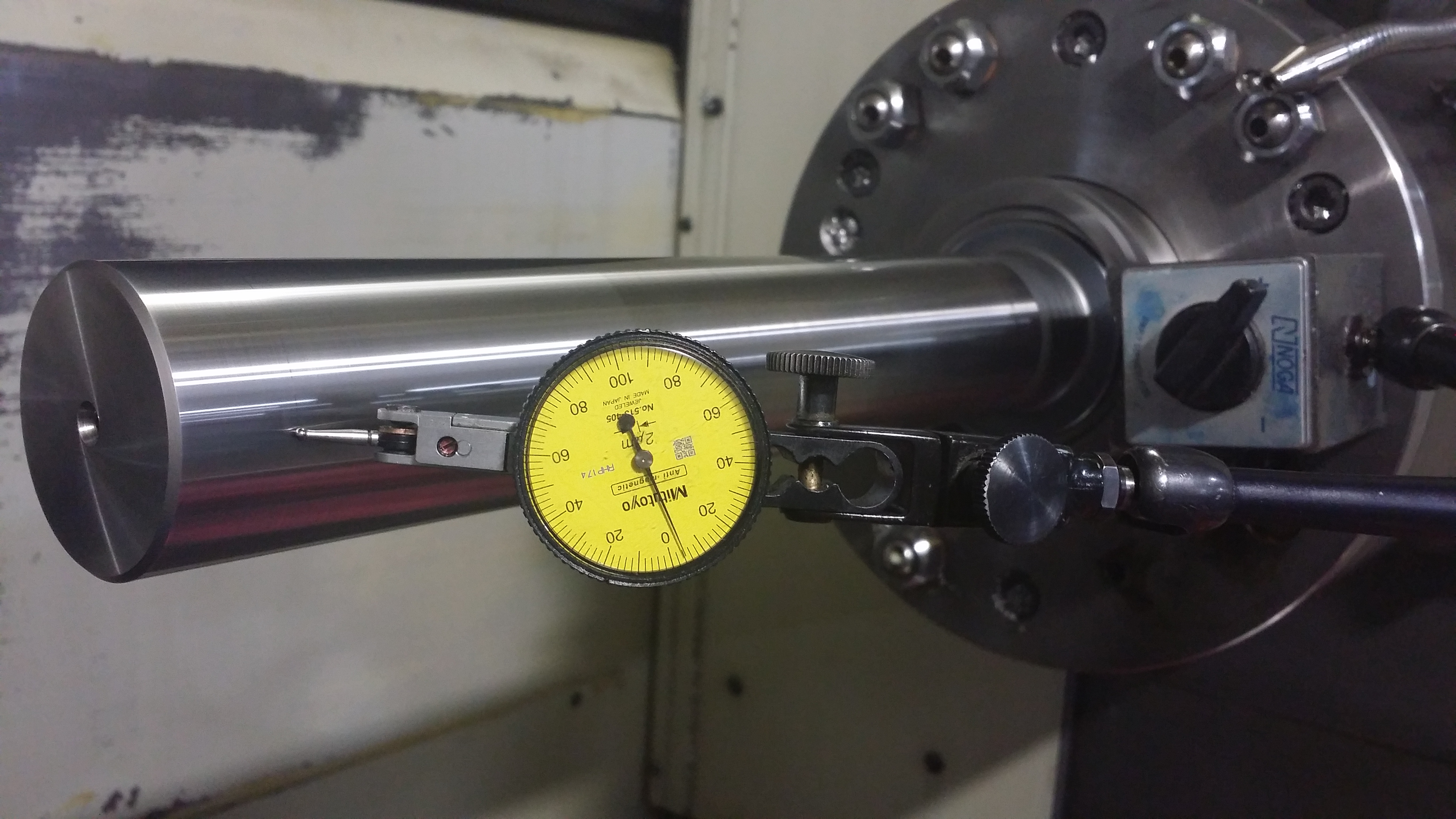

Checking Run-out with a 300mm test bar after grinding a BIG PLUS taper.

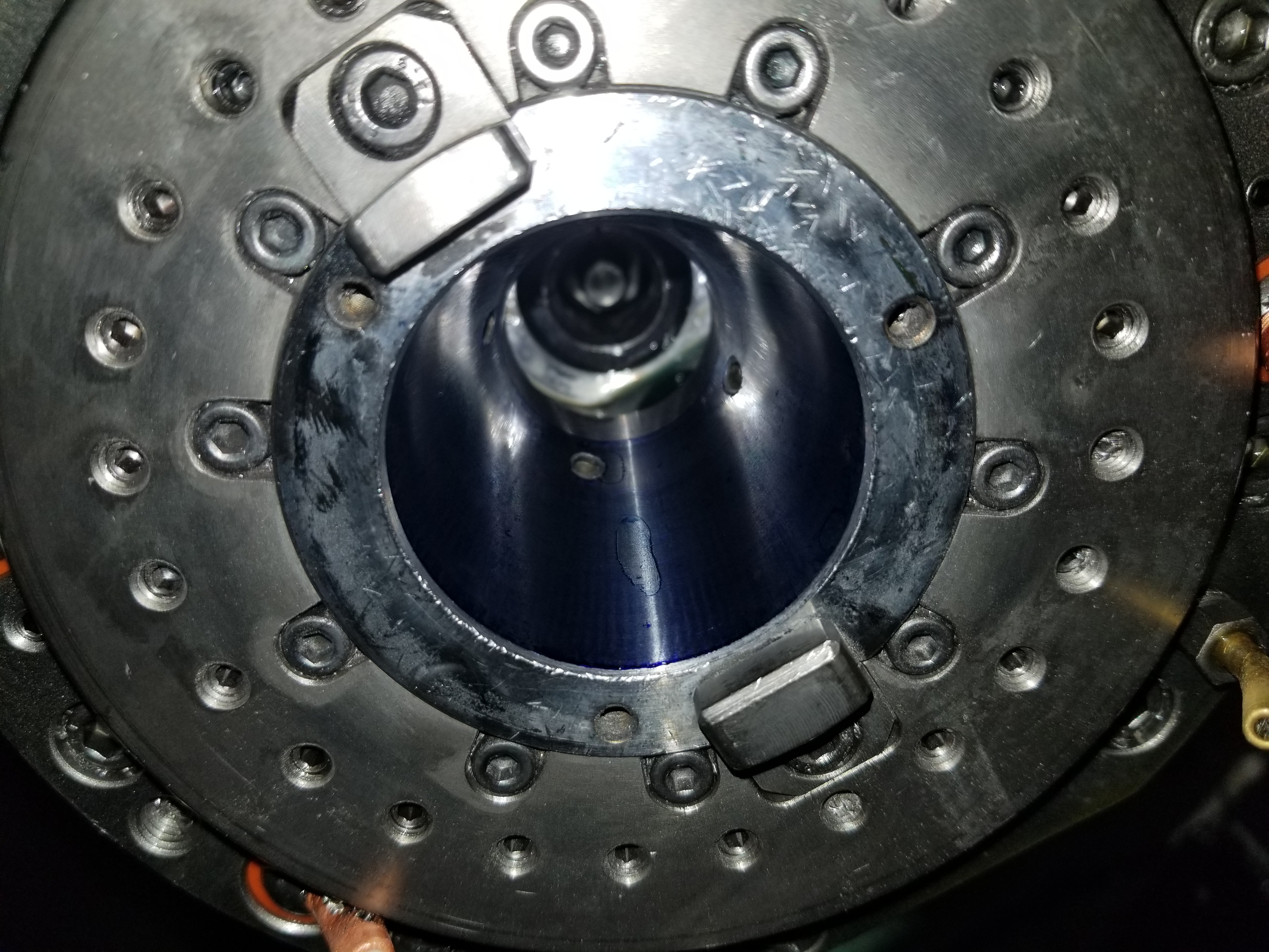

BIG PLUS taper before OnSite Taper Grind.

When you use standard V-flange tooling on a BIG-PLUS spindle, that spindle opens up over time. It becomes a little bit bigger or wears bell mouth. That’s ok if you’re using just taper contact tooling, but not when you put a BIG-PLUS tool into that spindle.

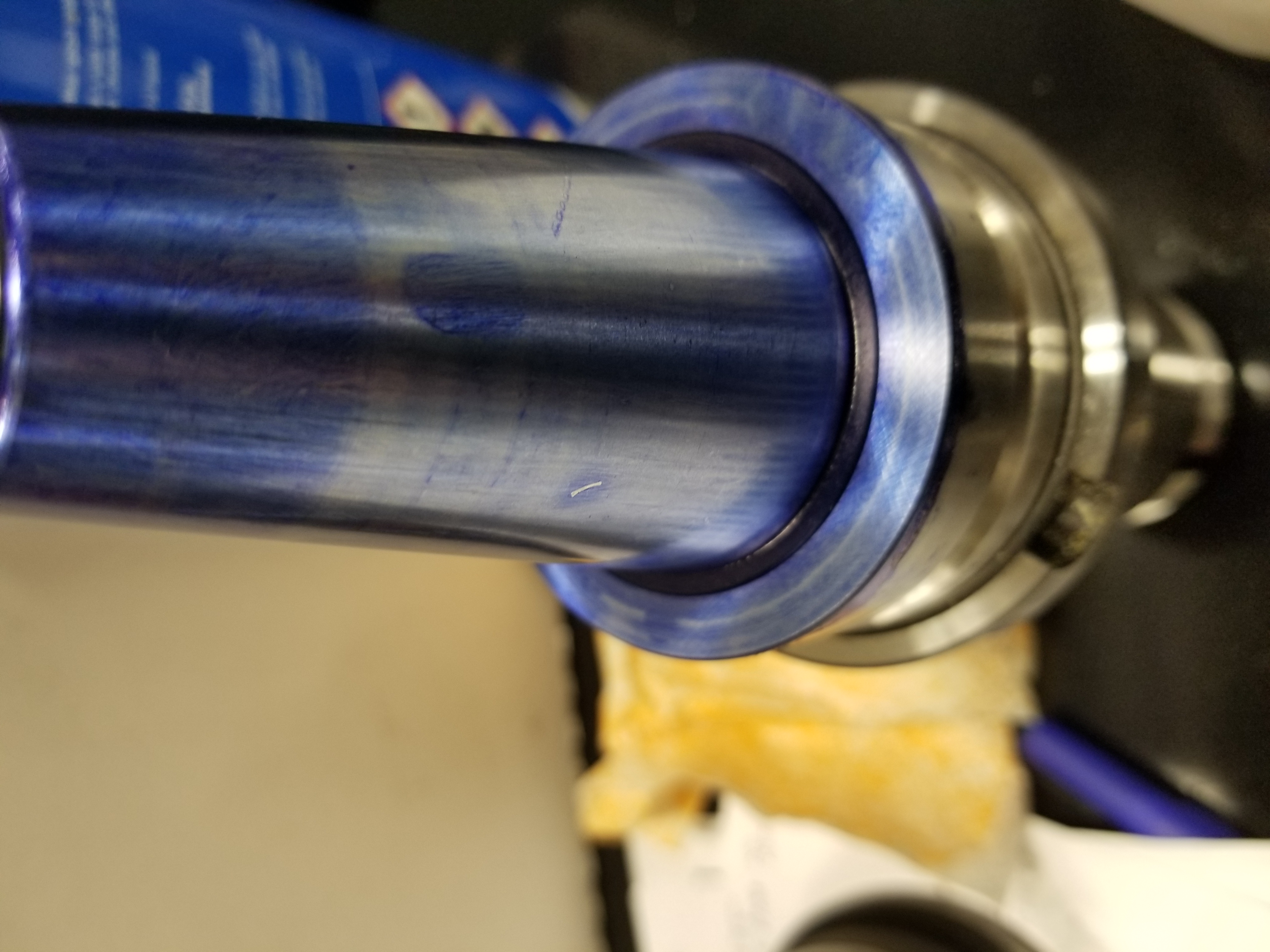

Phil explained that he has seen the scenario play out over and over where standard tooling was used and the spindle face measured .001”-.002” heavy, or worse. At numbers like that, you aren’t going to get taper contact, and you are going to have runout, even with BIG-PLUS tools.
Prevention: We don’t recommend using big plus spindles that aren’t either new or certified by experts like SPS. Because if you put BP into a stretched out, worn spindle, it’s probably not going to perform nearly as good as a standard tool holder and certainly not as good as a BIG-PLUS should.

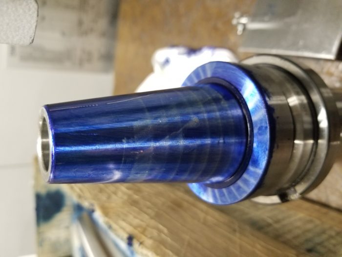

Tool holder blued up to check contact before grinding. As you can see its only contacting about 50% of the taper and the face is not making any contact.

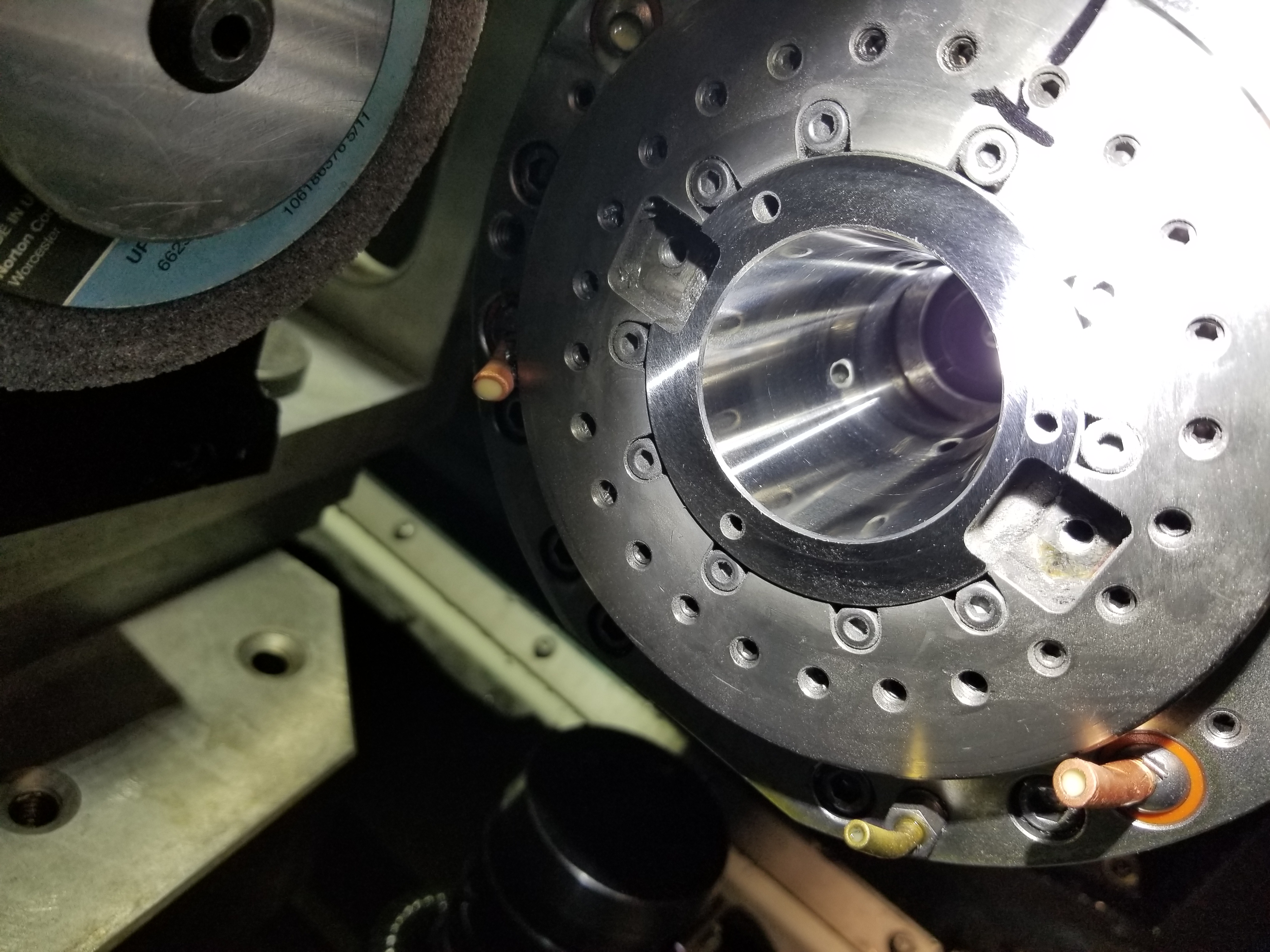

BIG PLUS taper after OnSite Taper Grind.
The Solution
If you’re already seeing symptoms like these, it may be too late for the “prevention” steps to be effective. That’s where people like Phil and the SPS team come in. A spindle regrind can return a BIG-PLUS spindle to peak performance—but not just any regrind. Just like manufacturers need the right gauges to build on-spec BIG-PLUS tools, regrinders need the master gauges and measuring devices to return spindles to spec. Only certified servicers have that. (In fact, we could have included “Having an uncertified grinder regrind your spindle” on the list above.)

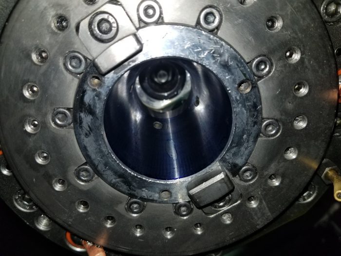

Tool holder all blued up before rechecking contact after grind.
Phil jumped in, “I can’t stress highly enough that that is the worst thing to do. When they get in there by hand, they don’t have a lot of control and often undergrind the spindle. You can’t put that material back.”

Before even considering the BIG-PLUS relationship, Phil starts with vibration and retention force testing to identify any foundational (bearing or drawbar) issues. From there, he’ll test runout inside the nose with a micron indicator, and at 300mm out with a test bar. He’ll also check where tool/spindle contact is being made.
