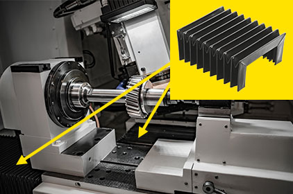

Metal chips, fluids, swarf, and other contaminants will do a number on your machine’s ball screws or linear rails. Dynamic and flexible protection is needed to keep cylinder rods, linear bearings, and ways in top notch condition. Bellows and way covers help protect critical parts without obstructing motion.
Bellows covers protect linear rails and ways

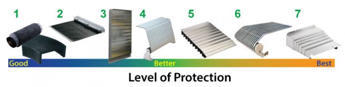

Types of Flexible Covers and Levels of Protection
There are flexible cover designs that can roll-up, bend, and flex to allow unrestricted movement through a dynamic range of motion.
Protective covers are available in various materials and types. They can be polymer-based, metal, or fabric depending on the requirements of the application.
1. Fabric Bellows are the most flexible for adaptation to high speeds and smooth-gliding applications. They are available in varying shapes, size, and materials including elastomer-coated fabrics, thermoplastics, and coated aramid fibers. Way protectors can have custom profiles (plastic stiffeners) that fit around the protect rail or way surface.
2. Fabric Shade Roll-Ups are capable of high-speed operation and have a wide shade material selection. They are ideal for travel paths with space obstructions that preclude deeper cover profiles. They are often used for added operator safety around a machine lathe.
3. Steel Sliding Plate Covers provide a low-profile option capable of high-speed operation and will endure weld spatter and hot chips. Liquids may seep through shields, so let the manufacturer know what type of conditions are expected.
4. Aluminum Roll-Ups are constructed of linked extrusions to form a barrier against hot chips and light exposure to coolants and oils. The smooth finish of the cover adds to the overall appearance of the machinery.
5. Steel-Plated Way Bellows have shields attached to the bellows’ folds to protect against abrasives and liquids. Metal-shielded bellows offer a lower-profile alternative to telescopic covers.
6. Metal Roll-Ups with steel band material are suitable for longer travels and wide spans, and some manufacturers offer a heavy-duty version (e.g. Dynatect’s Steelflex cover) that can be used as a walk-on surface for covering hazardous pits.
7. Steel Telescopic Covers offer the ultimate protection for machine ways against dropped tools, abrasives, chemicals, and coolants. Telescopic covers can be refurbished, and wipers replaced as needed. Dynatect offers full service repair and manufacturing of telescopic covers.
