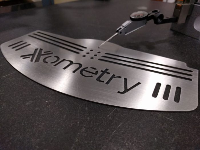

Photo courtesy of Xometry, www.xometry.com
