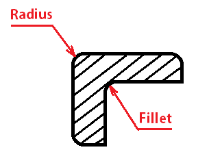

Radius Gage Anatomy
It is probable that when you hear the term “radius gage” you will also here the term “fillet gage”. The different names are often used interchangeably. It just depends on who are you talking to. They are both used to take measurements, however their purposes are a bit different. Fillet gages are designed to measure the interior radius of a part while radius gages are designed to measure the exterior radius. This simple difference is depicted in the image below.
Image Credit: https://extrudesign.com/radius-gauges-fillet-gauges/
Because of this fundamental difference, the term “fillet gage” is used more frequently in relation to welding and “radius gage” is most frequently associated with machining projects.

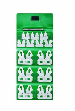

Starrett SD167GHZ Radius Gauge Set
Each gage is clearly marked with its associated radius and has 5 different gaging surfaces for both convex and concave radii. This set features a satin stainless steel finish and is stain resistant. All of the gages have precision radii for smooth and accurate readings.
Accusize Industrial Tools 26 Pc Radius Gauge Set
Take a look at this option if affordability is your priority. This gage set covers a measuring range of 0.010″ – 0.500″ and features a satin chrome finish. Each gage is individually marked with associated measurements and is resistant to rust.
INSIZE 4804-26E Radius Gage Set
This specific set has a range of 0.10″– 5″, however INSIZE offers gage sets with other measurement ranges. This option is also on the more affordable side and includes a green plastic casing.
Mitutoyo 186-901, Radius Gage Set
This set includes 25 different “leaves” (each individual gage). Each gage includes 5 different radii. The measurement range is 1/64″ to 17/64″ by 64ths and 9/32″ to 1/2″ by 32nds. A 4″ long holder makes this model great for checking radii in hard-to-reach locations.
