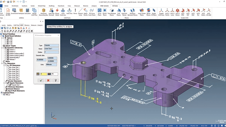

Verisurf supports STEP AP 242 model-based definition with associative GD&T, as shown in this NIST test model, which automates inspection planning and reporting while reducing transcription errors.

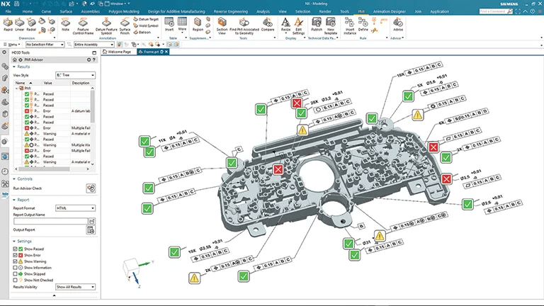

NX PMI Advisor is a fully integrated PMI validation solution that provides notification verifying whether PMI is compliant with industry and company standards. NX PMI Advisor removes the dependency on GD&T experts and produces higher quality parts in less time, according to the developer.

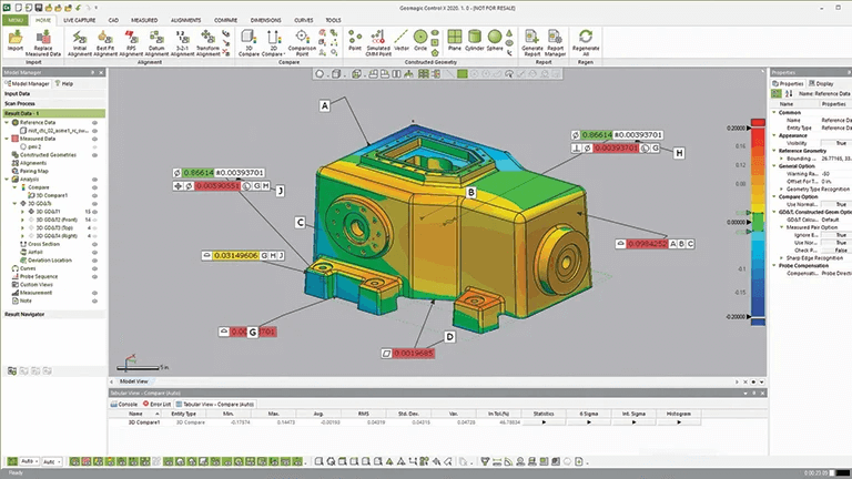

The NIST Test model #2 in STEP AP 242 format imported into Geomagic Control X, showing deviations against tolerances in a color map.
