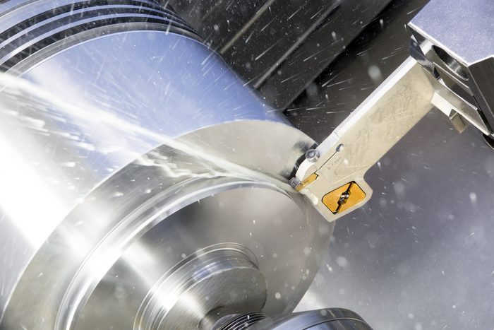

Vibration in deep grooves
Deep grooves are inherently difficult operations.  Tool rigidity is compromised as tool extension increases. The result is instability of the tool in cut.  While in cut, the tool deflects which causes vibration, resulting in poor part finish and reduced tool life.
Vibration can occur due to several factors: machine and clamping system rigidity, part shape, tool and insert design, and cutting parameters. In many cases, however, especially in deep grooving applications, it is not possible to design cutting tools that will avoid vibration in a conventional way. The general recommendation to avoid vibration issues is to work with toolholders with high rigidity and clamping force and to choose the best inserts for this type of operation.

 Deep grooving and parting operations usually require advanced insert geometries. Grooving inserts have either a square or round shape on the end.  Square grooving inserts reduce cutting forces and cut more efficiently.  For the tool holder, the tool overhang should be minimized to improve the stability of the tool during plunge moves.

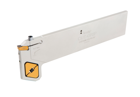

The Anti-Vibration blades are designed to be tunable. Depending upon how far the blade is extended from the holder, you can tune the blade to cancel out the different vibrations.
4. Utilize vibration-dampening technology
Advanced anti-vibration technology is a good solution to resolve problems in deep grooving operations.
ISCAR recently introduced a new technology designed to eliminate vibration problems. The new WHISPERLINE blade features a damping unit that absorbs vibration, which enables a stable machining process even at elevated cutting conditions.
