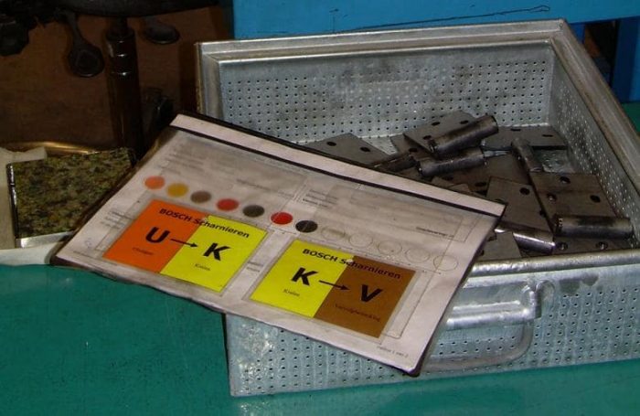

Figure 1 This shows a job packet and bin sitting at Cell K. The U/K card shows where the parts came from (Cell U), and the K/V card shows where the job is going (Cell V).

At its core, POLCA provides signals in the form of cards. The signals do not specify demand for a product, as kanbandoes. They instead signify available capacity. By itself, the system doesn’t require software at all, but it can be used with existing software platforms, be it an enterprise resource planning (ERP) system or a homegrown Microsoft Excel or Access worksheet.

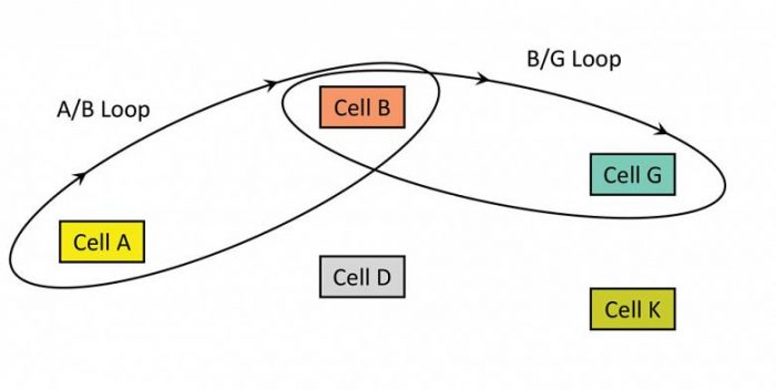

Overlapping Loop. Sending that card back creates a loop. Jobs with cards flow from Cell A to B. Once Cell B finishes, A/B cards loop back to Cell A. The “overlapping” term comes in because, of course, few if any products flow through just two cells or workstations. A complex routing can entail a dozen or more manufacturing steps (see Figure 3).

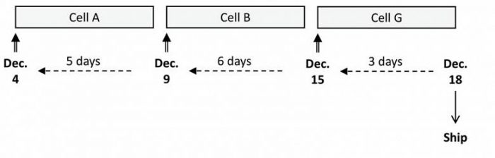

This creates what Suri calls a POLCA chain. Figure 3 shows a chain where Cell A feeds Cell B, which feeds Cell G. Cell B is where that A/B loop overlaps with the B/G loop. This dictates what cards workers need when starting a job. Again, for workers to start a job, they need to know that downstream cells have available capacity.
Say you’re working in Cell B and see a job arrive with an A/B card attached to it, and that you’ll need to send the job on to Cell G. Before starting the job, you need to make sure that Cell G has available capacity. You look at a board in your cell (Suri calls these POLCA boards) to see if there’s a B/G card available. But before grabbing the card and placing it in the job packet, next to the A/B card (which, again, isn’t sent back to Cell A until the job is finished), you need to do one more thing. In fact, you need to do this first, even before looking at any material queued before the cell. You need to look at the authorization list.

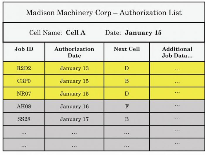

Authorization. “With authorization” is a critical part of the POLCA name. The authorization list at each cell shows everyone not when a job is due but when a job can start, based on the estimated flow times derived from existing scheduling data from a shop’s existing ERP software or other systems (see Figure 4).
Jobs that are behind schedule will have an authorization date in the past; they go at the top of the list. As Suri explained in the book, this doesn’t necessarily mean a job will ship late. The authorization date will force the job to at or near the top of every authorization list at every downstream cell. This effectively expedites the job through the rest of the routing without significantly disrupting the flow of other work.
The authorization list in Figure 5 shows a job on the schedule for Cell A and the next cell. It’s Jan. 15, and you see material has arrived for the job R2D2. Its authorization date, Jan. 13, is in the past, so you know it’s authorized to run. The job is destined for Cell D, so the POLCA board needs an A/D card. If you see it, you grab it, attach it to the job packet, and start the job.

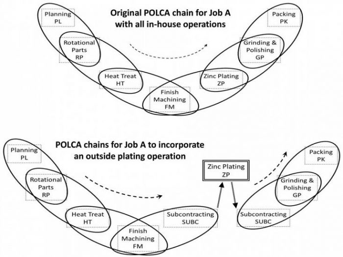

Each job need not have a POLCA chain that spans the entire factory, from the office to the shipping dock. Sometimes it’s impractical to do so. If work is, say, sent outside for heat treating or powder coating, that step really can’t be another “cell” in the POLCA chain. If it were, then a card would have to be sent with the job to the heat treater. Workers need to receive a signal of available capacity downstream (that is, the right POLCA card) before they work to fill that available capacity. So if everyone follows the POLCA rules, removing a capacity signal from the shop floor (by sending the card to the heat treater) effectively “removes” available capacity—though, of course, in reality the capacity is obviously available.
Figure 6 shows a job that has most operations in-house except for zinc plating. Suri recommends that jobs requiring outside services flow through two POLCA chains. One starts with planning and ends with the subcontracting planning team (which could be the same as the initial planning team). The subcontracting team then acts as the beginning of a second chain. When it sends a job out for zinc plating, it sends a POLCA card (in this case, an FM/SUBC card) back to the finish machining cell. When the job comes back in a few days, the team releases the job into the second POLCA chain.
