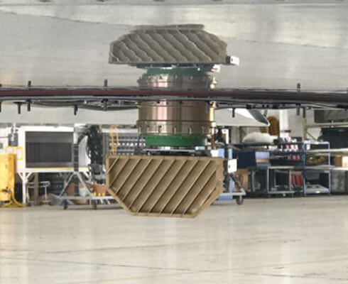

PAS antenna gimbal assembly on a shock and vibration test stand

PAS antenna and gimbal assembly on the undercarriage of an aircraft
