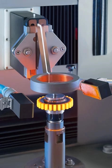

EMAG’s SDF technology hardens gears using induction in under one second. This is done right before rapid quenching and tempering, followed by hard turning and grinding, for in-house production. (Provided by EMAG)

For some automotive applications, there is no substitute for steel, and Moore pointed to new technology that makes common materials better. For example, he said EMAG’s patented simultaneous dual frequency (SDF) technology can be used to make softer steels like 5140 suitable for gears, and do so quickly. “Typically you’d start with a low-carbon steel, do the cutting and gear hobbing, send out a batch of parts to be carburized in a big furnace, and then bring them back for finish grinding,” Moore explained.
In EMAG’s new approach, users start with a common and easily machinable steel like 5140, perform the turning and hobbing operations normally, and then use SDF induction hardening right before hard turning and grinding, all in-house and in the same automated production line.
A PCI TS630V twin-spindle horizontal machines a cylinder head.(Provided by Absolute Machine Tools)
Besides the easier machining, this eliminates the hassle, cost, and delay of batching parts for outside carburization. Moore said SDF combines low and high frequencies at the same time, putting a lot of energy into the part quickly, so “cycle times are typically under a second and then quenching time is about seven seconds. Then we also temper in the machine. Tempering is the longest process, usually taking around 12 seconds.” And EMAG can also supply the grinding/hard turning machine, the gear hobbing machine (in partnership with either Koepfer or Richardon), and the linking automation.
