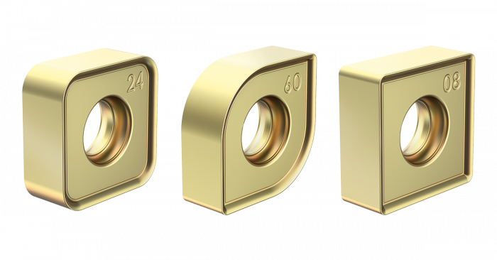

Edges per insert
If carbide was dirt cheap, there’d be no reason for articles like this one because everyone would simply use solid carbide tools, regardless of their size. Sadly, that’s not the case, which is why shops everywhere are looking for ways to reduce their tooling costs, and the best way to do that is to increase the number of edges per insert; where most styles of indexable helical milling cutters offer only four today, the HARVI Ultra 8X has eight cutting edges per insert. Effectively cutting the cost per edge in half. In addition, its inserts are available with a broad selection of corner radii, so that the cutting action can be fine-tuned according to where the insert sits in the holder—you might want to use 0.250 in. (6.4 mm) radius inserts on the end of the tool, for example, and ones with a 0.031 in. (0.8 mm) radius higher up in the cutter body.
The only one. HARVI Ultra 8X is the only indexable helical milling cutter platform that offers 8 cutting edges per insert.
Positive cutting action
I know what you’re thinking—it’s easy to create additional cutting edges when you use a double-sided insert, and as anyone who’s used one knows, double-sided has long meant a negative rake and therefore high cutting forces. Not anymore. Thanks to some cleverly designed cutter bodies and advanced carbide manufacturing techniques, it’s now possible to achieve free-cutting, positive rake geometries suitable for the materials that need them most—titanium and aerospace alloys that are high in nickel and chrome.
Better pockets
Lower cost per edge is meaningless if the insert shifts in the pocket during cutting, damaging the cutter body and quite possibly scrapping a very expensive workpiece. Fortunately, the same clever designs that make today’s indexable end mills freer cutting also make the inserts extremely secure. Just be sure to look for an equally secure locking mechanism, preferably one that uses M4 or larger Torx Plus screws for maximum clamping power.

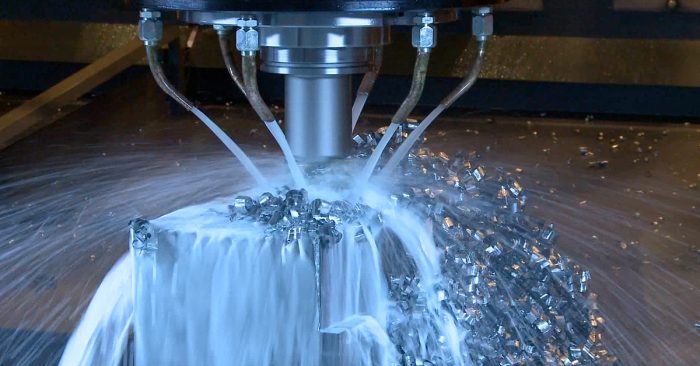

Keeping cool
This last attribute is more about machine tool technology than it is about cutter bodies or carbide. Through-the-tool cutting fluid—often applied at pressures of 1000 psi (80 bar) or greater—is changing the way shops make parts, and in response, the way that cutting tool manufacturers make cutting tools. Look for indexable tools with plenty of plumbing options, so that coolant can be directed where it’s needed most. No more hoses, no more chip-jammed gullets or the crunch, crunch, crunch of recutting, just a generous flow of cutting fluid, higher feedrates, and tool life that will pleasantly surprise you.

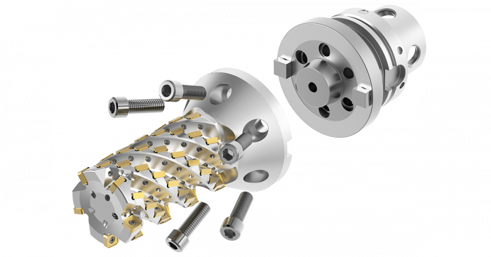

There’s more. A high-performance helical milling cutter should be made of high-strength steel for ultimate stiffness and rigidity. The gullets should be deep enough to efficiently evacuate chips without sacrificing body strength. It should have a spindle interface that compliments this construction, which in the case of the Industry Challenge mentioned earlier was the newly redesigned KM4X quick-change system. And the body mount must be equally rigid, preferably one with a bending moment greater than traditional shell mill type holders but with the versatility to connect to multiple spindle types.
Kennametal’s HARVI Ultra8X is available with a BTF 46 (Bolt Taper Flange) mounting interface that’s nearly as rigid as a one-piece construction, outperforming conventional shell mill mounts by far. With a KM4X connection more rigidity is being added, as well as higher bending moment.

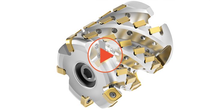

HARVI Ultra 8X performing a full slot cut in Titanium Ti6Al4V on a Cincinnati XT Profiler.
Add it all up and you’re looking at a 2 to 3-inch diameter helical end mill able to hog titanium and other difficult materials at 200 SFM or higher, using a 25 to 30-percent radial depth of cut and taking axial cuts up to 9 inches deep, depending on the size of the cutter, the workpiece, and the rigidity of the machine and setup. Best of all, these inserts in these cutters last longer than anything offered thus far. The cost per edge is lower, processes are more predictable, and more parts go out the door each day. If you machine large aerospace parts, mold cavities, or power and energy components, you owe it to yourself to take a look
