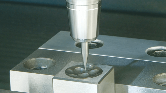

The Ultra Precision Type hydraulic chuck features runout accuracy of 1 µm at 4xD.
The recent additions to the Super Slim line come in two versions. The standard type is prebalanced for low-runout machining up to 60,000 rpm. The other version, called the Ultra Precision type, has all the features of the standard type but also offers super-high runout accuracy of 1 µm at four times tool diameter.
Tight runout control is “super-critical for very high-speed applications involving micro cutting tools,” Miller said. “For people looking for the best part quality, microns can make a difference.”
The latest Super Slim offerings can also clamp tool shank diameters down to 0.118″ (3 mm). According to Miller, accurately clamping such small shanks and holding on to them with sufficient force is a difficult task that requires extremely tight bore tolerancing and finely tuned actuation of the toolholder’s hydraulic system.

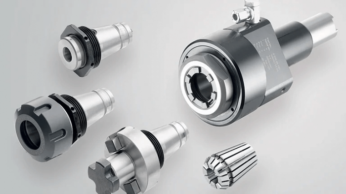

One of the biggest challenges shops confront is cutting difficult-to-machine materials. Novel toolholding technologies can help in this critical area as well. One such technology is the patented u-tec changing system from Platinum Tooling Technologies Inc., Prospect Heights, Illinois. Paired with the company’s Heimatec live tools for lathes, the u-tec system allows the use of various toolholding adapters for different applications.
“Most live tools on the market use ER collet chucks that only allow you to use ER collets,” noted Preben Hansen, president of Platinum Tooling. “But if you’re milling difficult materials like titanium and Inconel, an ER collet chuck doesn’t always hold end mills properly. So for our live tools, you can take out the collet and put in an adapter to grip an end mill so there’s no way it can pull out.”
Heimatec tools come with a patented u-tec changing system. The adapter comes in various styles to hold different types of tools.
The u-tec adapter has the shape of an ER collet, which fits into a toolholder. The adapter comes in various styles, including side lock, hydraulic, shrink fit and face mill. “A typical live tool would have an ER32 that holds a ¾” (19.05-mm) shank,” Hansen said. “But we can give [customers] an output with an arbor so they can have a 2″ (50.8-mm) face mill on the end of their tool.”
The Safe-Lock system includes drive keys in the chuck and grooves in the tool shank. In the past, the u-tec system was used primarily with low-speed, high-torque tools. Now, however, Platinum Tooling also builds the system into its spindle speed increasers that can boost live tool speeds up to 24,000 rpm.

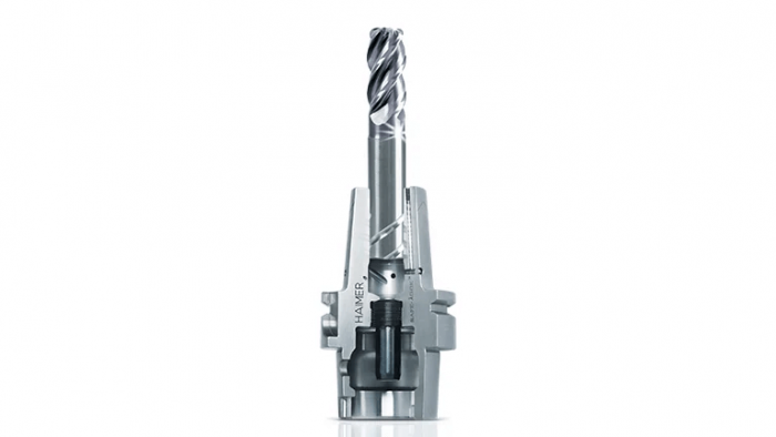

When cutting difficult-to-machine materials, high axial forces can cause micro-creeping movement that will pull a tool out of its chuck. Even frictional clamping methods capable of applying extremely high forces may not be able to prevent micro-creeping. As a result, high-quality workpieces can end up as scrap and shops are prevented from taking advantage of the maximum performance capabilities of machines and tools due to tool-pullout concerns.

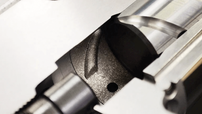

To address this situation, Haimer developed the patented Safe-Lock system, which adds the positive locking of a form fit to the frictional forces of a particular clamping system. To prevent milling cutters from pulling out of the chuck during machining, Safe-Lock features special drive keys in the chuck, as well as grooves in the tool shank that engage with the form on the inside of the chuck so a tool is pulled into the chuck as it rotates. About 20 different manufacturers are licensed to put the Safe-Lock groove on their cutting tools, according to Holden.
What about the conventional alternative for locking tools in place, the side-lock end mill holder? “As spindle speeds got higher, people became more aware that those things by nature are way out of balance,” Holden said. “The screw pushing against the flat on an end mill is pushing that tool off center and causing runout.” By contrast, he noted, the Safe-Lock form is 360° around the cutting tool, so no unbalance is built into the assembly.
Minimizing runout reduces tool wear. In addition, the pullout protection provided by Safe-Lock allows increased cutting depths and feeds, resulting in up to 100 percent higher metal removal rates, according to Haimer.
