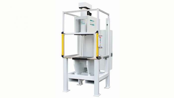

Break the light curtain on this Promess electric press and it will stop before injuring the operator. Advanced features allow for safe press movements even when the light curtain is broken.
Promess makes electro-mechanical presses and torque units that go into assembly, press fit, crimping, staking, and similar systems. For routine operation, its equipment’s safety functions meet Performance Level (PL) “PLd,” which has a probability of dangerous failure between 0.00001 and 0.0001 percent per hour (the second highest rating). Some of its maintenance safety functions are built to the “PLc” level (0.0001 to 0.0003 percent). Nausley added that the safety controls are often more sophisticated than simply “go/no go.” For example, the light curtain might allow an operator to approach a press as it’s retracting, because “it’s safe moving in that direction. But if the press changes direction and starts coming down it will E-stop if the operator is still in the light curtain.” This would allow an operator to load parts or perform other functions without shutting down operation while also not compromising safety.
A more complex example is the notion of allowing an inherently dangerous process to continue at a so-called “safe speed.” In this case, you’re counting on the operator (or more likely the maintenance technician) to be aware of and avoid the danger, owing to the slower speed. The system will not prevent injury if the human deliberately acts stupidly. The goal is to provide safety while also adding to productivity.

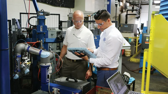

Juan Rodriguez, director of automation with Crum Manufacturing, a Universal Robots certified systems integrator (right) consults with Craig Sivak, executive vice president and general manager, T&W Stamping.
