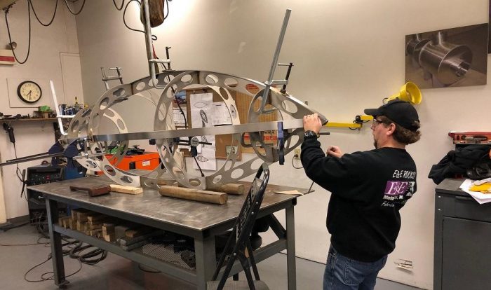

“The parts for the rocket were cut on a waterjet and then rolled to close tolerances,” he said. “We couldn’t allow any gaps from one section of the rocket to the next. It had to be close. The parts have stitch welds around the circumference, but between the welds, you can’t see any gaps.”
