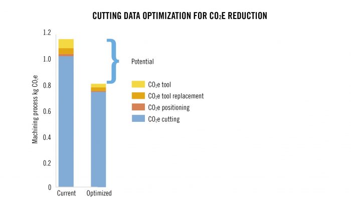

Seco and its R&D department are now developing data models which can be used to calculate customers’ carbon footprint in the user phase. The model takes the entire life cycle of a tool into account, including energy consumption and the use of coolant in the customers’ production processes. This in turn helps customers to optimize their processes and reduce their climate impact. “By making the right choices, using the correct cutting data and avoiding sub-optimizations when producing individual parts, customers are able to reduce their carbon footprint by at least 20%. The idea is to find the optimal way to produce a part by changing different parameters,” said Sören Hägglund, PhD and R&D Expert Cutting Data at Seco.
Bar chart showing the potential for reducing CO2 emissions in processing operations. The model includes the carbon footprints of the machine, tools, coolant and electricity consumption.
