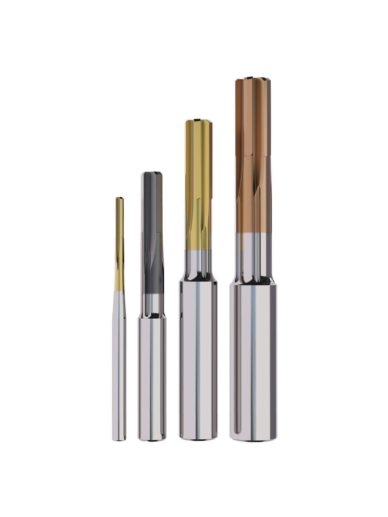

Seco Nanojet Solid Carbide Reamers enhance chip control with an innovative through-coolant outlet for optimal chip evacuation. This design eliminates costly scrapped parts, jamming and edge damage to increase safety, part quality and tool life.
Nanojet Reamers
Better coolant flow for better parts
Critical reaming operations require stable, secure, predictable tools. On blind and through bores, Seco Nanojet Solid Carbide Reamers extend the proven performance of Seco Nanofix products with innovative through-coolant outlets that stop chip jamming and enhance application stability. The unique design of these new tools delivers a powerful, precise stream of lubrication directly to the cut zone for optimal chip evacuation and tool life. Along with production stability, shops can rely on Seco Nanojet Solid Carbide Reamers to maintain cutting speeds as well as part quality.
This versatile range of multi-flute reamers comes in eight grades and more than 10 geometries, along with custom sizes and tolerances. The tools work with any precision toolholder. They hold tolerances from 10 µm – 15 µm (0.0004″- 0.0006″) and produce surface finishes from Ra 0.2 µm-Ra 1.2 µm (Ra 8 µ”-Ra 50 µ”). Seco inspects each Nanojet Solid Carbide Reamer and documents its measured diameter for consistent performance.
