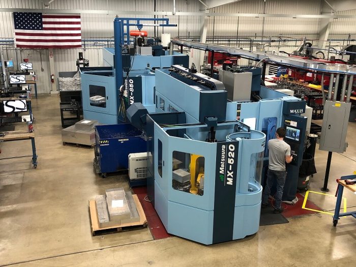

“The Yamazen sales team and engineers really helped us understand the impact the Matsuura 5-Axis MX-520 PC4 and MX-850 PC4 could have on our business,” Bowman commented. “Having multiple pallets and the ability to run unattended with great process reliability, a familiar Fanuc control, and that the machine’s provided repeatability of 0.000039” — that’s not even a real number to me,” said Bowman.
The Matsuura machines repeatability for each rotating axis A/C is +/-2 arcseconds. This is a very important specification when purchasing a 5-Axis machine. The larger the workpiece, the more important it is to have precision and repeatability in the rotational axes, as error is compounded as a function of distance from each rotating axis’ centerline.
New machine delivery day had come for Flying S. “Yamazen’s installation and service were fast and helpful. The training for CAMplete and machine functionality were topnotch, and that continues with phone and email support when needed, without any issues,” commented Bowman.
“We ran our standard Flying S accuracy test block on the MX-520 first, which includes multiple intersecting 5 axis bores. We had never seen such a good test cut!  It was near perfect!” said Bowman. “We were also immediately impressed with the spindle uptime we were able to achieve, and we began running 24-hour shifts within the first week of install.”

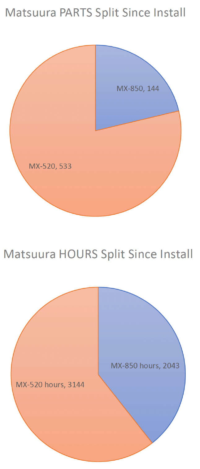

Spindle Time
533 parts were made on the MX-520 and 144 on the MX-850, making a total of 677 parts with an average batch size of 7.
Over this 6-month period, the two Matsuura machines ran a total of 5,187 hours, (3,144 hours on the MX-520 and 2,043 hours on the MX-850) with 2 machinists, roughly the same output as 4 of their current 5 axis machining centers, with 3 to 4 machinists within the same time frame.
The MX-520 maintained a 75% spindle uptime. The machines did not run on most Saturdays and Sundays due to limited pallet quantities. Factoring in 533 parts with an average batch size of 7, means 75 setups to First Part while still maintaining 75% spindle uptime. Flying S believes this really illustrates the ability for the Matsuura platform to handle ‘high-mix low-volume’ with the right planning and execution.

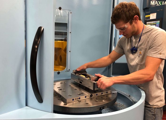

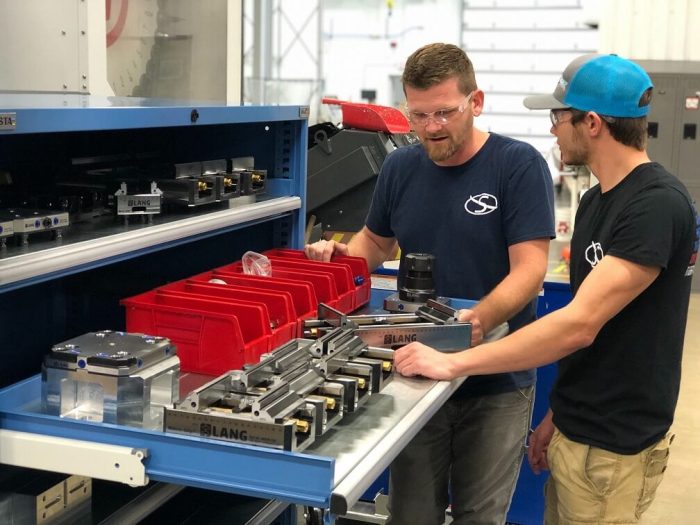

Matsuura Machines commonly have 2 or 3 different First Parts inspected at the same time, from the same machine. The Matsuura’s have additional tool changer capacity that worked well with Flying S’s tool libraries. They also found the use of zero-point workholding, combined with the accuracy of the pallet locating, made part probing unnecessary.
