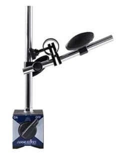

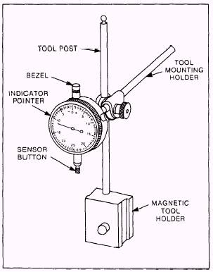

Standard Magnetic Indicator Base
Magnetic bases are the traditional option. This standard base is comprised of two “arms.” One of which is screwed directly into the magnetic base, the other attached to it in order to hold onto the dial indicator itself. There is a clamp that connects the two arms together and allows the user to change the position of the indicator along that base arm.

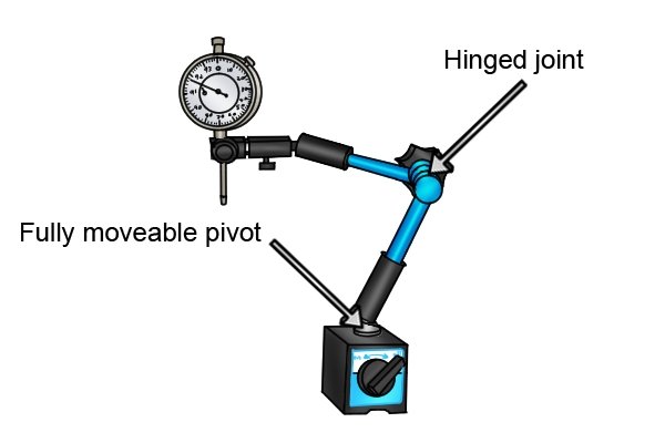

Hydraulic Magnetic Indicator Base
Hydraulic magnetic bases technically have a single arm connected to the magnetic base. The movement is enabled from a ball and joint that allows the arm to pivot. What makes this mechanism unique, is the knob between the joints that creates high hydraulic pressure to develop the arms rigidity and strength.

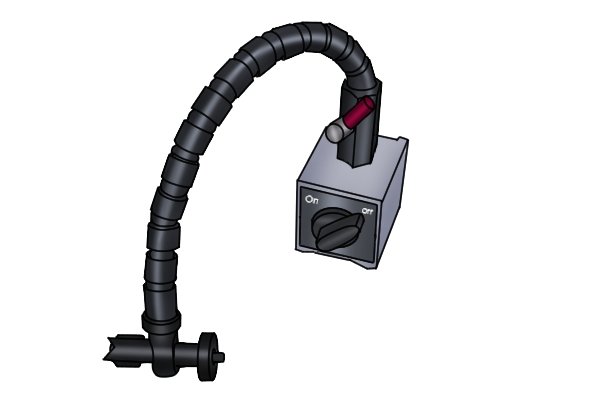

Flexible Arm or “Goose Neck” Magnetic Indicator Base
Flexible arm bases feature the same magnetic box that characterizes the standard bases we described above. Unlike standard models, however, this type of base only have one “arm”. This arm, aka the goose neck, is a tubular system comprised of joints that allows it to bend and move with extreme flexibility. These arms are the absolute best for applications with harder to reach areas that a standard base would have difficulty reaching.

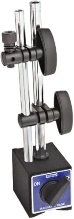

Fowler Full Warranty 52-585-005-0 Magnetic Base
The Fowler 52-585-005-0 Magnetic Base is available with both flat surfaces and a V-step structure specifically for round surfaces. With 85 lbs of pull, this indicator base can mount all AGD indicators as well as test indicators.
