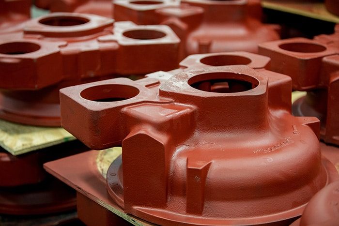

Magnum specializes in machining castings and does some bar-type work for a customer base ranging from heavy equipment to commercial HVAC manufacturers. Most cast parts are made from gray and ductile iron, steel, stainless steel, aluminum or brass, and each can weigh as little as ½ lb to 700 pounds (0.23- 317.5 kg). Machining cycle times can vary from 1½ minutes to upwards of six hours.

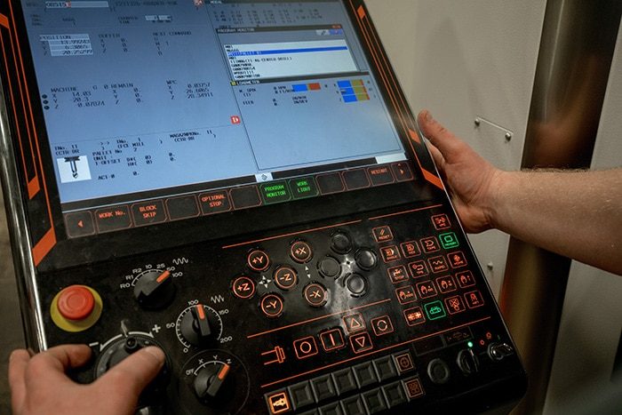

The MAZATROL SmoothG CNC control makes it easy to generate programs for processing complex parts through off-centerline machining as well as angled drilling, milling and tapping operations. It incorporates a variety of advanced programming functions that give Magnum ease of use and ensure high-speed, high-accuracy machining performance, according to the shop. Some of those functions include High Gain Feed Forward Control to boost machining speed and accuracy, Real Time Tuning to ensure optimal machining balance as workpiece weight changes, and Variable Acceleration Control to calculate optimal acceleration for a combination of axes.

Ergonomic features of the MAZATROL SmoothG control include a large 19” (482.6-mm) display that presents all of the critical machine data within a single-page view and a multi-touch screen that can store programming operations on an SD card and allows the CNC to store up to 32 GB of data.

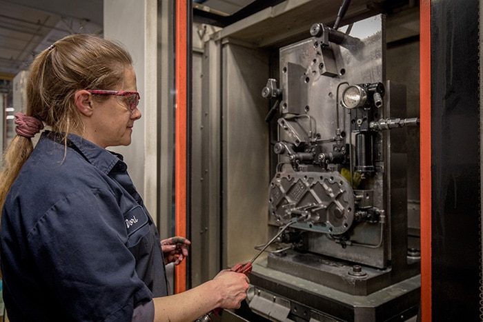

Dorene Nelson, CNC machinist, tends a machine at Magnum. The company’s HMCs allow virtually 100 percent machine spindle utilization, as integrated two-pallet changers are loaded and unloaded while machine spindles continue to work.
