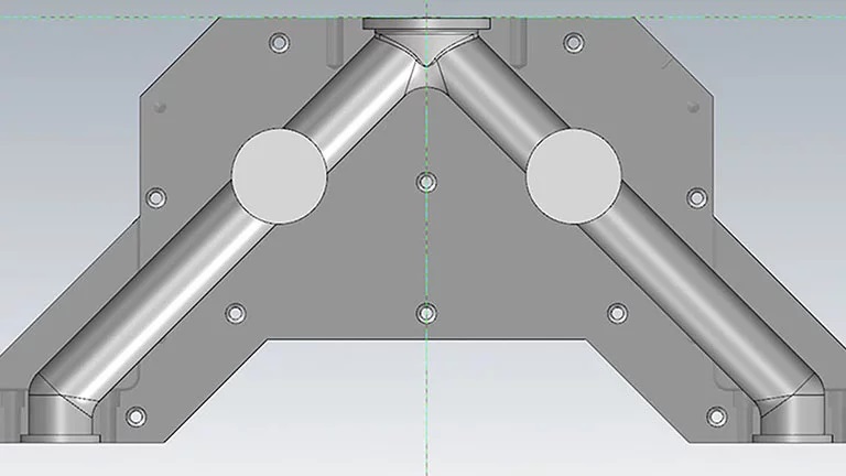

An oddly shaped plastic extrusion flow splitter for a large injection molding system started with a billet of 4140 PHT 28-32 Rc that was milled using a boring head. Mastercam’s Dynamic Offsets allow multiple faces to be cut with only one probed position.
“It was different compared to what we’re used to,” said Tony’s son, CNC Programmer Alex Johnson. “We used a five-axis multitasking machining center with a trunnion-style tilting table. Figuring out how to do it most efficiently, in terms of machining as many faces as possible per setup, wasn’t easy because moving that part around wasn’t easy,” he said. “The challenge was to get it set up in the machine, mounted, and then program as much as possible on each setup.”
The shop used Mastercam’s 3D Area Clearance for the roughing operations, starting with a billet of 4140 PHT 28-32 Rc. According to Tony Johnson, the splitter sends material in two directions. The flow part is milled with Area Clearance toolpaths and then a scallop finish process. Mastercam’s Dynamic Work Offsets allow multiple faces to be cut with only one probed position.

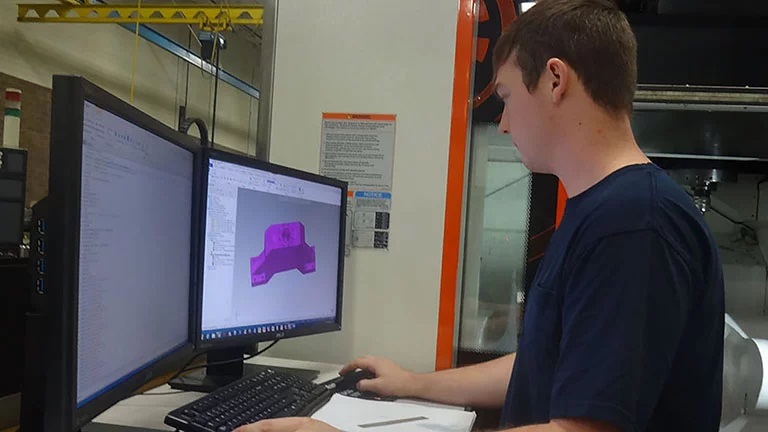

Alex Johnson relied heavily on the software’s Simulation features, Backplot and Verify, to retrace toolpaths to check for gouges, detect collisions and fixtures, and otherwise ensure that the programmed toolpaths would, indeed, work on the machine. The ability to open a separate Simulation window allowed Alex Johnson to make adjustments to the programs while they remained visible on another screen, saving valuable time.
