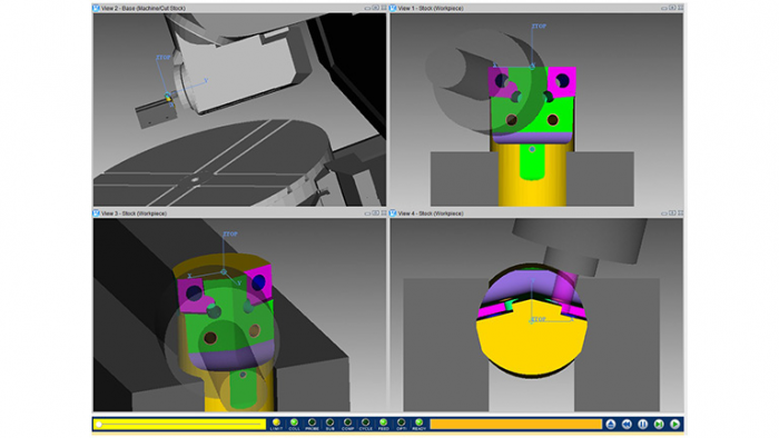

Screen image of VERICUT being used to simulate a five-axis machining operation.
Though MIC Group did have CGTech build 3D models of its five-axis machining centers about six years ago, most of the machines in VERICUT are “pretty generic,” he said. “We have such a variety of machine sizes and ages and types that the modeling efforts were pretty daunting, so we found it easier in most cases to just use a basic model that you can run the code against. There’s probably some room for improvement here, but it gives us the results we need—the ability to simulate post-processed code, check for collisions, and make sure we’re not going to scrap out an expensive chunk of material.”

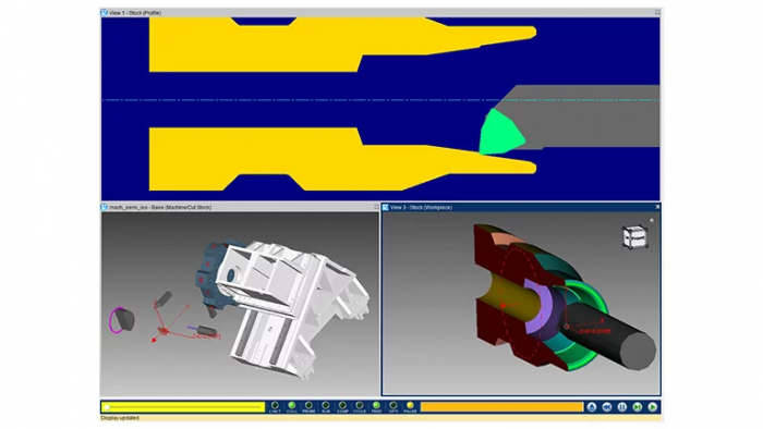

As for Vanek, he’s a VERICUT believer, using it for verification of his turning and three- to five-axis milling programs before they are released to the shop floor. Even though the majority of his programs are for two-axis lathe work—a scenario where tool interference is much less of a concern than, say, five-axis simultaneous machining or Swiss-style turning—he explained that “almost everything” still gets a trip through VERICUT before being released to the floor.

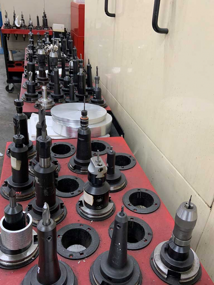

A typical selection of tooling used on one of MIC Group’s many machining centers.
