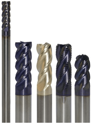

A sampling of the tools produced by TJ Grinding…mills, drills, reamers and burrs

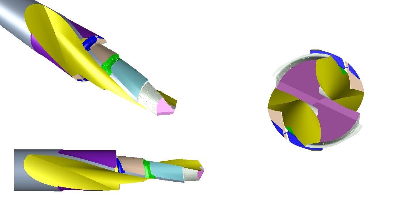

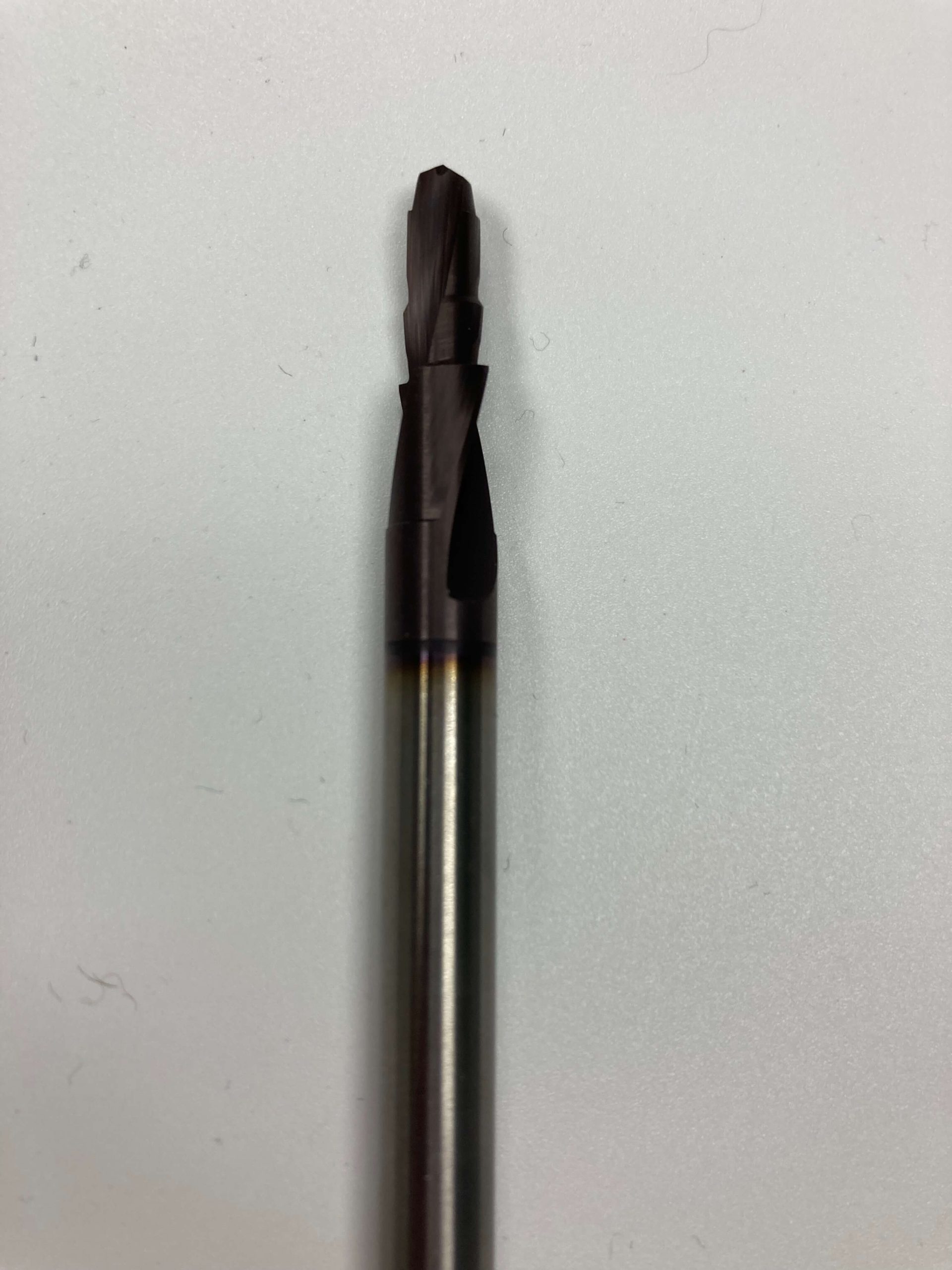

An example of a part made by TJ Grinding for 10 years now on ANCA machines, originally the RX7 and today the FX5 and FX7.  This coated carbide tool is used to machine a 1018 steel compressed gas bottle valve.  To date, according to Jason Winters, not a single leak has occurred in the customer’s high-volume production, over a ten-year span.  The tool, after coating on the gauge line, is holding a +/- 0.0003” tolerance consistently.  According to Winters, “Despite the length of the run and the changeover in machines, the ANCA combination of machine mechanics, software and CNC consistently hold the tolerances for us.  We have made and continue to make thousands of this tool, every year.”

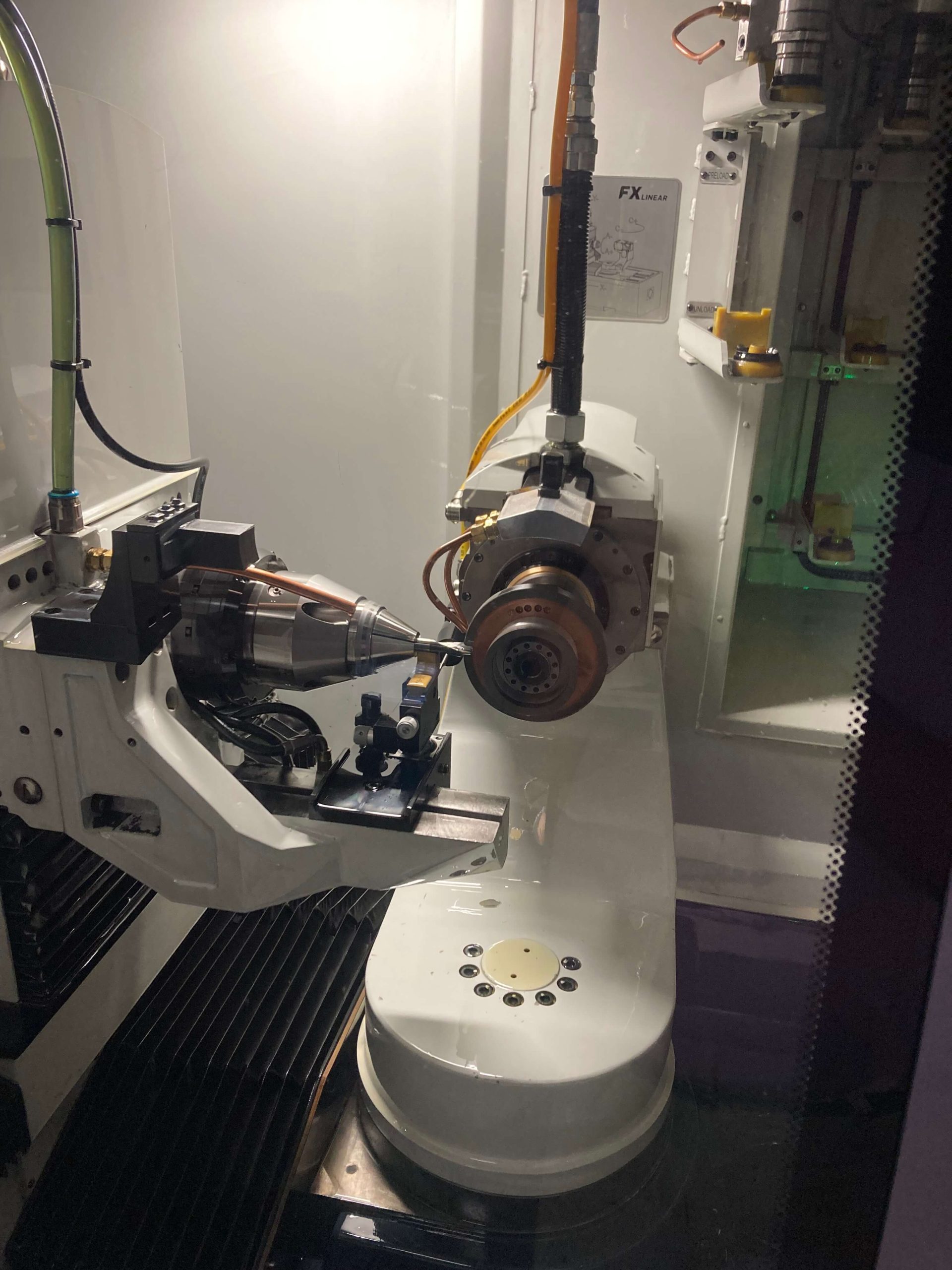

A tool being ground on an ANCA FX7 Linear machine at TJ Grinding in Waukesha, Wisconsin.
