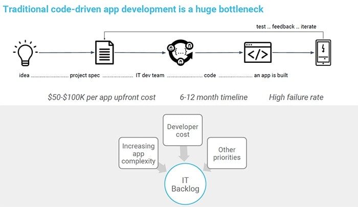

“This turns out to be the most important thing if you want to do truly agile and innovative app development: Get it in the hands of some users, get their feedback and produce an iteration,” said Praveen Seshadri, CEO of AppSheet, Seattle. “Truly, the number of iterations that you can do with quality feedback is what lets your app convert to something useful and successful for your users. The speed of iterations is what drives success.”
(Graphic provided by AppSheet)

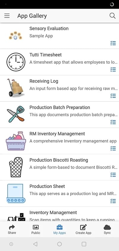

Elijah Magrane, operations director at Tutti Gourmet, a healthier snacks maker in Hudson, Quebec, Canada, started using AppSheet about 16 months ago for doing inventory.
The plant used to do inventory based on physical counts which were then entered manually into spreadsheets. Errors were common and some things were overlooked. With the platform, though, Magrane was able to create an inventory app that includes the kind of formulas and calculations common to spreadsheet programs and has since added bar and QR codes, so counts are automated.
“Implementing a barcode system through AppSheet, along with automated restock notices, have increased our efficiency and ensured that we are always capable of fulfilling orders and producing at capacity,” Magrane said.
The apps Magrane has created—about 40 in all—are handy for day-to-day operations like tabulating employees’ time, keeping lists of approved suppliers, completing inspection checklists, managing warehouse inventory, tracking product distribution, and more.
“To be frank, where I’m at right now I have a fully functioning ERP with AppSheet,” he said (see graphic on page 63).

Tutti Gourmet essentially has a fully functioning ERP system based on AppSheet apps. (Provided by AppSheet)
“Our accounting system does not have traceability for finished goods,” Magrane said. “Prior to AppSheet we were recording manually in Excel. This took an enormous amount of time and errors were high. Since using AppSheet, the traceability workflow has been cut in more than half and errors are nearly non-existent.”
