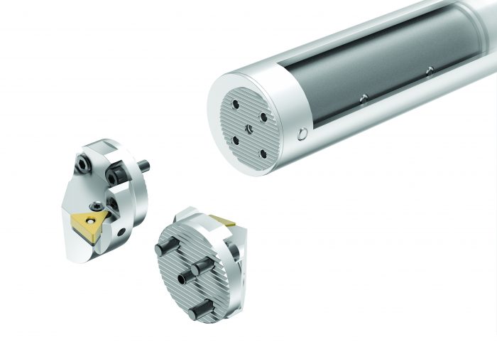

Kennametal, for example, recently released a new and improved version of its tunable boring bar, first patented in 1982. Perhaps the biggest difference between the new system and the old is that there’s no longer any need to tune the bar for different cutting conditions—thanks to a robust internal damping package, operators can just set it to the desired length, put the tip on center, and get to work.
Modular boring systems should be vibration-free, easy to use, and require little in the way of adjustments. Access to an assortment of boring heads reduces setup time and minimizes investment costs
A boring system like this offers many benefits aside from being vibration free (although chatter elimination is clearly its chief advantage). As already mentioned, length-to-diameter ratios of 10:1 are possible, outperforming steel and even carbide shank tools by a sizable margin. And because there’s no more worry about chatter, programmers and machinists are free to optimize their cutting parameters for maximum productivity, tool life, part quality, or all of the above.
Freedom to take heavier cuts or feed faster also solves the problem of chip control, and when chips are broken up into manageable lengths, they’re much easier to flush out of the hole. The vibration-free bar’s through-the-tool coolant capability and precision-placed orifice also helps, especially when used with a high-pressure coolant pump. No more chip jams, no more scrapped parts.
The nuts and bolts
A modular boring system is also more flexible compared to brazed and indexable bars. Point in case, Kennametal’s serrated, bolt-on coupling is not only extremely secure, but it accepts heads for 80-degree diamonds, Trigons, triangular-shaped and profiling inserts, and more (even back-boring).
Like the bar itself, the heads have also been redesigned for reduced weight and shorter length, further enhancing the anti-vibration effect while increasing stability and repeatability. But if your shop is already using one of Kennametal’s bars, don’t worry—your legacy heads will fit with an adaptor.

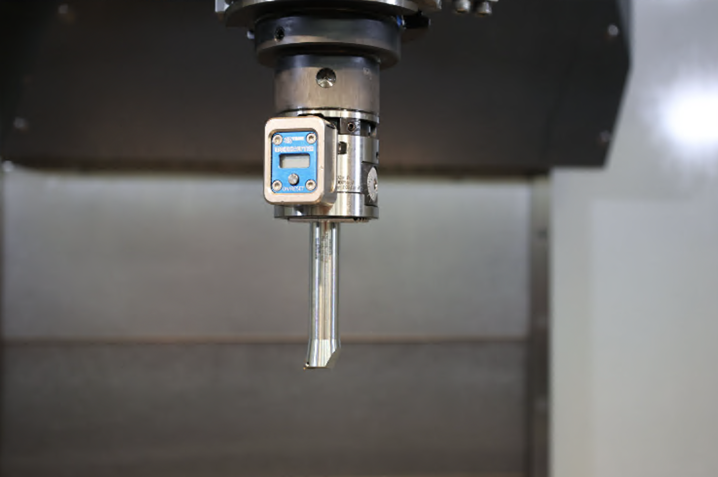

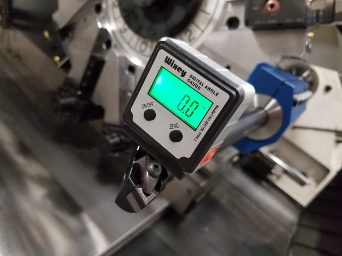

Right on center
Achieving the exact centerline with a boring bar can be challenging without a digital angle gage such as the one shown here
As any machinist knows, getting the bar on center is also important, although this is sometimes difficult to achieve. Kennametal’s made it a little easier by placing a reference flat on the top of the vibration-free bar—by setting a Wixey (or equivalent) digital angle gauge on this flat, it’s easy to get the cutting tip exactly where it needs to be. Forget about bluing up the end of the part and scribing a mark with the tool tip.
