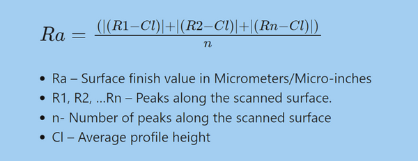

Ra, called roughness average, is the most commonly used unit. According to ASME B46.1, Ra is the arithmetic average of the absolute values of the profile height deviations from the centerline, recorded within the evaluation length. It is calculated by the formula:
[Formula 1 (ra)]
* The parameters refer to image #1

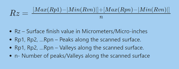

Rz, called the “Peak to Valley” average, is the second most commonly used unit. Rz is calculated by measuring the vertical distance from the highest peak to the lowest valley within the scanned profile. The highest five peaks and the five deepest valleys are taken, and then averaging these distances. Rz will always yield a higher value than Ra. It is calculated by the formula:

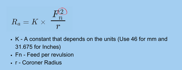

[Formula 3 (surface finish)]
By examining the formula, we can draw three important conclusions:
1.Decreasing the feed improves the surface finish.
2.Increasing the corner radius improves the surface finish.
3.Since the radius is squared in the formula, it is the more significant parameter to “play” with.
You can experiment with this equation using the Surface Finish Calculator.

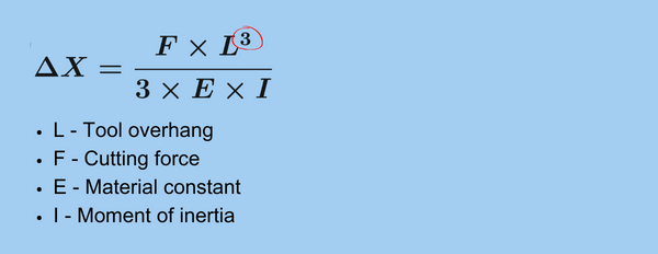

3.When using external and internal tools, setting them up with the shortest possible overhang is critical. According to the bar deflection formula, the deflection is directly proportional to the overhang cubed. Therefore, even a minor reduction in overhang can significantly impact the system’s flexibility.
[Formula 4 – (Deflection)]
