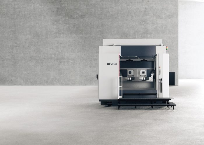

New machines allow for larger workpiece dimensions
“Despite the many advantages of our machines, there is also a certain disadvantage that comes with the swivel unit regarding the maximum dimensions of machinable components,” says J. Schmauder. Over the years, SW has had several customers request the ability to machine larger components on SW machines. This led to the development of the first machine prototype in the BA W08 series, the BA W08-11, which was developed for machining aluminum workpieces. Several of these machines have already been sold to customers. The use of linear direct drives allows this machine to have an acceleration of 2 g in the linear axes. It has a 35 kW spindle with up to 17,000 rpm at 80 Nm and HSK-A63 interface. HSK-A80 and HSK-A100 spindles are also available. In contrast to the previous machine concept, the swivel carrier and the second work table have been omitted. This solution enables the machining of larger workpieces. The prototype of the BA W08-11 has a working range of 1,500 mm (X), 1,025 mm (Y) and 660 mm (Z). The interference zone of the A-axis has a diameter of 1,650 mm and a length of 1,830 mm. A space version is also available for the BA W08-11, which offers more flexibility for the machining of large workpieces. This model features a larger interference zone diameter of 1,850 mm and length of 1,980 mm on the A-axis. SW has also developed the BA W08-21, a twin-spindle sister model that enables machining of two workpieces at the same time. In this machine, travel of the spindles is 800 mm (X), 1,025 mm (Y) and 660 mm (Z). These specifications apply to the HSK-A63 and HSK-A80 interfaces. In addition to single-table machines with linear direct drives for the machining of non-magnetic materials, SW is also developing single-table machines with proven ball screw drives for the machining of conventional iron, steel, or nickel-based materials.

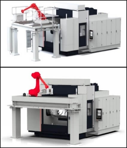

This naturally also applies to the new models in the BA W08 series, which can be automated with a variety of solutions. One solution to facilitate the loading and unloading of large and heavy workpieces for the operator at the machine is the integration of the TopRob. The machine is loaded and unloaded with the aid of robots on platforms or gantries above the machine. Multiple grippers enable the rapid exchange of finished and raw parts. Another option is to load and unload the machines from the front with an SW FloorRob.
In addition to machining, SW’s automation capabilities also extend to numerous other processes that take place in modern production lines. These processes include cleaning, drying and preservation, assembly and testing, and packaging for transport. SW’s automation team integrates third-party processes into the production lines and assumes overall responsibility for them. Depending on the overall circumstances of the production line, SW automation solutions also enable lights-out machining.
