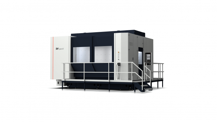

The demands of the EV industry are not in the same as the needs of traditional gas-vehicle production. Machining large structural components made of light metal such as battery trays is one of the biggest EV manufacturing challenges. This type of machining can be complicated and time consuming – two things that can hold manufacturers back from meeting increasing production goals. Machine, automation and system solutions supplier, SW, recently released the BA space3 specifically for machining in the electric vehicle industry that meets these needs today and into the future.
The BA space3 is differentiated in equal parts by its size and speed. With an installation of footprint of 25.3m2, the machine is the largest in SW’s repertoire. It features a working rage of 3,000 x 1,800 x 875 mm on the X-, Y- and Z-axes respectively. On each of these axes, the HSK 63 spindle is able to reach a rapid traverse of 120 m/min, with a chip-to-chip time of 4-4.25s (depending on which optional features a customer selects). So not only is the machine capable of machining large structural components made of light metal material, such as battery trays, that are in such high demand in the industry – but it does so at speeds much faster than anything offered by the competition. The remarkable speed is due in large part to the linear drives in all feed axes. The resulting high dynamism and positioning accuracy reduces idle time and ups productivity—both of which are indispensable when it comes to meeting such high demand for high-volume and bulky components.
The BA space3 can accommodate battery trays and other large structural components
Flexibility
Further setting the BA space3 ahead is its flexibility. SW designed a swivel head specifically for the five-axis version of the machine (two axes — the A- and C-axes — are in the head itself). This enables machining from all angles while cutting down on the need to purchase further rotary tables. The other variant features an HSK63 spindle, enabling straightforward correction in all axes, thus increasing quality.
The Q-axis contributes greatly to the dynamism of the 3-axis, rigid spindle variant. It can be turned for greater access to the workpiece. The Q-axis interference circle is Ø2,200mm x 3,480mm. The distance to the rotary table is 425-1,3000mm for the rigid spindle variant, and 165-1,040 mm for the swivel head.  In both variants, the table can accommodate more than just large parts. It is flexible and precise enough to machine subparts to be mounted together and brought to back to the machine to be processed into main part as a whole. After the machining process is finished, parts are rinsed out with coolant in the loading area. So, when all is said and done, what customers are left with is a completely finished component, ready to be packaged for shipping.
The tool magazine has been designed as a chain and can hold 40-80 tools including special tools in unique shapes and sizes.
Automation
Demand for EV parts is increasing rapidly and will continue to do so moving forward. Automation that simplifies the machining processes while supporting traceability is important for success. The BA space3 can be interfaced with automation from SW, which is also world renowned for their automation solutions. Loading is possible via robot or other lifting aid such as a crane. Robot loading is enabled with either a portal solution in front of and above the machine or a floor solution. The machine is accessible either through the open top or the automatic L-shaped door. There is a drip tray to enable clean workpiece transport. Manual loading is possible from the front; however, it is limited by the size and weight of the component being loaded.
