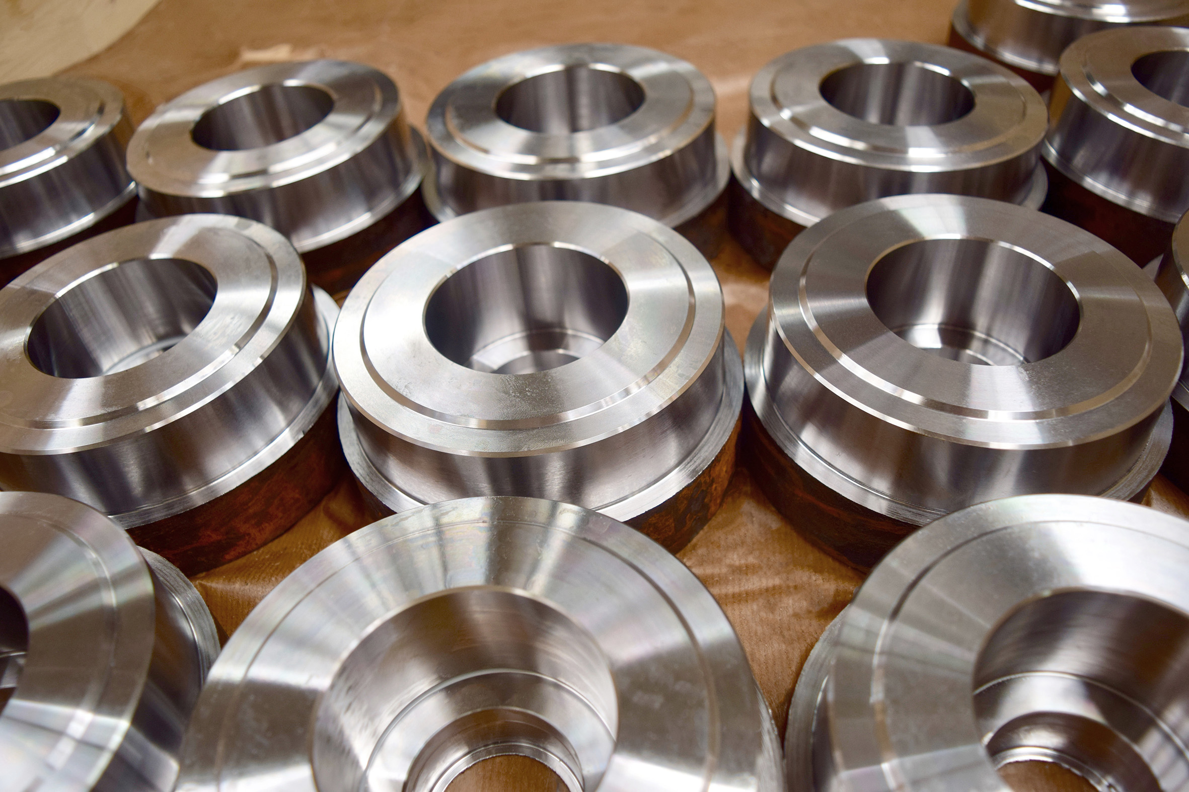

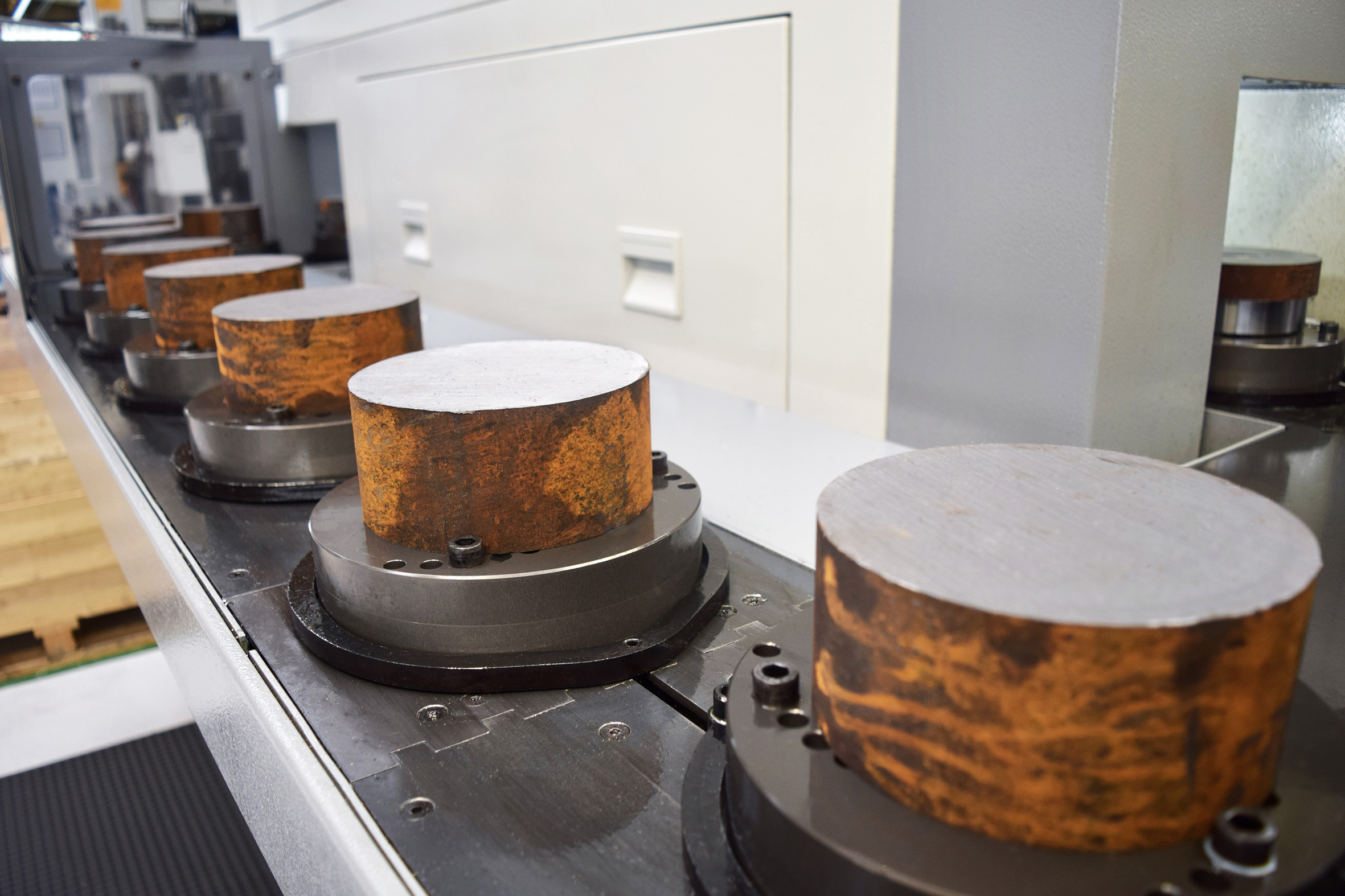

The specialists have recently invested in several machines from EMAG: Three of them are installed at the two subsidiaries in Romania and in the Czech Republic. A fourth machine is located at the main location in Kradolf, Switzerland, about 20 kilometers from St. Gallen. The fact that this is a VL 4 pick-up turning center may surprise industry experts. After all, this machine is more often used to process large batch sizes. In contrast, at Humbel, the VL 4 is used to soft machine only about 50 to 200 flange components, before the next component change. Why did Humbel decide to invest in this machine? “We have already been using EMAG technology for quite some time,” says the Managing Director. “Above all, it is the integrated pick-up automation system that convinced us. This approach enables us to increase our productivity even with smaller unit volumes. At the end of the day, once the machine has been configured, the overall process requires little manpower and still runs reliably. Moreover, the EMAG automation solution is designed in as simple a manner as possible. Many alternative automation concepts from other suppliers seem more complicated to us than the EMAG solution and therefore also too fault-prone.”
- The components are fed in and out via a conveyor belt
- The VL 4 performs various turning and drilling processes on very different components.

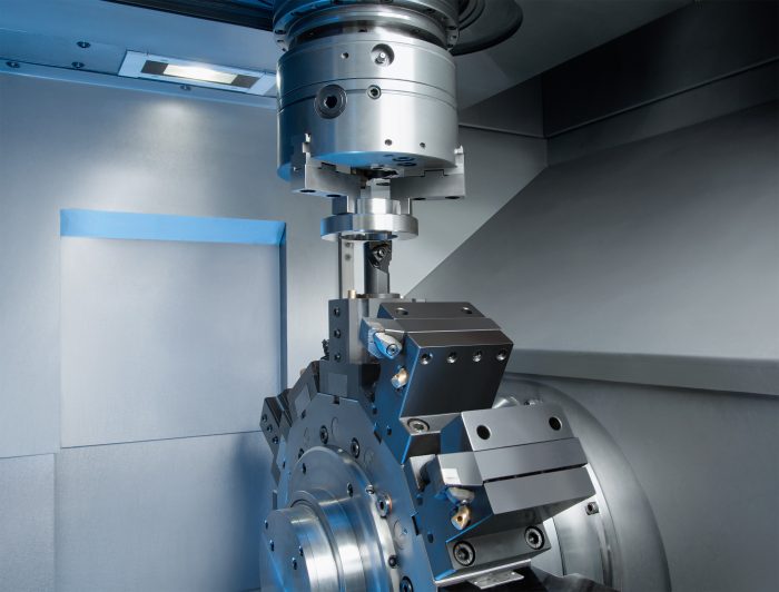

The required component quality also played a part in the investment decision, because the turning center must establish an ideal basis in the main machining operation for all subsequent processes. “If we obtain a high quality at this stage, it is easier to design the subsequent grinding processes and thus to guarantee perfect results,” says Pascal Wanner, responsible for implementing the technology in EMAG machines at the Humbel Group. “We are able to guarantee this initial quality in the process with the VL 4.” Furthermore, it is interesting to note that Humbel frequently is facing material challenges. For example, the motor sport components are manufactured from high-alloy case-hardened steels, which are relatively difficult to machine. In this and similar contexts, the specialists benefit from the machine’s additional configuration details. For instance, the machine base made from Mineralit® polymer concrete reduces vibrations during the milling process and thus ensures longer tool lives. Additionally, the main spindle is fastened to the front of the machine with a compound slide rest and enables dynamic movement in the X and Z-axes. The 12-post tool turret is also suited for driven tools and features very short indexing times. “The machine’s stability and performance surprised us. Our infeeds and feed rates are actually higher than we expected,” comments Pascal Wanner.
The VL 4 is designed for components of up to 200 mm in diameter and includes an integrated pick-up automation system. The 12-post tool turret is also suited for driven tools and features very short indexing times.
