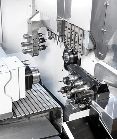

Absolute Machine Tools’ eight-axis Nexturn PYII series has a second Y axis, up to eight sub-spindle tools, and a maximum of 27 tools in total. Additional tooling options allow more live tools to be used on both the main and sub spindles for complex and intricate part geometries. (Provided by Absolute Machine Tools)
There is a catch. With these awesome capabilities comes complexity. Each of the slides, spindles, and cutting tools just mentioned must be programmed separately, then synchronized using special G-codes. To avoid damaging the workpiece and machine, there must be perfect alignment of the main and sub-spindle during part transfer. The compact work zone that helps give Swiss machining its short cycle times can make tool changes a bit troublesome, with operators using tiny wrenches to turn tiny screws while reaching past, around, and under other cutting tools. Worse, all those tools in tight quarters tend to catch long, stringy chips, which, if left unattended, can spell disaster.

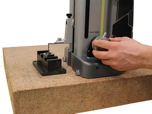

Offline measurement of cutting tools does not require any special equipment, as shown in this example using a presetting block from National Machine Products. (Provided by Tsugami/REM Sales)
This eliminates the need for individual plastic or copper coolant lines that are easily snagged by passing chips, he said, or that the machine operator inadvertently knocks out of position when changing a cutting tool, possibly with catastrophic results. “The main advantage of the plate is interchangeability. It allows an operator to index or change tools quickly and accurately, a task that can be difficult on most Swiss machines due to the close quarters. Between that and the fact that you don’t have to worry about the coolant lines, it’s a big time saver.”

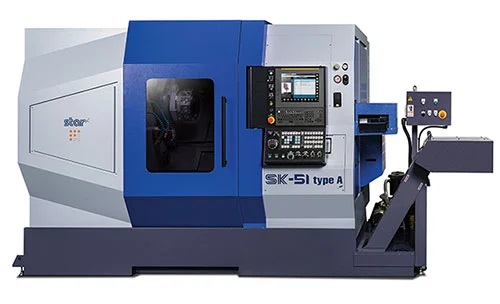

Star CNC Machine Tool Corp., Roslyn Heights, N.Y., is another machine builder with an extensive lineup of Swiss-style lathes and proprietary technology. Yet it’s the company’s new fixed headstock machine that has National Sales Manager Ed Garber most excited. That’s because the SK51—a mill-turn lathe with twin-turrets, twin-spindles, and 51-mm bar capacity—boasts FANUC’s iHMI (intelligent human machine interface) control, which Garber suggests changes the playing field in terms of operator usability.
“The turrets on the SK51 have identical X, Y, and Z travels and can each carry up to 32 tools, so there’s a lot going on here,” he said. “Because of this, we needed a control with excellent simulation capabilities, one that can display the tools, milling attachments, and workpiece in 3D and identify any potential interference before the operator pushes cycle start.”
The SK-51 type A CNC Swiss automatic lathe from Star comes with FANUC’s iHMI control, offering ease of use and advanced graphics. (Provided by Star)
As with the other machine suppliers interviewed for this article, Star wanted a control that’s powerful yet easy to use. The iHMI meets both requirements, with cycle time estimation capabilities, graphical tool libraries, maintenance reminders, and machine troubleshooting functions, including visibility to servo and spindle operating values. “We’ve also made it simpler to touch off tools, and have several other features that help shorten both setup and cycle times,” said Garber.
