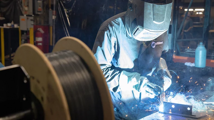

Webster Industries converted from solid wire to Hobart FabCOR 86R metal-cored wire in its robotic, fixed automation and semi-automatic welding operations, a change that allowed Webster to boost efficiency, reduce costs and improve customer lead times.

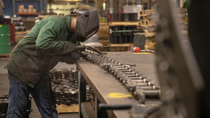

The company made the switch and started using the metal-cored wire in its welded steel drag chain manufacturing processes. The chains are designed for drag conveyors in rugged and demanding environments. A unique two-piece welded barrel offers better scraping action as well as double thickness at the wear points. Also, the rugged welded construction permits high speeds, minimal lubrication and easy modification for application-specific attachments.
With the switch to metal-cored wire, Webster Industries saw efficiency increase by 18-20 percent in its welding operations.

With the switch to FabCOR 86R wire, Webster Industries saw efficiency increase by 18-20 percent in its welding operations. These productivity gains were due to many factors: faster deposition rates and travel speeds, reduced rework and less time spent on post-weld cleaning due to less spatter generated.

The company’s welders like that the metal-cored wire burns more cleanly and can easily burn through oil, mill scale or dirt on the base material. This helps reduce the amount of time they have to spend cleaning the material before welding and cleaning off spatter after the weld. “I’m not spending 15 minutes for every part cleaning the spatter off before we send it on to the next operation,” said welder Tyler Crapo.
The higher deposition rate and lower wire speed means welders can use less wire for the same wire size and are able to weld faster. “I have noticed a lot of productivity improvements, whether it’s using less wire so my drum lasts longer or that we can run faster because it burns hotter and gets better penetration for less welding,” Crapo said.

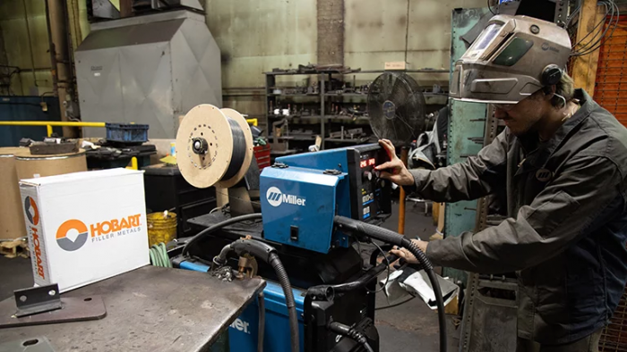

In addition to converting from solid wire to metal-cored wire, Webster Industries also invested in a new welding system that has delivered more ease of use and versatility in welding processes.
The Deltaweld 350 MIG welder with Intellx Pro feeder from Miller allows Webster’s welding operators to easily switch between regular MIG and pulsed MIG welding. The company uses the machine for fill-in welds and semi-automatic welding to tack parts and weld complex parts by hand.
The system’s pulsed MIG welding capabilities deliver cleaner welds, greater deposition rates and faster travel speeds compared to conventional MIG. The system also allows operators to preprogram gas, wire and speed settings for different applications, so they can easily pull up those settings when they switch between jobs.
“It just gives you so many options, being able to run different weld schedules during the same job,” said Crapo. “It lays cleaner beads and runs smoother.”

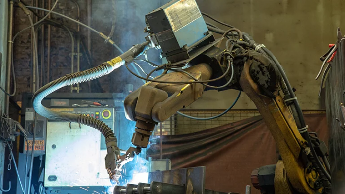

Webster Industries also uses Miller Auto-Continuum power sources with Insight Welding Intelligence technology in its automated welding applications. It can gather data such as uptime, throughput and arc-on time to help make improvements. “The Insight Core software helps us increase our efficiencies by being able to see the productivity of each machine,” said Secoy. “Then we can address individual problems or troubleshoot from there.”
The Deltaweld 350 MIG welder from Miller Electric allows Webster’s welding operators to easily switch between regular MIG and pulsed MIG welding.
