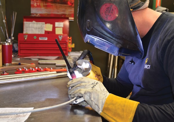

The jobs that come through require TIG work that is anything but ordinary. Some of the more challenging welds are within the parameters of a strand of human hair.
Part of the work culture that each of the three enjoy is the collaboration that occurs with each new project and prototype. This is when their unique backgrounds and skill sets come in handy.
It makes sense. Many of the parts they work on are brand new, Hammer explained. There’s no instruction manual, but welds must conform to certain specifications.
“Sometimes we get told that we need to conform to a certain specification, and then we have to figure out how to get everything to that specification while conforming to the demands of the part configuration and base material. We do that extremely well. It takes us a little bit, but we figure out ways around working with the metal and being able to conform to specifications,” Hammer said.
The end result must be correct. If anything goes wrong, they must start over given how small some of the components are.
“It’s not easy to fix something where your tolerances are a couple of times bigger than a human hair. The end result is to get it right, and sometimes it takes all three of us working together to make one piece,” Thessen said.

A majority of the time, Thessen, Hammer, and Coolong weld on stainless steel. While not necessarily considered an exotic metal, stainless does have its nuances.
The whole purpose of making things out of stainless steel is to provide desirable corrosion resistance properties. But if you’re not careful, those properties can be undone.
“The welding process, if done incorrectly, will corrode the stainless. You can’t just weld on stainless and expect it to remain stainless. You have to weld stainless in an exact manner and in a precise way for it to remain stainless when you’re done. Specific prep work and specific postcleaning is required too,” Thessen explained.
“When you’re welding you have to account for the fact that it’s going to distort; it’s going to pull a lot in the direction that you’re welding. With tube, it’s not that big of a deal because it tends to even itself out when you travel around, but it will shrink. You have to account for that shrinkage, especially where we deal with 0.03 tolerances. We have to be really careful with how much heat we put into our welds,” Hammer said.
Dialing in the right pressure based on the different tube diameters can be a challenge. They must purge the inside of a tube during autonomous welding, and the amount of back pressure they have determines the bead profile. Too much pressure will yield a bead that is puffy or convex, but not enough back pressure produces a concave or sunken-in weld. They don’t want either.
They must weld stainless in an exact manner and in a precise way for it to remain stainless. That includes performing specific prep work and postcleaning.

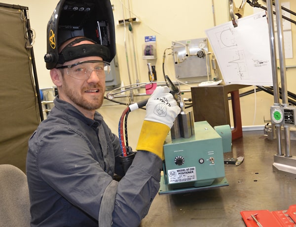

Education, experience, and trust are vital in the work that Thessen, Hammer, and Coolong do because it’s not your ordinary TIG work. Some of the more challenging welds are 0.005 in., or within the parameters of a strand of human hair, Thessen explained.
“These are some of the smallest applications that can be achieved by a human, and they can be achieved only by a seasoned journeyman,” Thessen said.
One of the biggest challenges with TIG welding, he added, is maintaining uniform root and cover passes to achieve the required tolerances.
