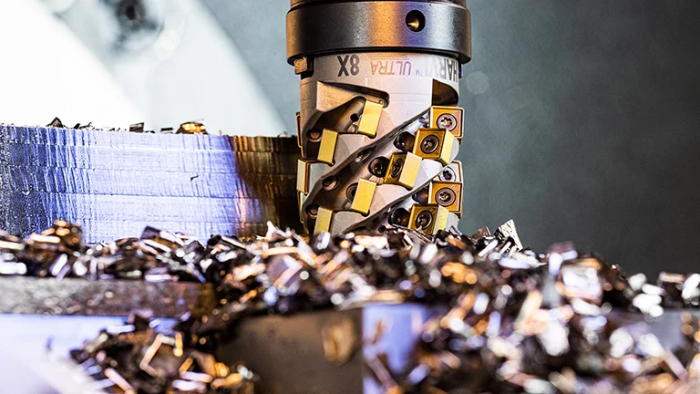

Kennametal’s HARVI Ultra 8X helical milling cutters deliver high metal removal rates, especially in high-temperature alloys, and are ideal for machining structural airframe parts.

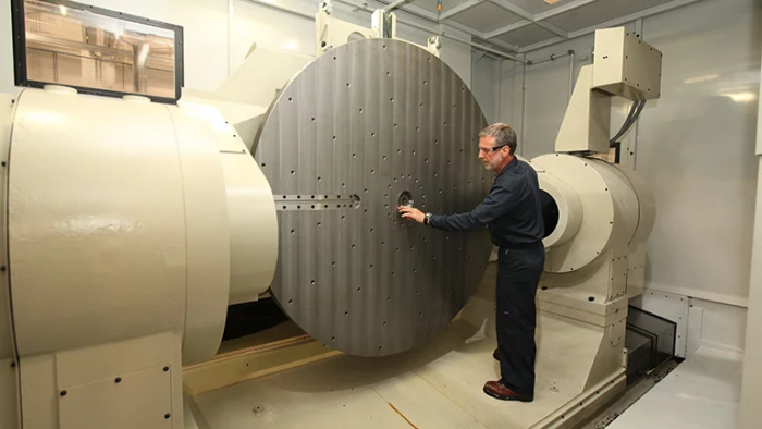

Mitsui Seiki’s Wayne Wentworth stands in the work area of a five-axis Mitsui Seiki trunnion machining center. The table was custom engineered to accommodate a 78″ (198-cm) diameter part.

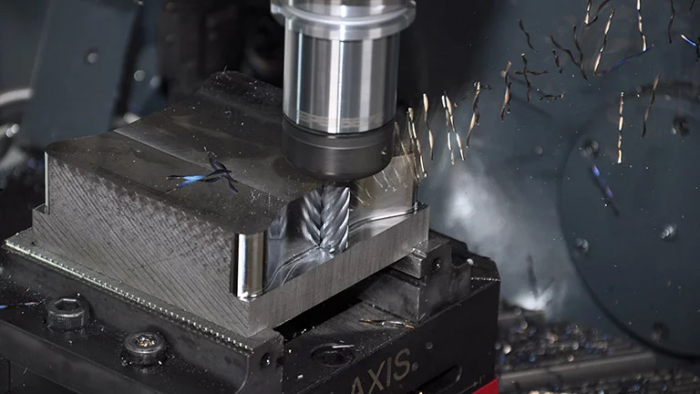

Tooling for cutting stainless steel must resist high heat, excessive cutting edge buildup and wear. Additives like sulfur can improve machinability “but cannot eliminate the challenges completely,” cautioned Hurco’s Cope. “These additives aren’t allowed in some of the tougher grades of stainless to machine, such as 304 and 316.”
Tools with more cutting flutes of course allow higher feed rates and more metal removal. “However, chip evacuation is also an important consideration,” Cope added. “Traditionally, we see five- to seven-flute cutters for roughing, and a much higher number of flutes for finishing. These are often solid-carbide cutters, but there are many suitable selections of inserted cutters.”

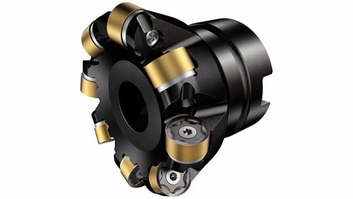

The Sandvik Coromant M612 is a face milling cutter developed to machine stainless steel turbo exhaust housings. The positive geometry and edge-line quality ensure reliable performance and an increased number of components per insert, according to the company.

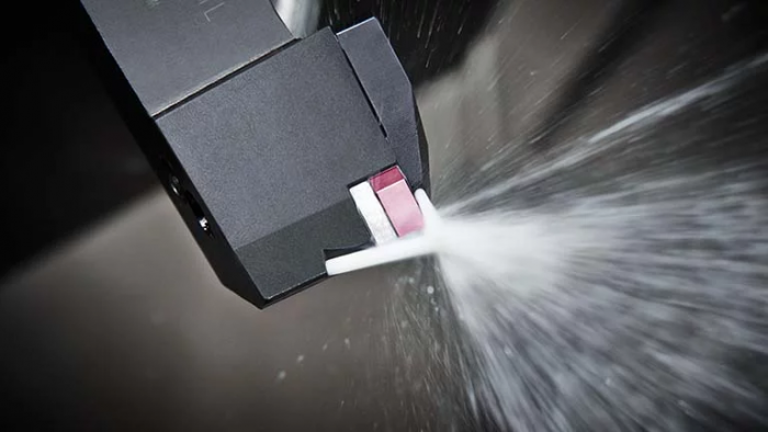

Seco’s Jetstream Tooling controls heat and manages chips, preventing hazardous production-stalling tangles while doing away with the hoses and connectors generally required for coolant-through tooling.

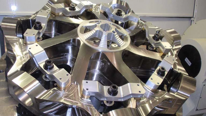

Prismatic workpieces such as this helicopter rotor hub are typical work for Mitsui Seiki’s large five-axis machining centers.
