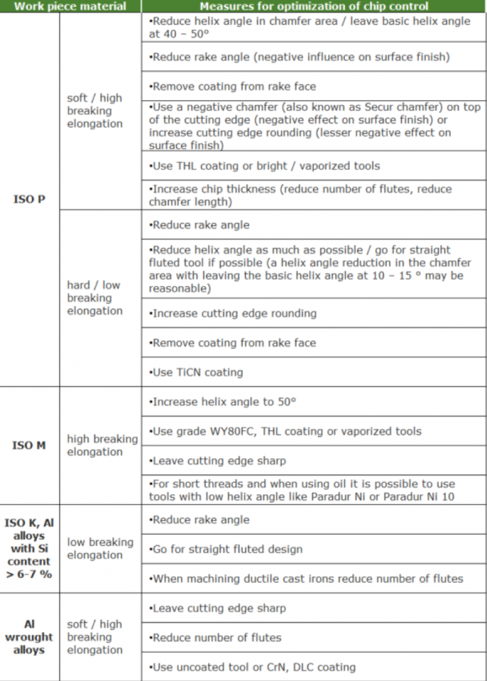

The following infographic identifies some of the tool properties required to control chips in a variety of different workpiece materials.
Chip control
Modifications to make the tool specific to the workpiece have to be implemented
